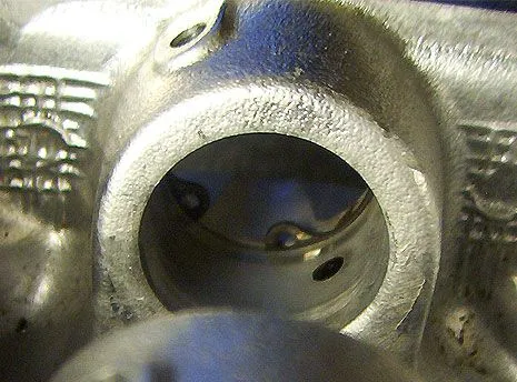

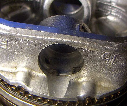

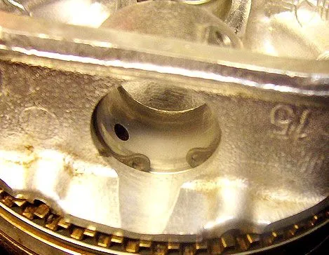

Well, All I have to say is, be sure to find a good machine shop. If the pins have some play in the piston, it will eventually fail on the long run.
I have pics of one of the pistons and the issue with pin clearance.

here are the pics of the stock piston w/ the job done for a full floating.
