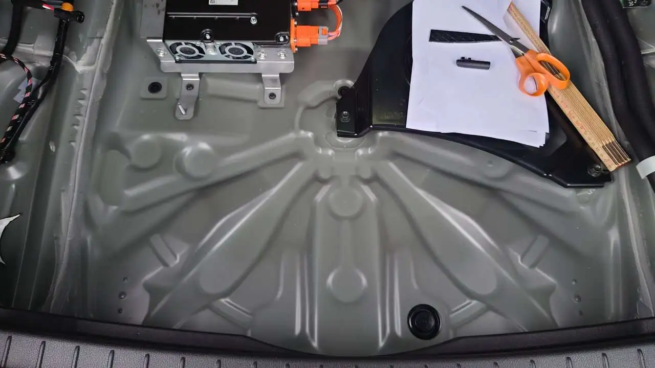

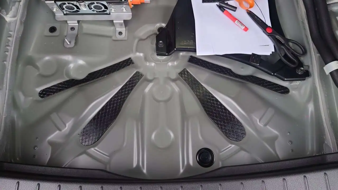

Small tip to remove resonance (barrel sound) from the trunk, remove the foam and subwoofer, and hit the bottom of the car with your knuckles, it sounds like an empty oil drum, the solution is self-adhesive bitumen, the sound from the sub becomes much better, and other noise from wheels etc disappears.

Was there a specific reason for just doing those small parts or did you do more after the photo?

After searching a bit, I found the undamped base plate, it played together with subwoofer at deep bass tones, according to the picture, I only put dampers in the 4 round points in the middle and left of the picture, muffled wheel noise is an added bonus, I didn't do it all the way through the bottom as the foam board comes up too high as it sits on the high areas, mine dampers do the job perfectly so i have no need for more.

I'm definitely all for reducing some of that wheel roar, the sub increase will be a welcome addition, thanks for the advice!
