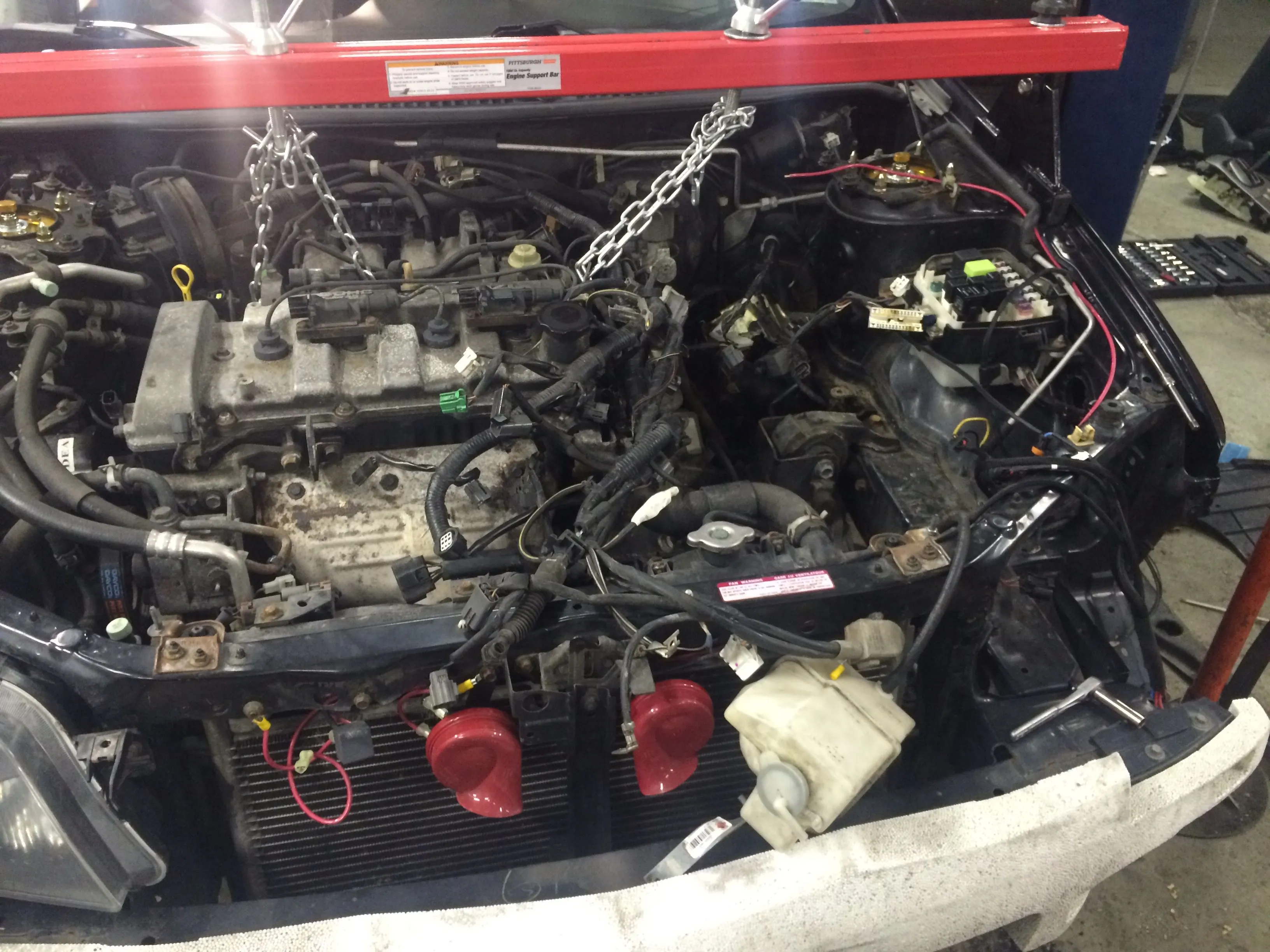

Now on to the car stuff! I found parts locally and decided to manual swap my autotragic car in January as a gift to myself for working my ass off from Halloween through the new year. I guess its rewarding work with more work, but I always wanted to do this. Luckily, I was able to reserve lift space. The plan was to tear out the automatic and harness and use a replacement from a '95 probe with no ABS and splice in the ABS harness from the automatic car.
Here's the beginning of the end of tear down. You can see the Hella Twin Trumpets that I put in too.

So all the things that went wrong immediately after disassembly...
1) I realized that the transmission I had didn't come with the necessary brackets and they would need to be ordered from the dealer (three day delay)
2) I banged the rear oil seal in too far and needed to order a new one along with the brackets.
3) I destroyed a wheel bearing while getting the axle out. I ordered the replacement parts from Amazon, but they were stolen from outside my door (additional 3 day delay).
4) Lost one pressure plate bolt and washer after replacing the rear main seal... Another dealer order
5) Finally, I was sold an obviously broken clutch pedal by Harbor Used Auto Parts in Lynn, MA. Luckily, I was saved by a forum member.

I was lucky that the lift was open this whole time. There was very little I could do while waiting for parts. If I did more prep work, I wouldn't have run into these problems. Eventually I replaced the wheel bearing and rear main seal. I banged the rear main seal in way too far. I had to rip off the inner annulus of the RMS and pull the circular spring out. Eventually, I used two self tapping screws to get the rear main seal out. After the pressure plate bolts came in, I was able to speed up reassembly. My roommate helped me out a lot. My girlfriend brought me food at the shop and drove me around a couple of times to pick up parts.
Yeah. Not to mention that I snapped a bolt in the slave cylinder and crossthreaded another bolt. I thought I got it working, but my replacement slave cylinder is leaking now and my car is out of commission until I can fix it. I got to drive it for a bit though. My biggest takeaway from this swap is that bolts, lines, and brackets really add up.
total cost was about $200 for three of the brackets and two rear main seals so that's about $160 for three brackets. I'll find the receipt tonight to get more accurate numbers.
s***. I would have got brackets from a wrecker dude. The black motor mount brackets? Hope You didnt buy the brass looking ones that hold wires in place.
Yeah those brackets. I'll post the part numbers later. I called local yards and checked car-part, but couldn't find them anywhere other than the dealer.
Surely there is a Protege sedan or something at a pick and pull with a useable banjo bolt. Take your new slave with you and pull a few, shouldn't be hard to find one.
I was able to find one at NAPA and I think I have it covered now. It was really more of a transportation problem.
