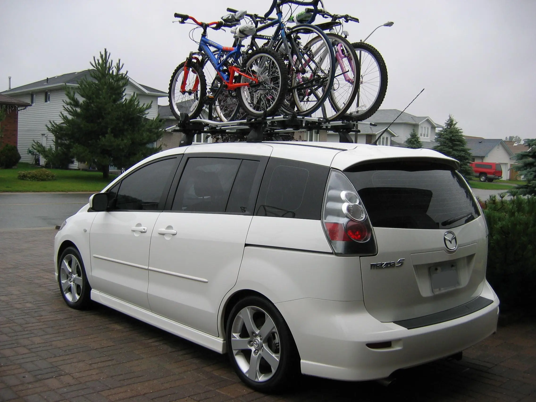

One of the problems with the Mazda rack for the 5 is that its just too narrow. I ordered Thule LB50 bars from LLBean (great price to Canada) drilled out the original rivets and installed the longer bars. Used stainless 1/4 inch button head hex bolts which I put right through the plastic cover for the foot. Its a bit of a process to get on and off but it works much better than I anticipated. Last year I transported bikes on a hitch rack with only two on the roof. The back of the van came down quite a bit with ~ 80 lbs of bikes and 75 lbs of rack, not to mention the cantilever effect of the rack sticking a couple of feet off the back. See picture from this year, with the same load last year the rear wheel was just inside the edge of the wheelwell, ~ 3" difference. It handles better, no one flashes their lights at me and I have unincumbered access to the rear gate. If anyone wants details on this mod please email me.

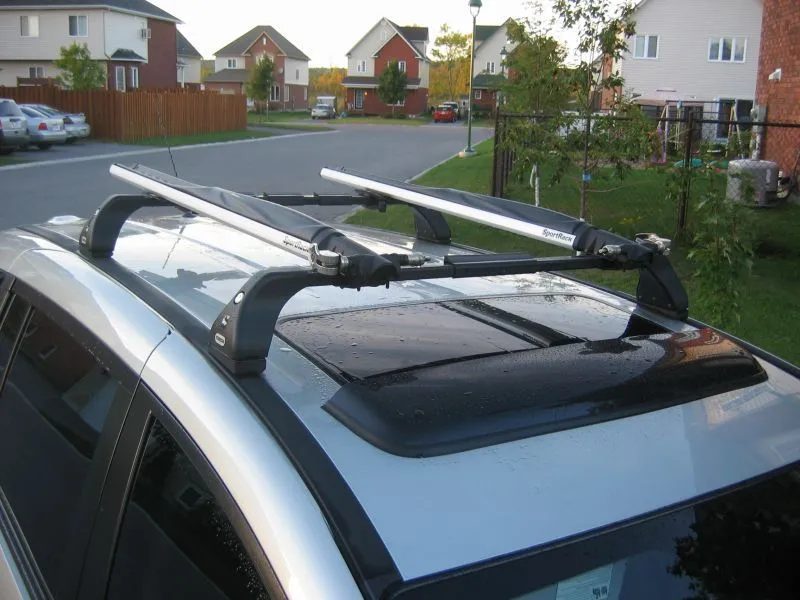

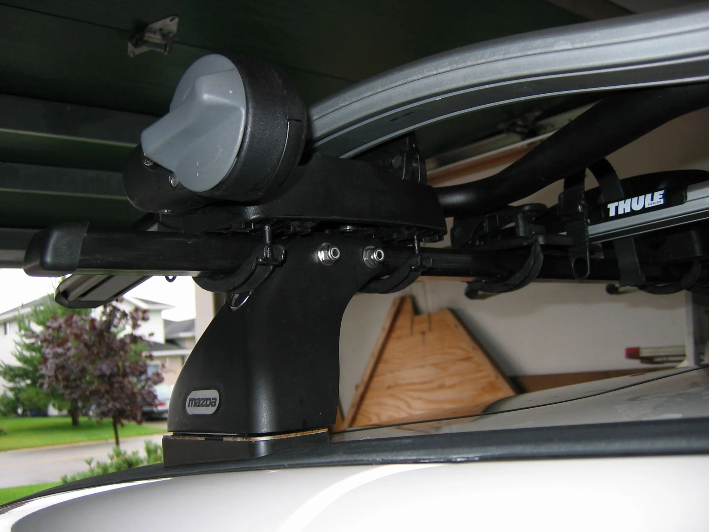

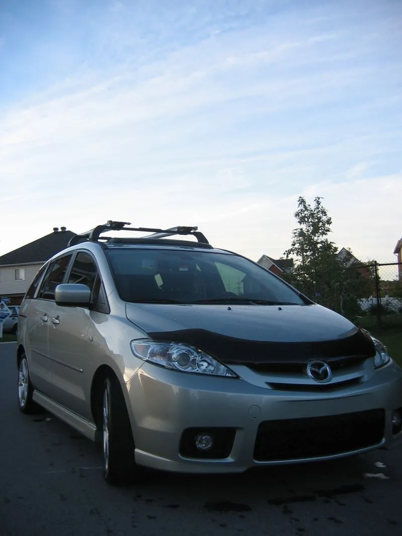

Somebody at my dealership asked that I post pictures of my roof rack. It's been a while, but I'm doing it now!
So, it's the Mazda rack, with two SportRack Piranha bike supports (with wheel off).
Excellent! Crossbars look great.
