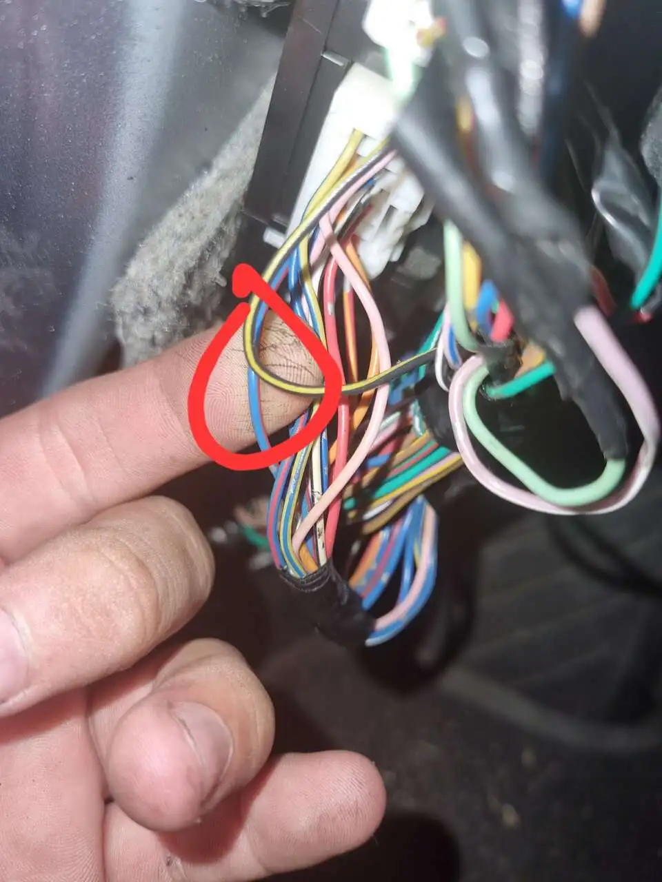

@2011CX9 Hello Friend, I need your great help to get my 2011 cx9 to have independent fog lights, following what you say here, I don't have something very clear, my cx9 is the GRAN TOURING it already comes with a factory fog light, but look inside the BCM There are 2 cables, one BLACK/YELLOW and the other RED/BLUE. My question is, should I join these two cables? and with that I already get independent foggers? or each cable is connected to another place?
