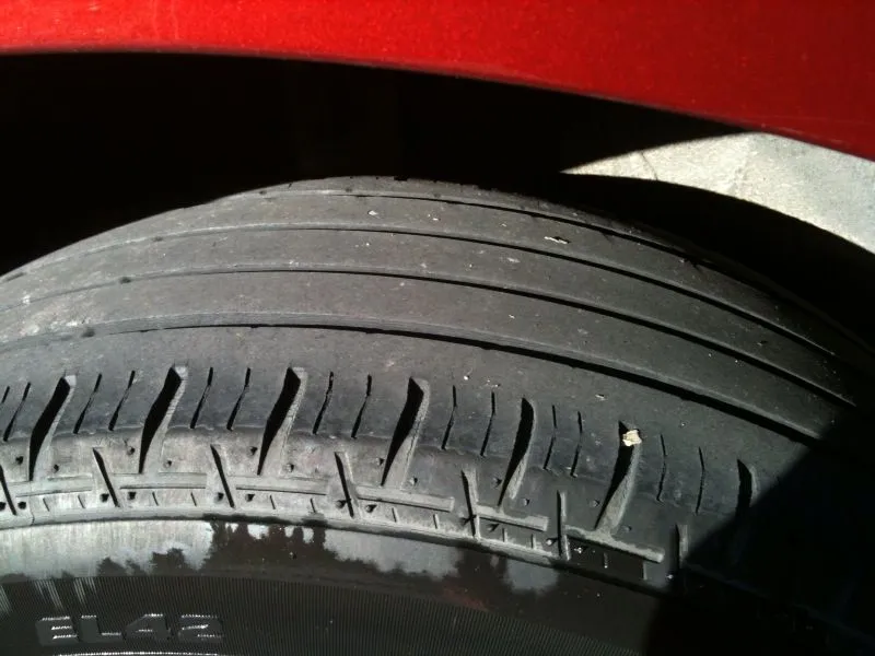

BTW, on the check up report, the tire tread was listed as 2/32". Actually I have a snap of the tire as attached. Looks like it is greater than 2/32"?

Yes you are right. I checked the report again. It say 4/32". Apparently Mazda recommends a tire replacement when it is less than 4/32". So I guess I will keep running on these tires ...
The wear bars are susposed to be at 2/32 inch and you appear to not be there yet.
