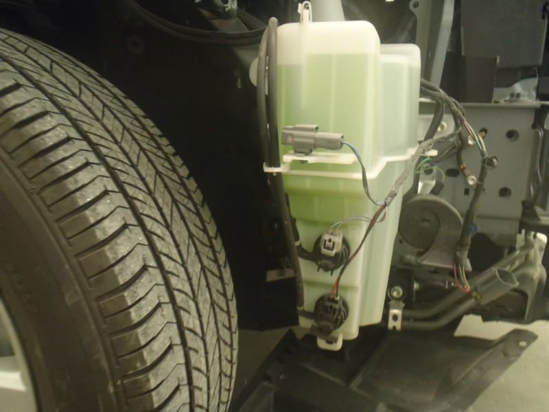

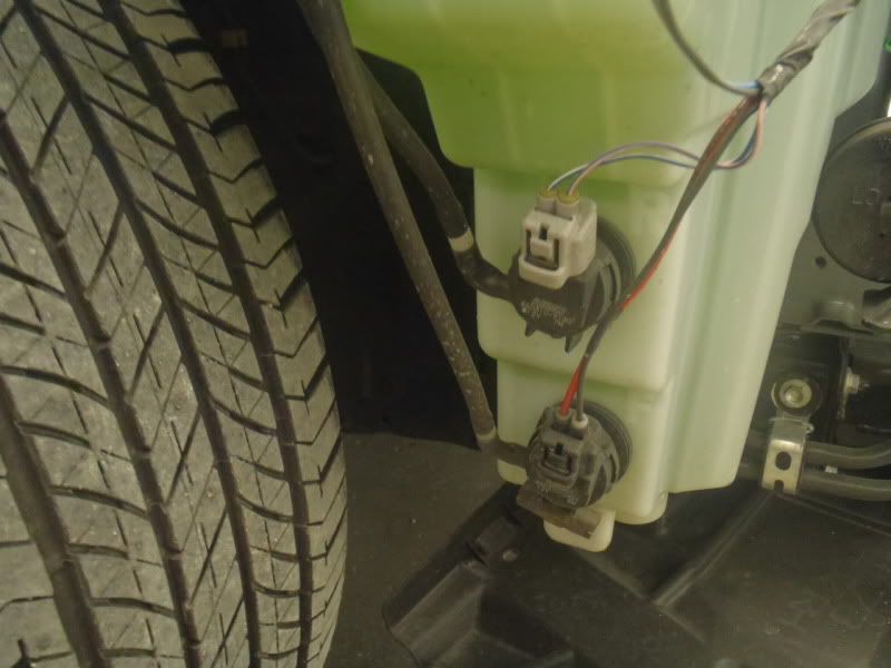

Apparently, there are TWO washer motors attached to the tank at the lower part.
The one for the rear sits higher than the one for the front (which makes sense).
Therefore, the rear one should run out of fluid first, which is a sign that the fluid is nearly empty.

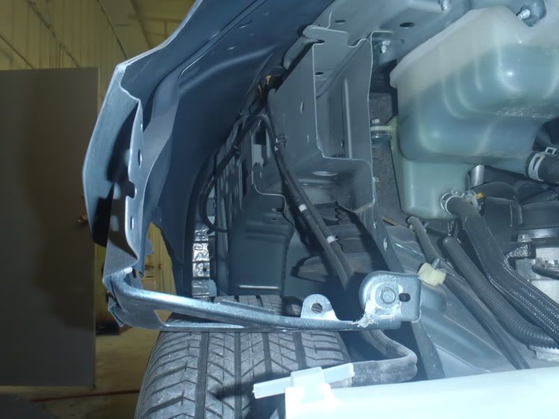

I have similar problem except I can hear water hitting somehwere in right front wheel well area. Washer fluid pouring out right infront of paasnger front door. I think the hose to the back has poped off the motor. Anyone have any idea how to access this location. Thanks

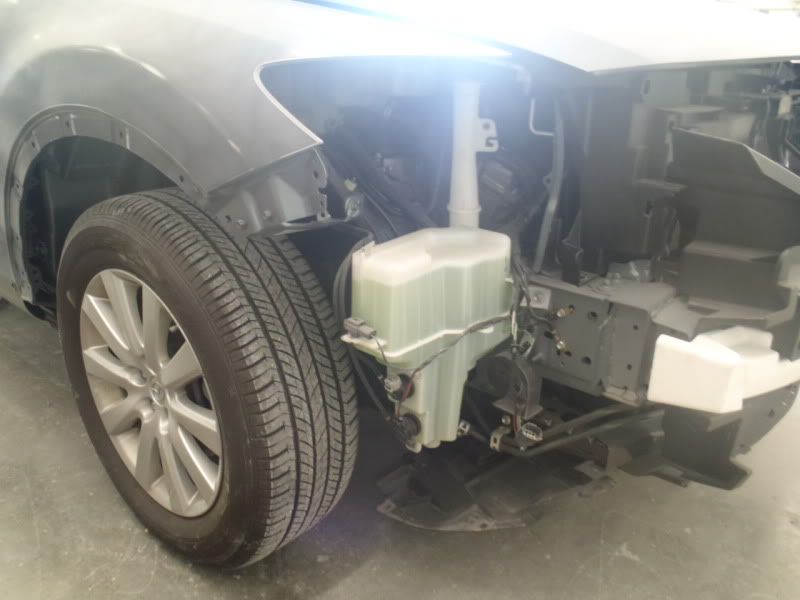

Crawl under the bumper and you will likely have to take the fender liner out, or at least half way remove the fender liner. FYI - alot of fender liner clips/plastic screws are non-reuseable.
Here is exactly where the lines plug into the tank. Looks like the lines plug in to the washer pumps and then run up across the upper apron rail, I don't see any junction in the line, so likely your issue (rftrain) is just that it came unplugged from the pump.
