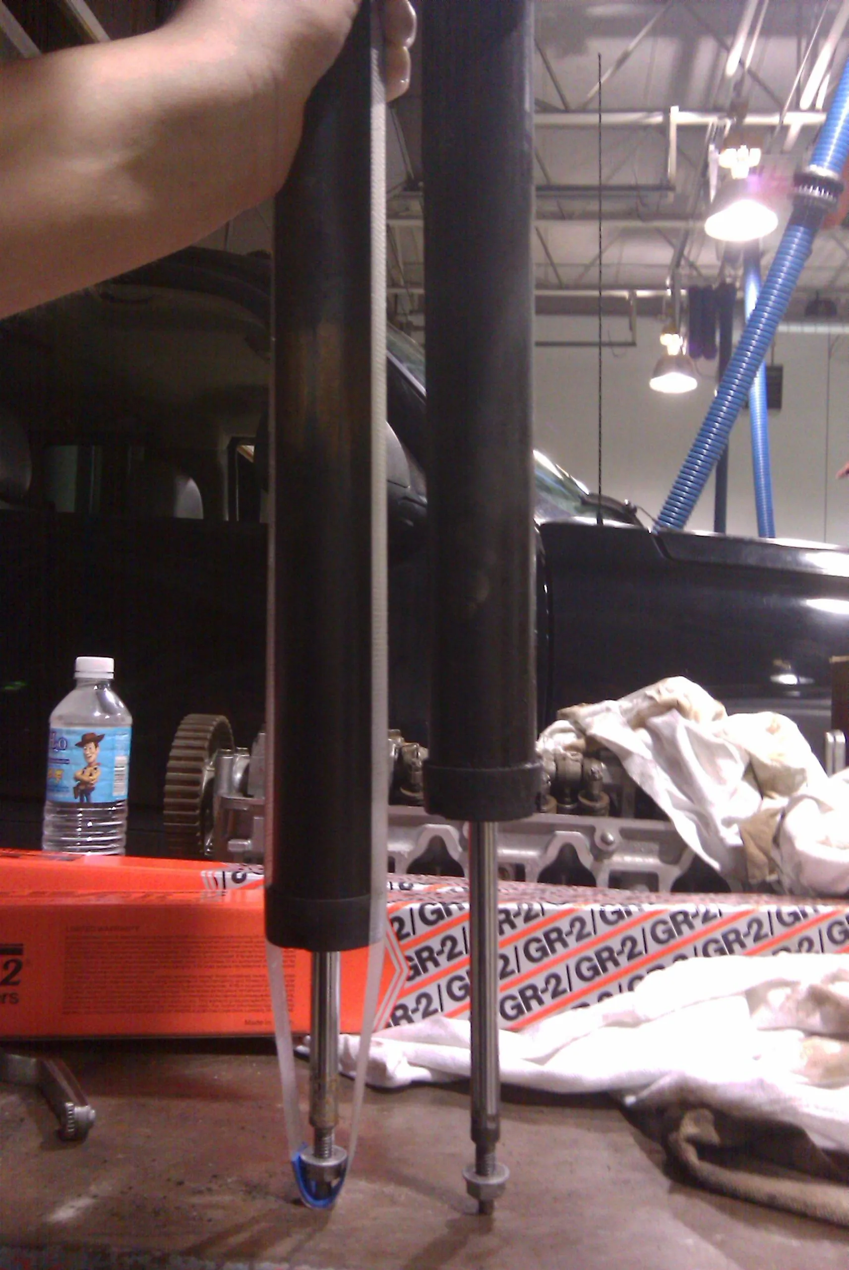

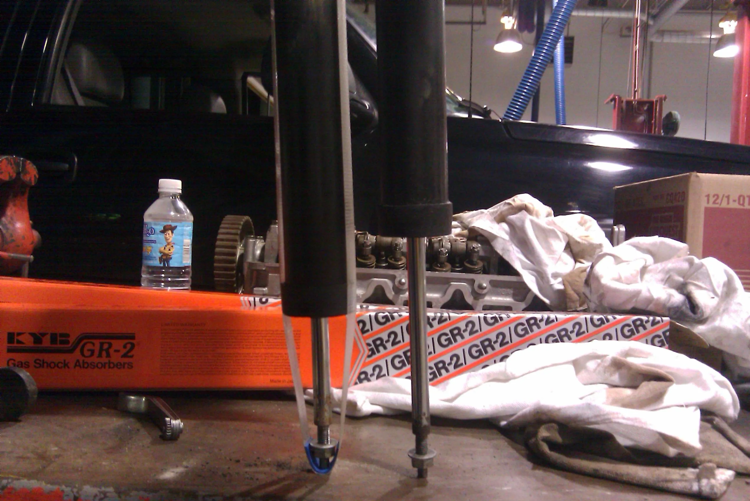

2006 Mazda5 Auto with 56k miles. Replaced rear shocks due to clunking noise when going over bumps. Installed KYB GR2s. Upon inspection of old factory shocks, I discovered that one the shocks does not fully compress down. See picture. The shock on the left is at full compressed. The right shock compresses about 2 inch short of the left one.

I just bought 2 rear GR2 shocks for rear end clunking noise. These shocks seem easily compressible. Is this normal?
