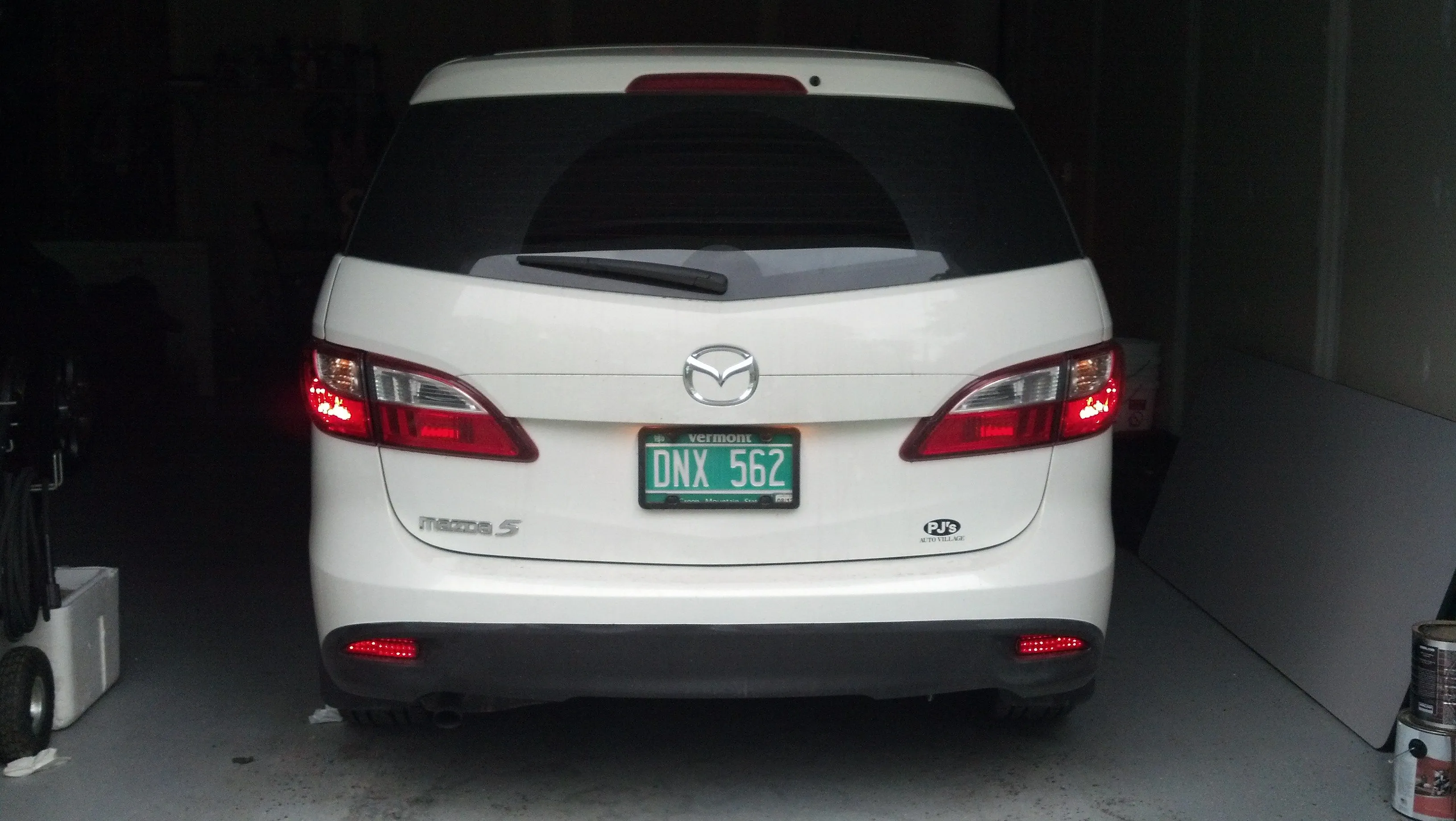

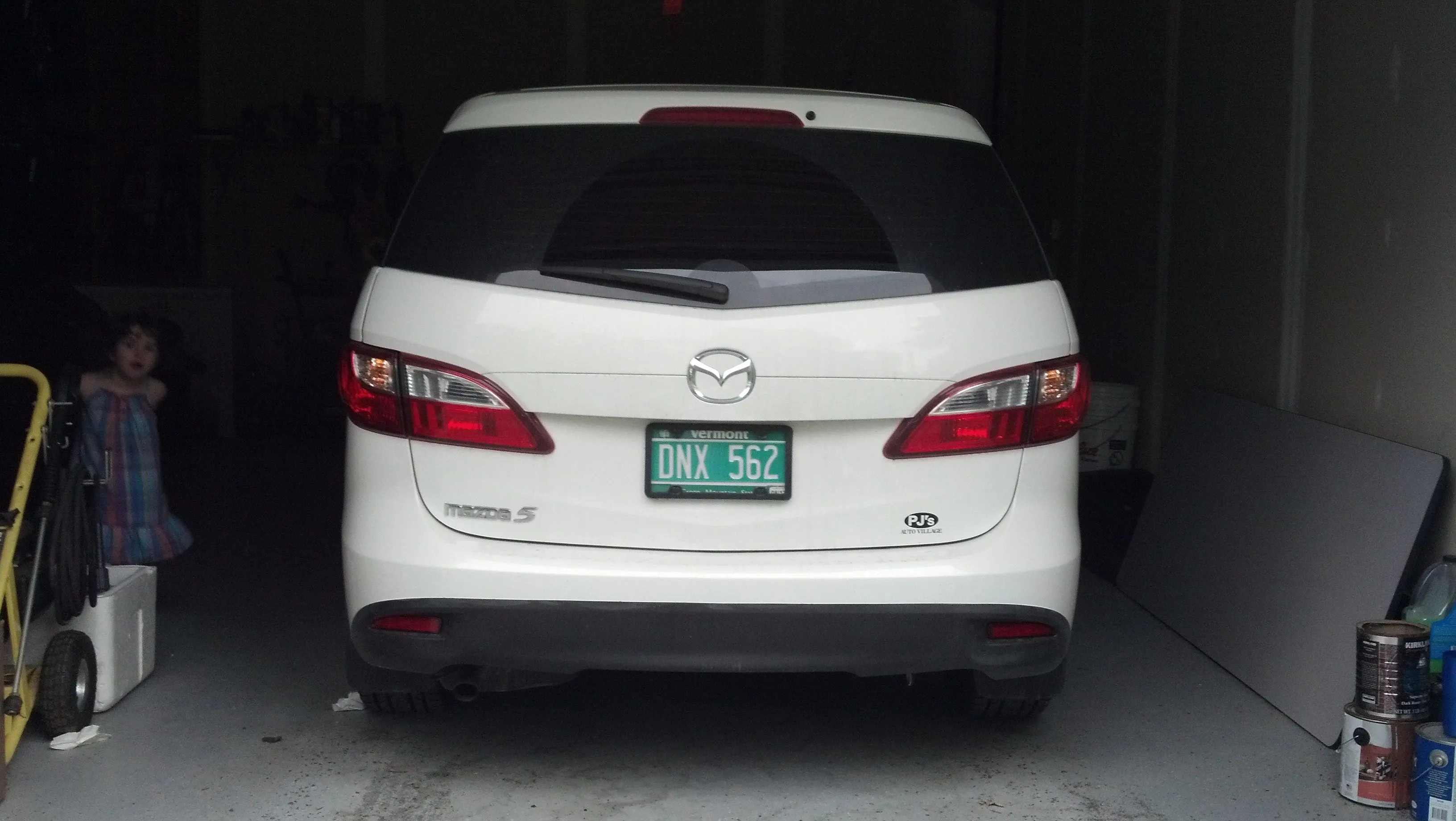

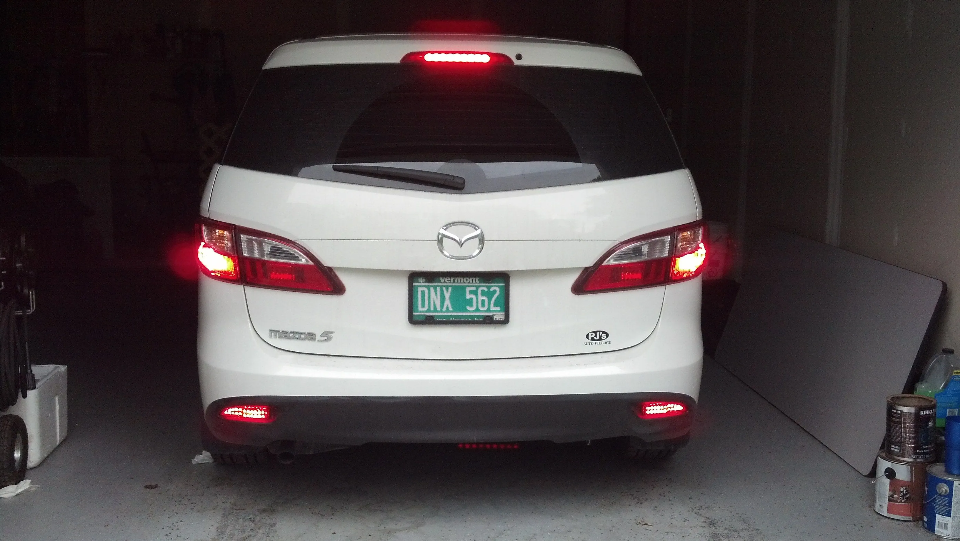

This week I installed the rear reflector LEDs on my 2012 Mazda5. Was pretty easy to do and I think it looks great. I bought the LEDs from the Speedline (this link was posted earlier by JovaBear). The price was great for these ($50) but the shipping was $18! They did come straight from Hong Kong in pretty decent time but they took several business days before actual shipping occurred. Some photos and a link to a video are included.

Nice job! Man that came out nice, looks like it came that way from the factory. I really need to do this to mine....

Sweet you bought and installed the LEDs! It came out great! The shipping definitely took some time, I think it was like 2 weeks for mine to come in. Glad to help you out.

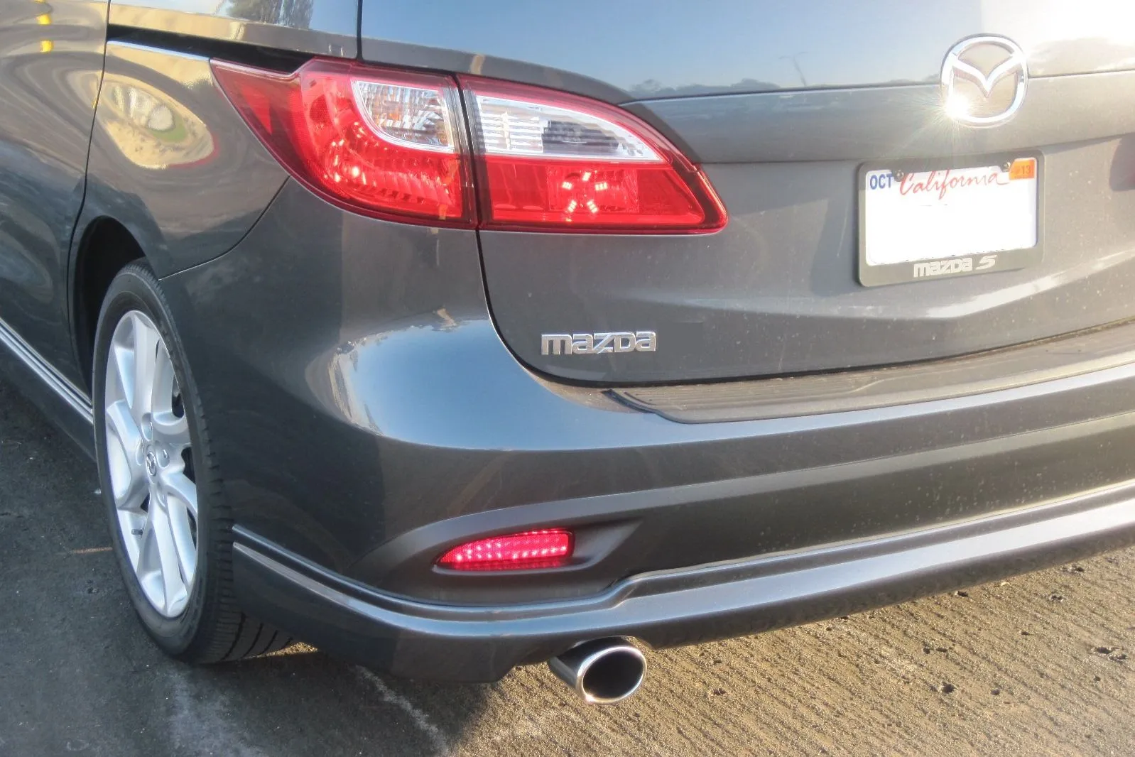

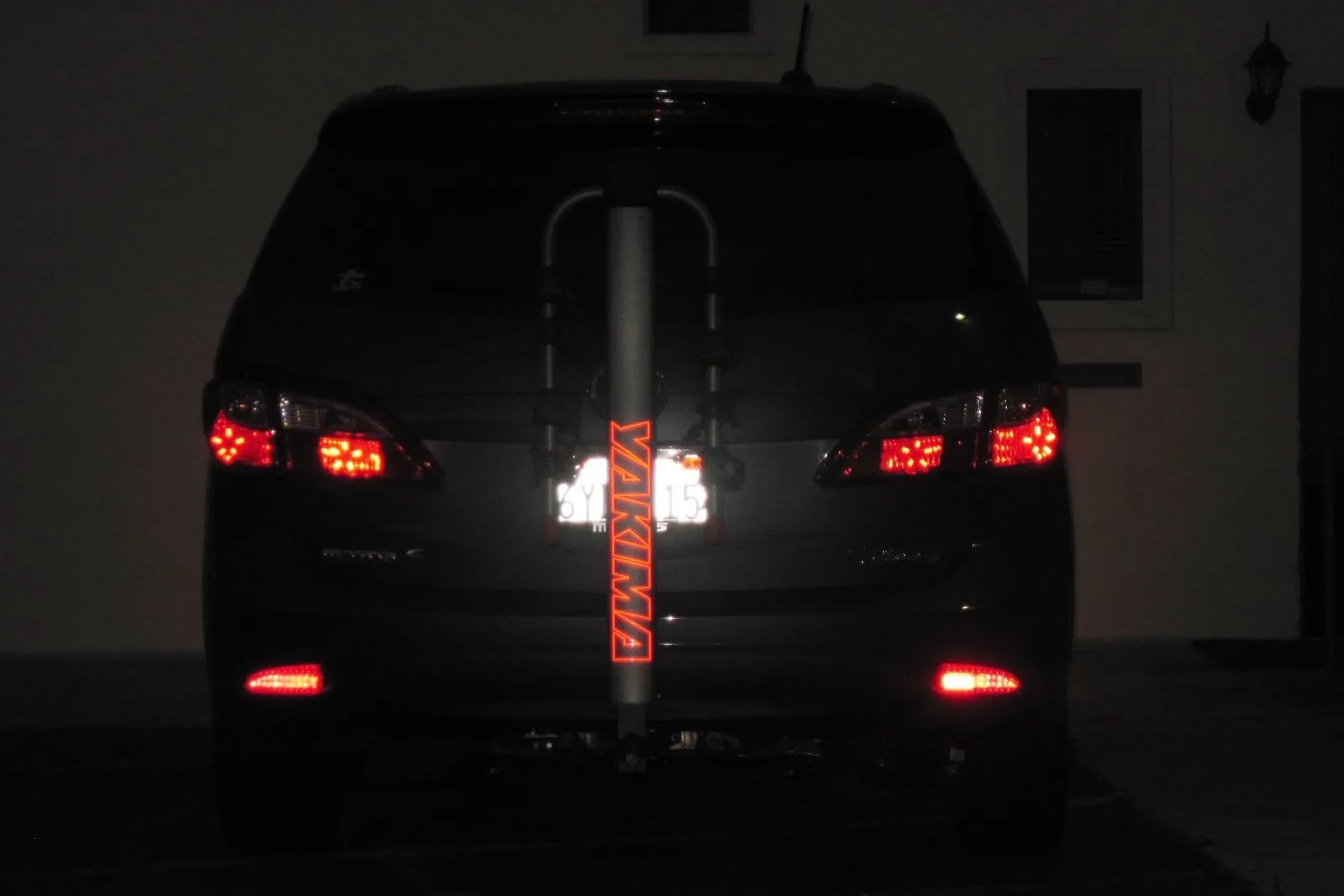

I just installed the Speedline reflector LED's on my 2012 M5 Touring this past weekend:
On the 2012, it was more than just the clips that held the reflectors in place. There is a plastic cover that screwed into the backside of each reflector with one screw, this cover clamps the reflector to the bumper.
Getting to the screw from under the bumper on the passenger side was easy.
Getting to the screw on the driver side was a different story, due to the exhaust pipe and the muffler. You will have to remove the screw blind with a stubby screwdriver. Not easy to get to, but it can be done.
I drilled a 1/4" hole in those covers and added a rubber grommet & silicon for the wires to pass thru.
I wired the reflectors to a SPDT Relay to have the bright LEDs on during the day (tail-lights off) and dim LEDs on at night (tail-lights on).
BTW, it didn't come with instructions, but the blue wires power the bright LEDs and the orange wires power the dim LEDs.
