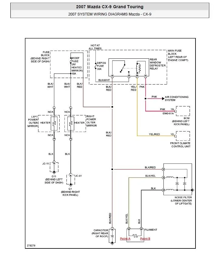

Attached is the circuit diagram I found for CX-9 2007-2008 model. I did a voltage measurement on Point A and Point B as shown on the diagram both readings shows 14V while the car is running. If I don't turn on the car my battery will get discharge so quick that I need to jump start the car with external battery.
I'm sure something wrong here, as another document says that from Point A as I move the voltmeter prove towards point B the voltage should drop to zero or ground. Looking on the diagram if one of the capacitor is shorted it will feed 14V to the BLK side and actually shorting my electrical system to ground whenever I turn on the rear defroster.
Is it safe to bypass the noise filter circuit and attached the positive of 12V battery on BLK/YEL wire and negative on BLK wire on the diagram to test the filament. Of course I need to disconnect the filament from the noise filter circuit.

Maybe the relay is constant connecting. The defrog 30 A fuse is getting constant power and the only thing that is in between that switching is in relay. Take the relay out (R4 in the main-box) and measure whether it is constant connecting on between the 2 connectors that are located directly next to each other...
