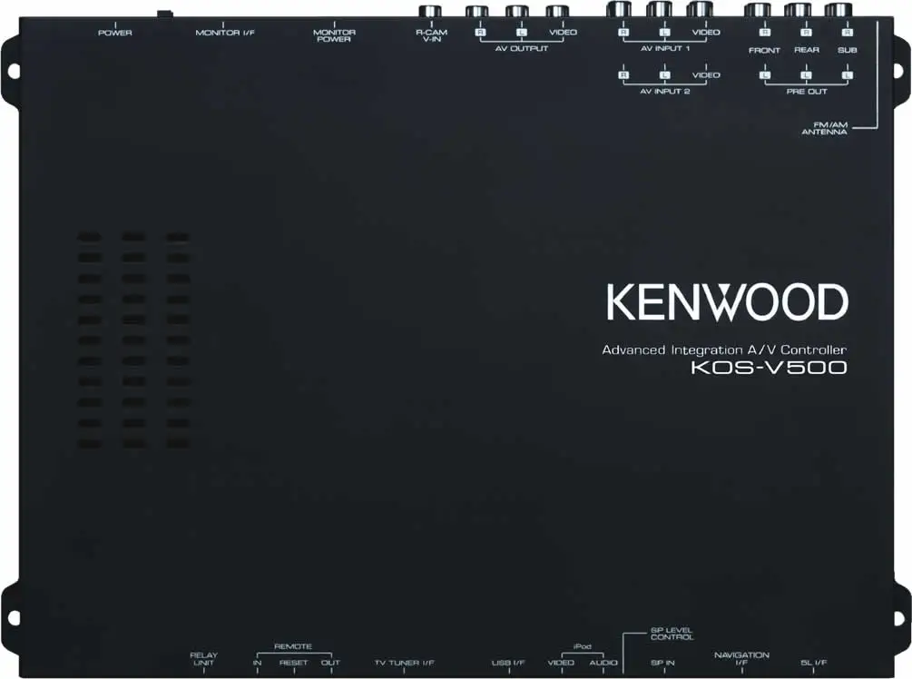

Oxymoron said:
OK if i buy this gadgetfrom Kenwood can i basically hook up anything to the stock MS3 Bose and NAV.
Kenwood's Carpotal KOS-V500 Expansion Solution lets you can build the ultimate A/V system without replacing your the factory system. Add high-speed iPod control of both audio and video. Enjoy navigation, satellite radio, Bluetooth technology, and HD Radio, and much more. The KOS-V500 even includes two relay control outputs for control of garage doors, gates, trunk releasesthe skys the limit!
Interfaces with Factory Radios to Build the Ultimate A/V System
Control with the KOS-L702 touch-screen
Control with the supplied remote and use existing LCD screen
Selectable AM/FM tuner with RDS+
Can be used as a stand-alone source with KOS-L702
USB Port for iPod or Compatible Player
High Speed iPod Control of Audio and Video
Includes 1 AV input/1 output for Video Sources
Front, Rear and Sub (2V) pre-outs for Amplifiers
Reverse Camera input
System Es Crossovers
RGB input for Navigation
2 Relay Control Outputs: garage door, trunk, lights, etc.
4-Line text display for Satellite, iPod, USB, etc.
Satellite Radio Ready, Bluetooth Ready, HD Radio Ready
