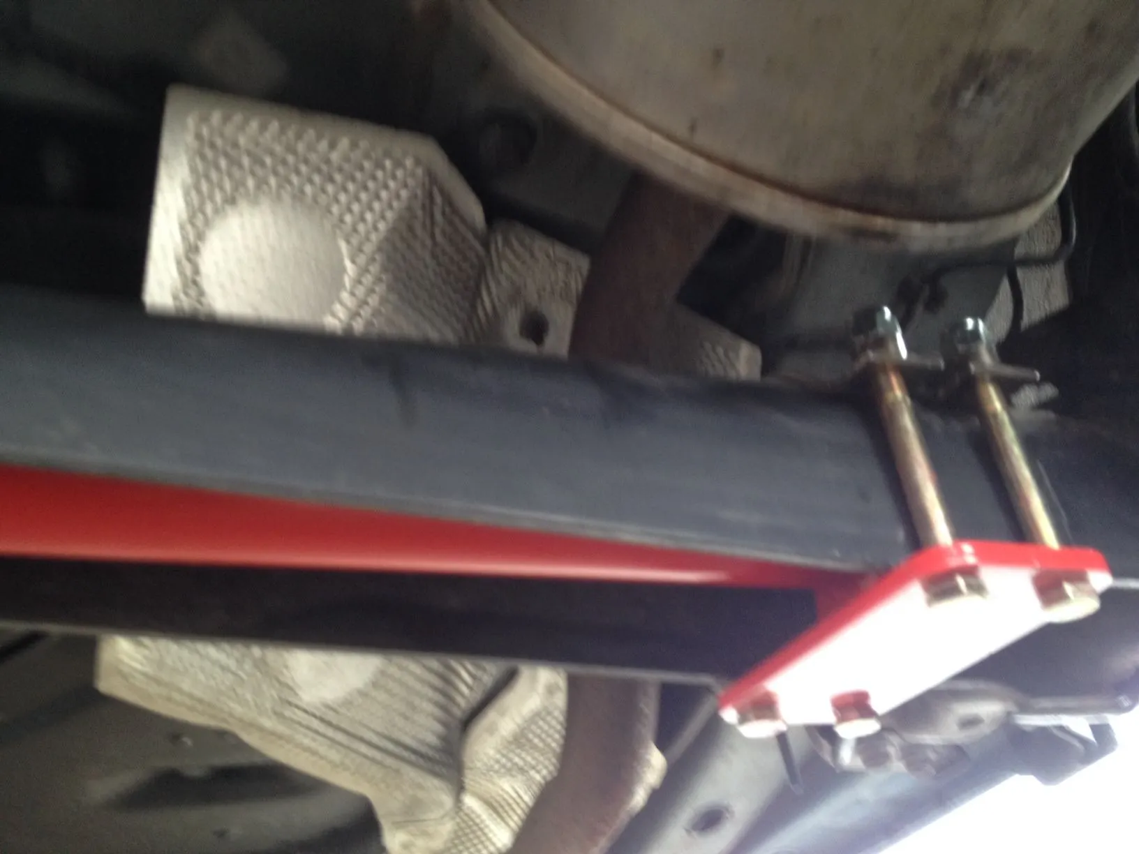

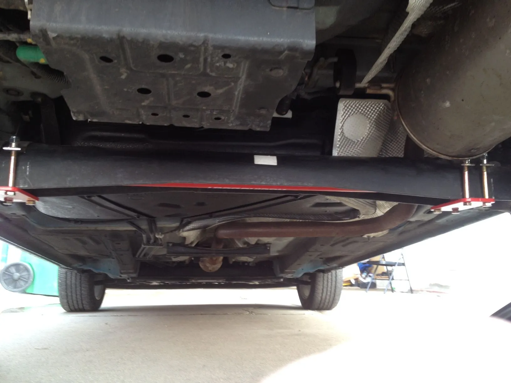

For those who install the racing beat rear sway bar, Is the nut suppose to be that high up at the edge of the threads? In the instruction it shows the nut being half way through the threads. I'm not sure if I need to tighten it some more or if this looks normal.
As long as it's torqued to the proper 25 ft-lb, I think you should be good. Definitely do not torque beyond that, otherwise you could damage the bolts. Use some thread locker if you're worried about them coming undone.
