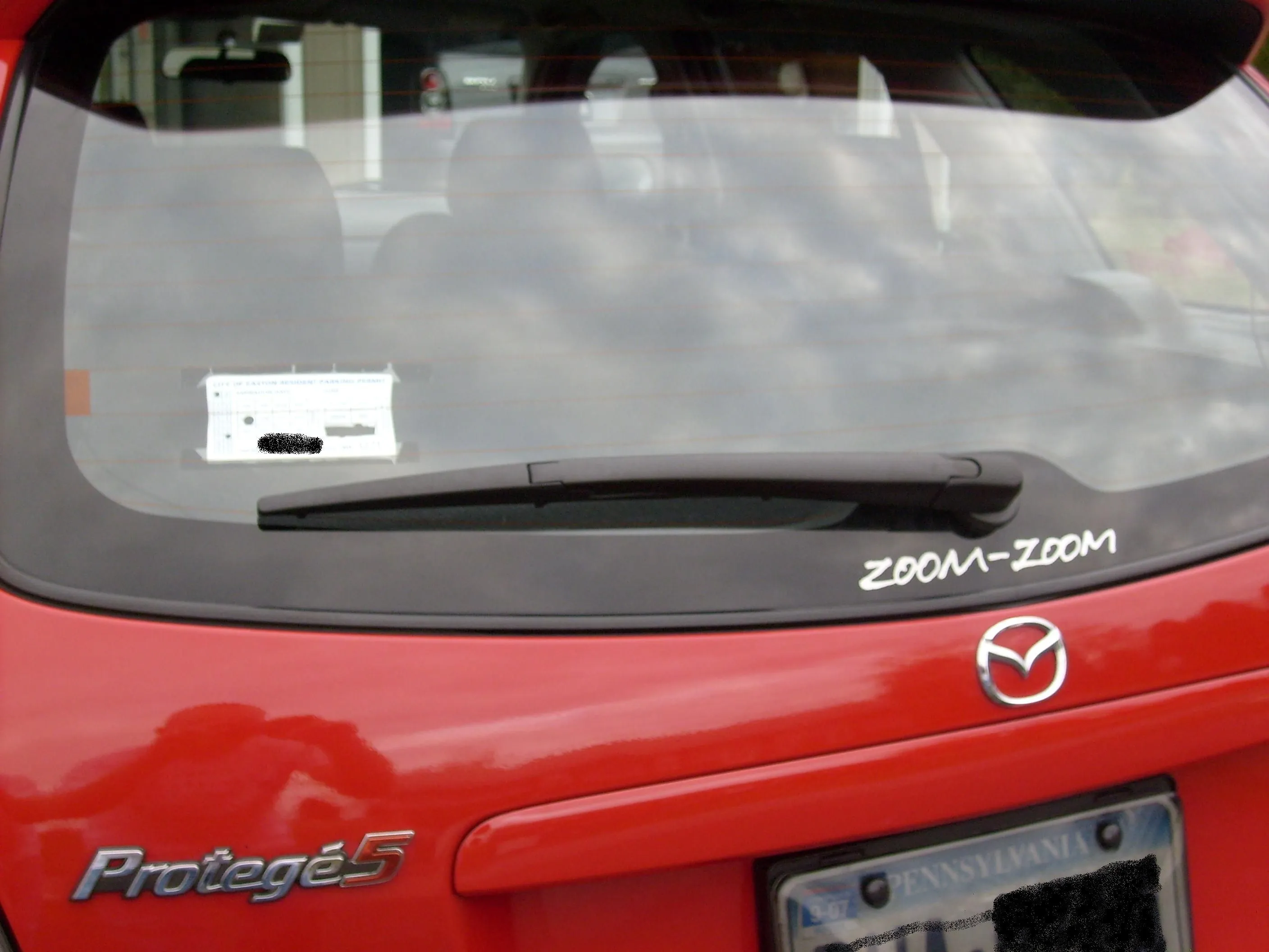

No, buy the parts & do it yourself. Only get the mazda 6 wagon rear wiper while you're at it. Much better looking.Works every bit as good or better than original. The arm, blade assembly & cover are 35 bucks at onlinemazdaparts.com. The hatch panel comes off easy. Then it's just unplug wires, unbolt motor & put new one back on. Scariest part will be yanking the interior panel off - just pull & watch for flying clips. Put them back in & pop back on - simple. There's a how-to for the wiper mod - use search. Also service manual stickied somewhere in here or search for floptical.net there's a link to one there in many threads. Simple stuff, feel good & save money. No special tools needed. Check out prices for motor & wiper at onlinemazdaparts.com

I also highly recommend the Mazda6 wagon wiper mod. Works great and looks great too.
