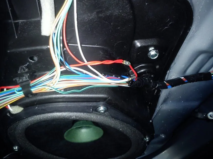

So I was goofing off working from home today and did some Googling on the component system. Yes, I think the factory tweeter is just a tap off the midrange speakers. To do this right, I'd have to run a new speaker wire (+ and -) to run to the new midrange. Use the existing speaker wire (RED/WHITE, YELLOW/GRAY) to the new tweeter. Connect directly behind the head unit speaker wires to the input of the crossover. Connect the woofer and tweeter connection from there. It should work fine logically speaking.

I found where the tweeter signal wire splits off, it's at the door. It splits off right before it goes to the midrange and tweeter (see picture). This actually makes it a bit easier as I probably be mounting the crossover unit right behind the kick panels then run another speaker wire directly to the speaker.
