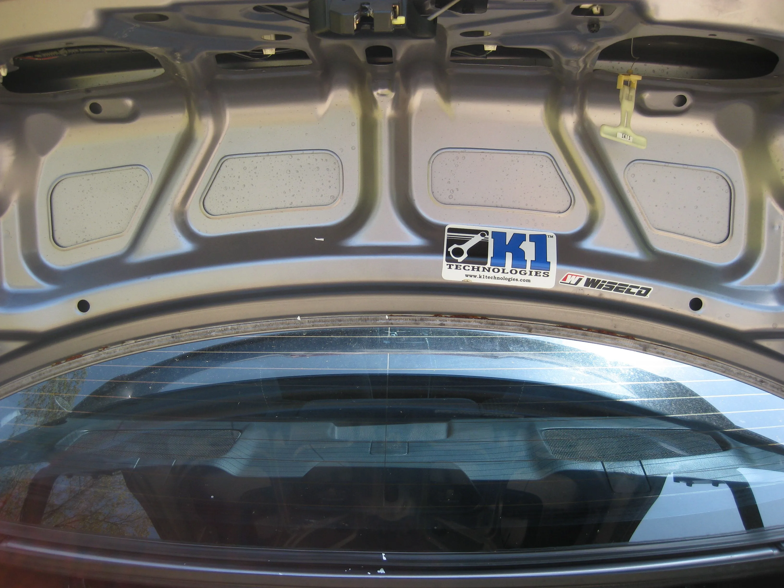

Is there anyway to tell if this motor has been built without taking it all apart? It seems to run really good an strong at 118000 miles There is wiseco stickers in the trunk and in the cabin also k1 rod stickers as well, but I just don't know

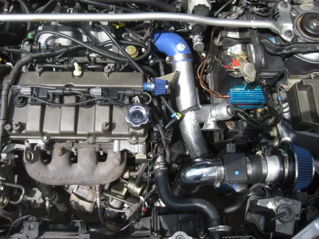

Turbo seal is leaking oil in my intercooler and eventually down my throttle body but really no smoke yet, just a thick carbon build up on my exhaust tip. I've replaced the pcv with a millennia 1047 and put a breather filter on my valve cover vent but no avail with the leak so...what's the cheapest way I could get a new turbo that will last me a while and bolt up with no hassle? I think this is the original Garrett that came from the factory. It has the Calloway manifold and all.

Welcome to the forums. You have quite a list of problems there. You most likely need new motor mounts (however if the car was modified they have most likely already been changed for solid MMs) if the shifter won't easily go into gear. What time of EMS is on the car. To check for forged internals you need to drop the oil pan and get a flashlight to see if you can see the rods.

It looks like you are missing the 03.5 shift knob... I think the Stickers in the trunk are interesting... You might have got very lucky... I think you could pull off the oil pan or use a scope to see the pistons and rods... I would think it at least has an OEM MSP LSD...

If you are running 10psi, then you have a different spring on the turbo or a boost controller somewhere. I'd remove that until you learn more about the car like what kind of EMS is running.
The PCM is under the carpeting in the passenger footwell. You have to take the door sill and all the lower trim off and then pull the carpet back and there is a metal plate protecting the PCM. The PCM is braced against the metal plate. You should be able to see without removing it if the wiring harness has been tampered with, and if so where the new wires are going, since there are a few options for sticking a piggyback somewhere.
Congrats on the purchase. I find it hard to believe people spend the time, effort and money (or even just a lot of money) putting in forged internals and then trade it in to a dealer and get basically nothing for it. Although, I guess that's how frustrating the MSP can be at times.
