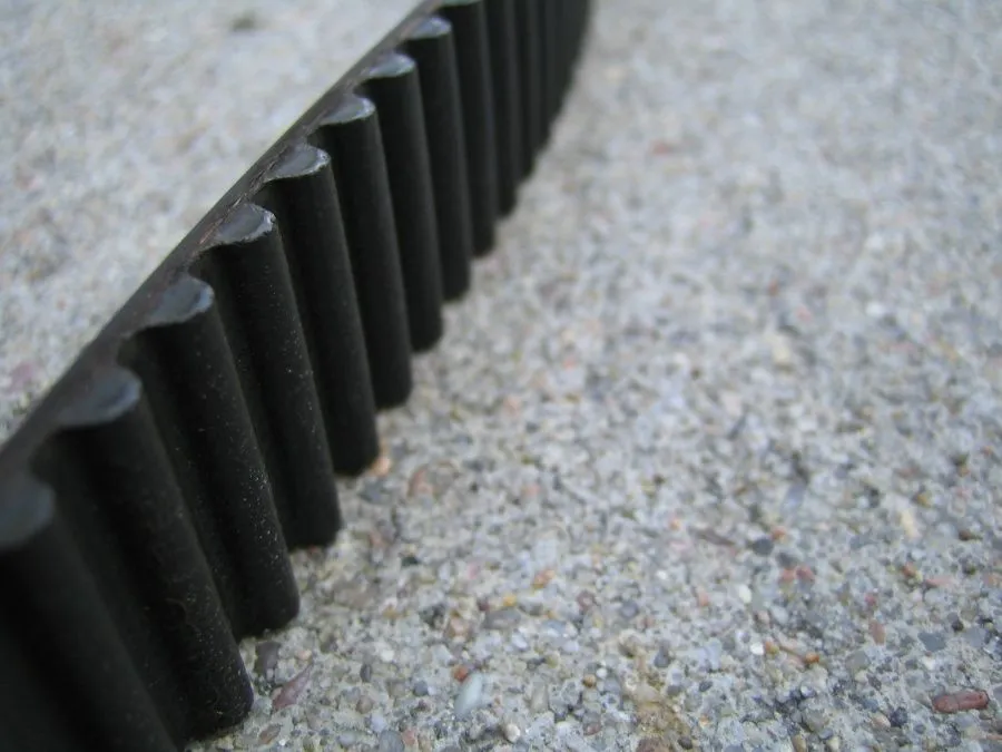

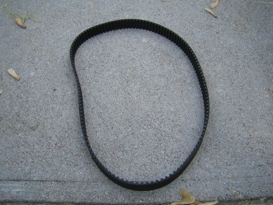

Had mine done at 99,000 miles. The belt looked "brand new."
Here are some pics of the used belt.
So basically, I wouldn't worry so much about the belt as about the tightness of the belt, which tends to get out of spec.
Edit: the point of my post is that even though be belt itself is fine at that mileage, it is likely somewhat loose (not as tight as it should be). If it gets too loose, it will jump teeth, you car won't run!

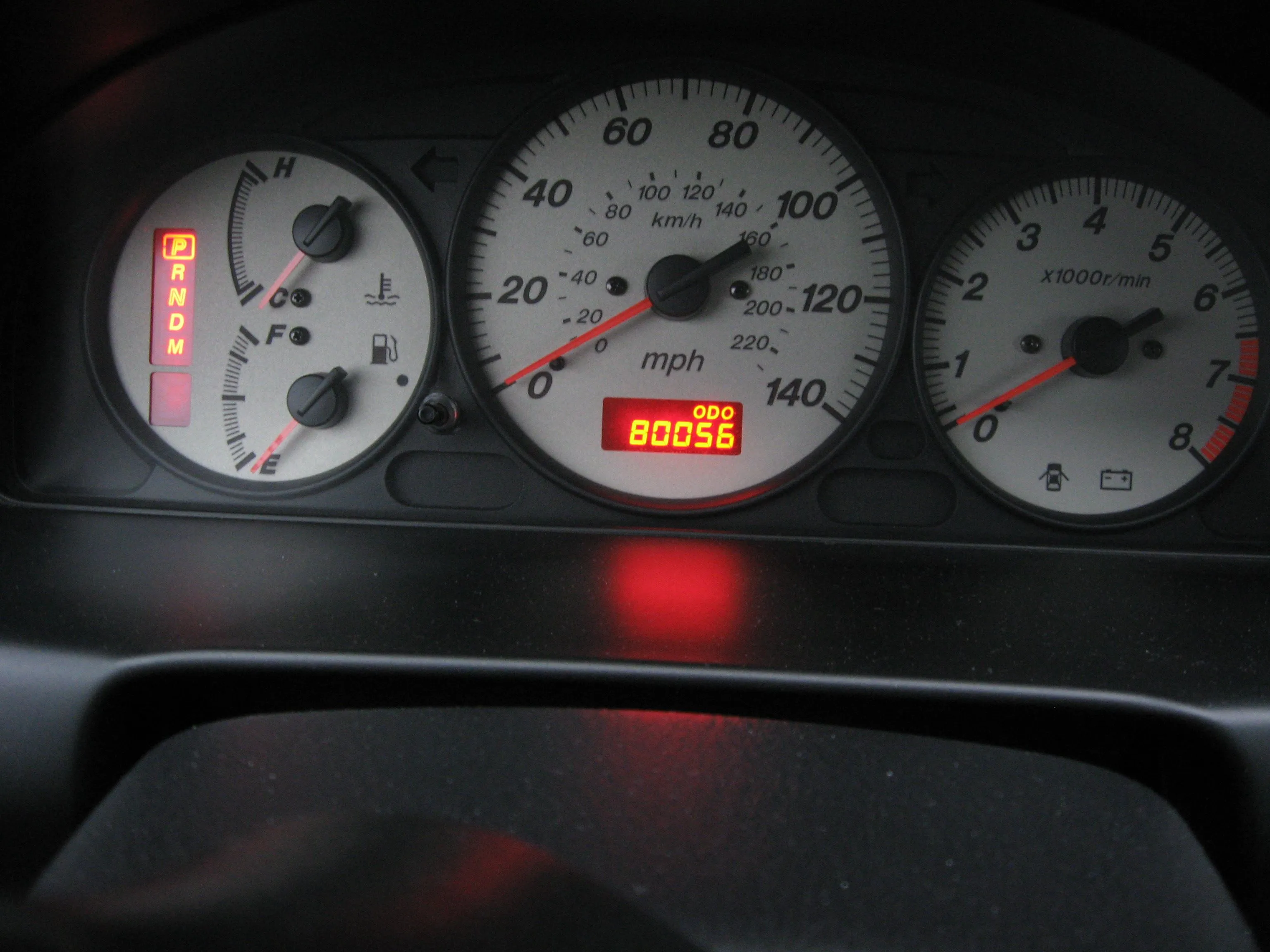

Just rolled 80000 miles
