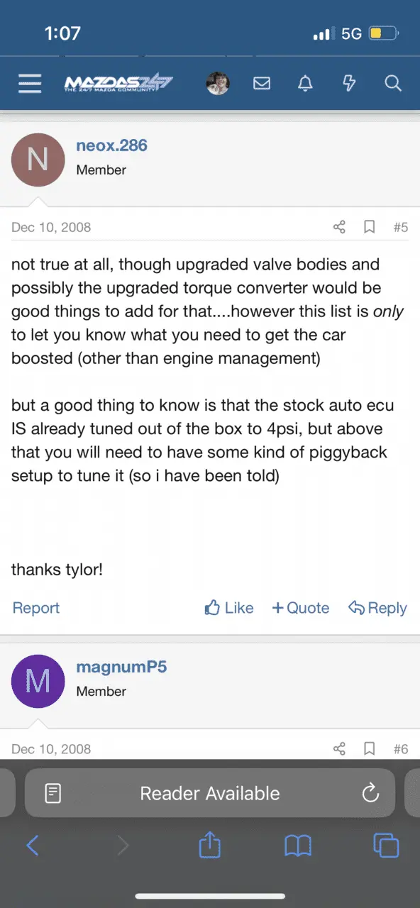

I read in another thread they the ecu from my 03 p5 can adjust itself for about 4psi of boost with no issues. Can anyone confirm this? Would the automatic be able to handle more power than stock?
Would 4psi be worth it?

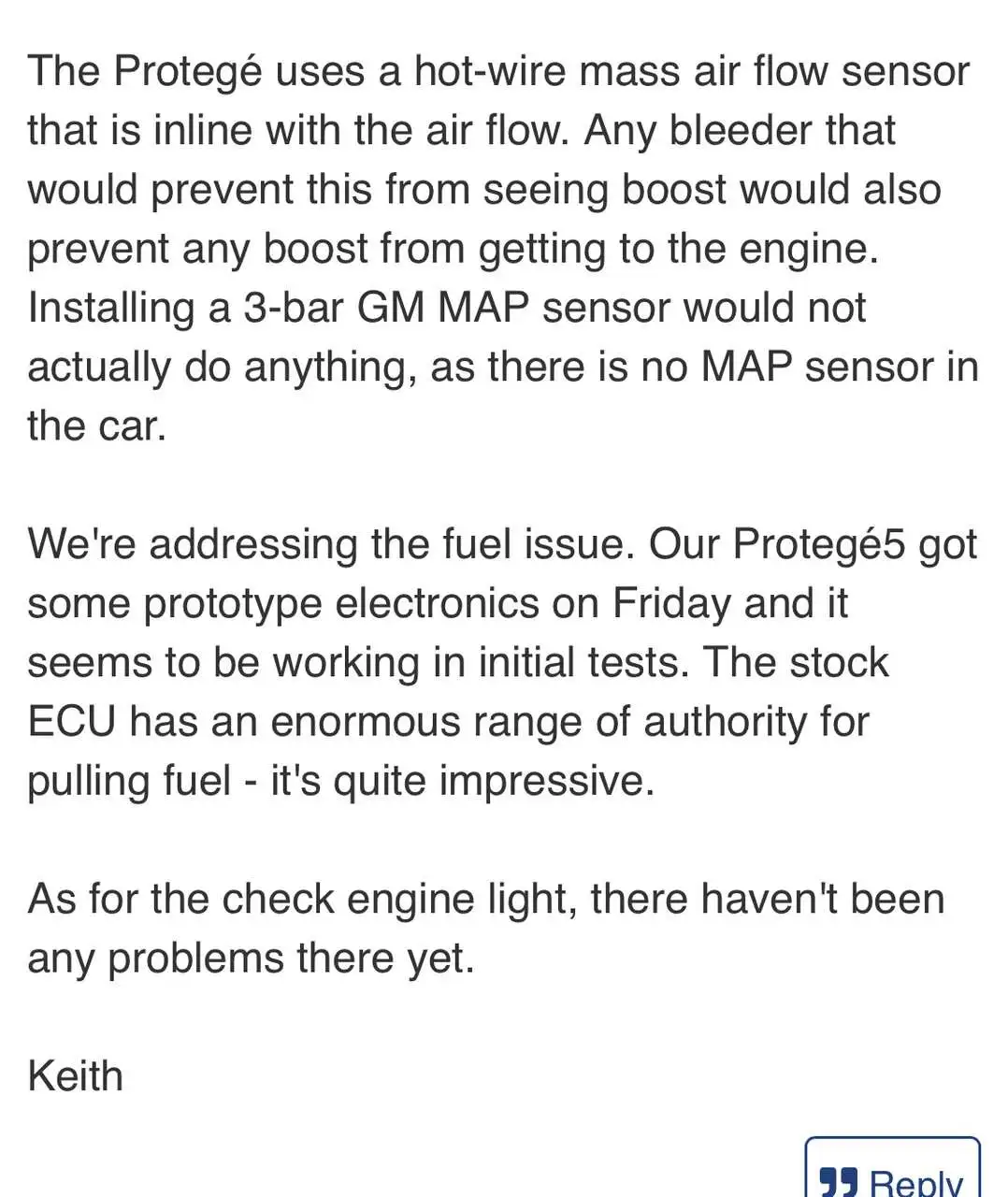

I found some info on old forums that seem to believe the p5 ecu can adapt to boost because it has a lot of control over fuel. Not sure about timing… maybe the 1.8 coils could be useful.
