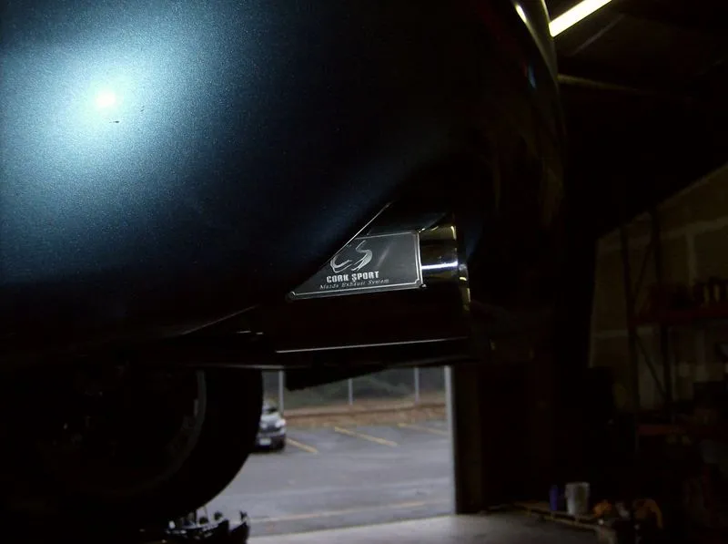

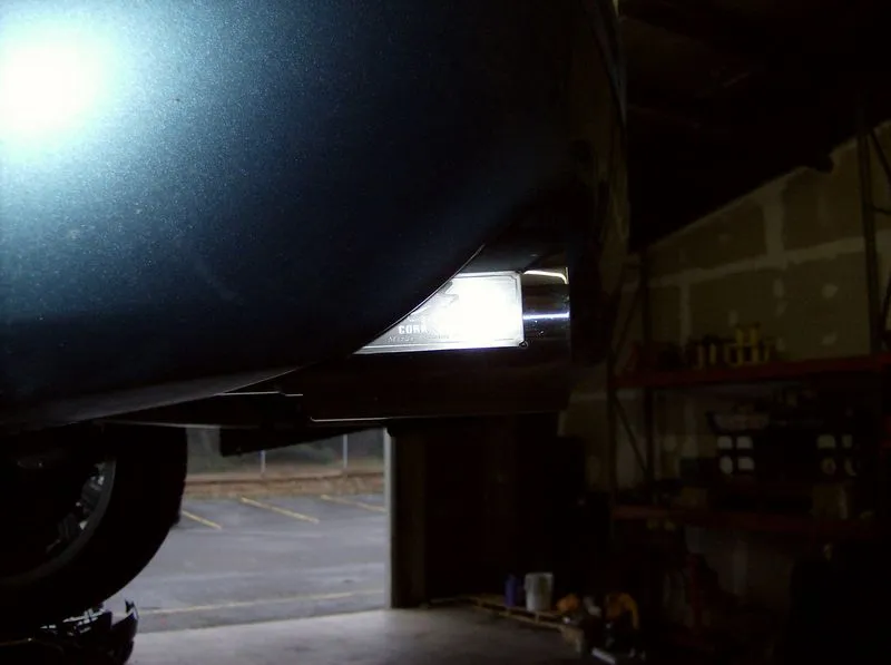

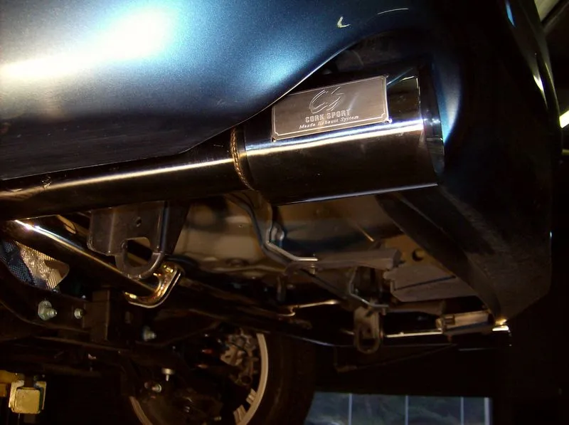

Right on. I wish there was a pic of it on the hatch as I find the stock exhaust tips recessed in under the bumper too much.
Attached are some close up photos of the tip alignment. We are pretty much right at the stock locations. Because of the scalloped cutouts on the rear valence, and the curvature of the bumper, it's pretty easy to get the 'way too long tips on a 1986 IROC Z' look. Our tips are 90mm diameter also, which is larger than stock, so the centerline of the pipe drops down a bit to provide decent spacing around the top of the tips, which also makes it more visible.
Also, the hatch and sedan bumper covers are the exact same part. It's an equal fit on either car.
