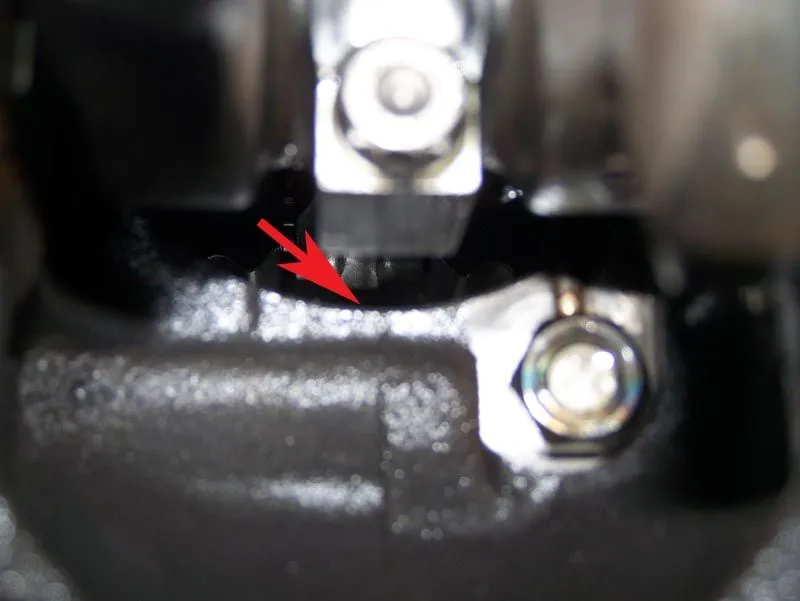

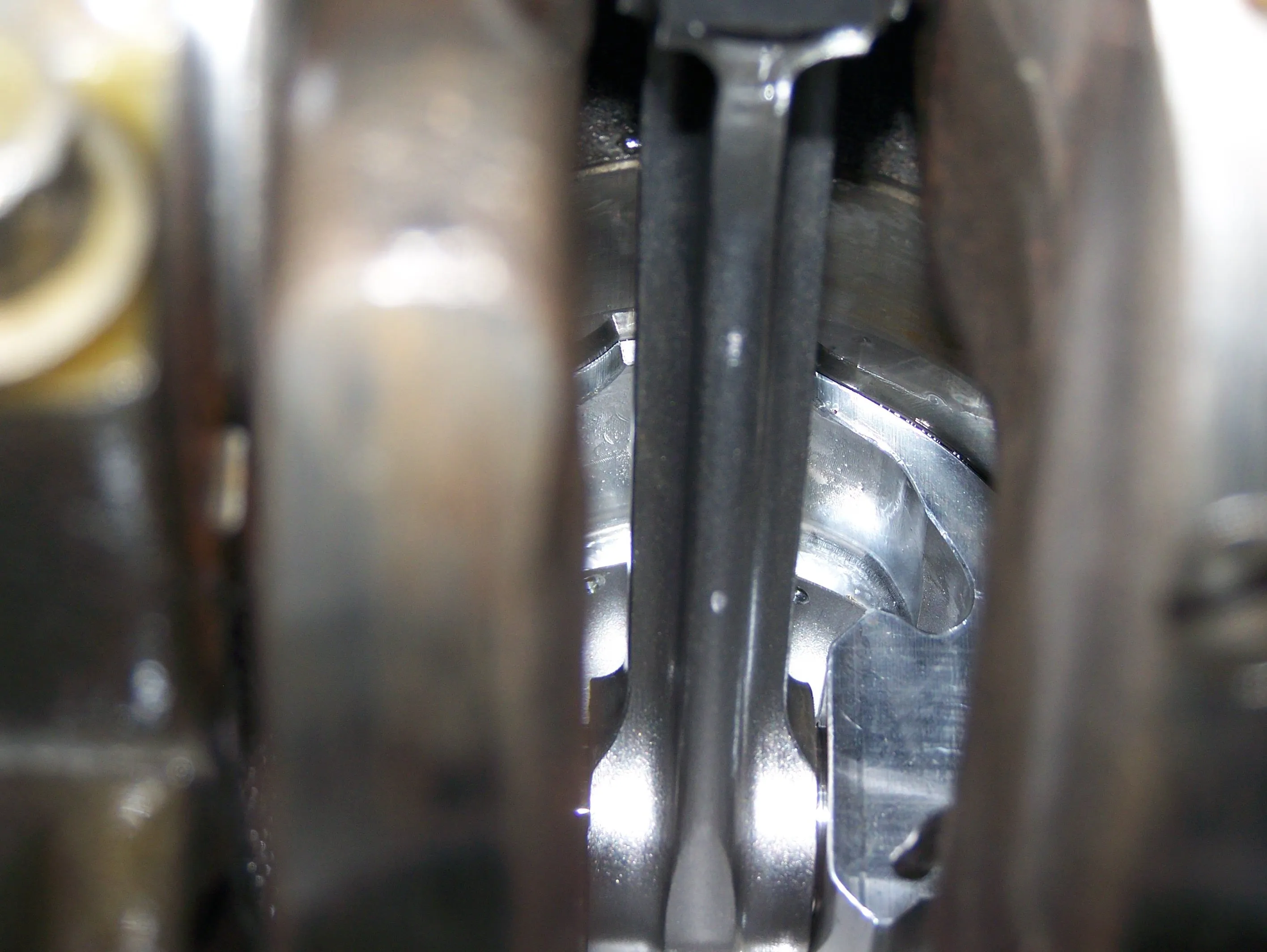

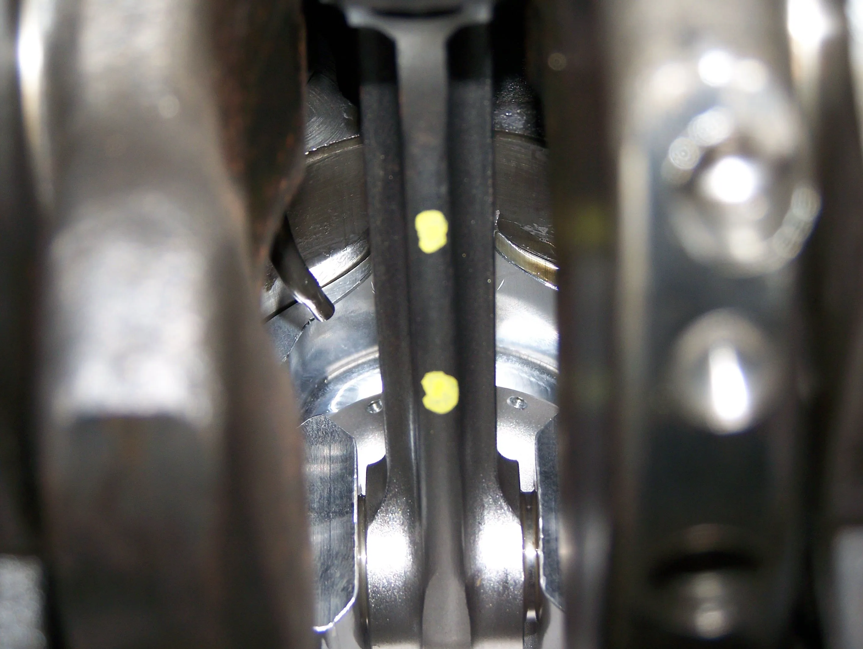

Here are the pics. You can see the marks on the rods in one, and in another you can see the yellow paint I put on it to see if it was rubbing. As you can see the paint is still on so its obviously not rubbing there.
In the pic of the cylinder skirt, I put an arrow on where I believe I need to grind. Is this 100% for sure that i have to do this? There is a lot more to take off and then clean the heck out of the block to make sure there are no shavings in there, if i have to grind this.

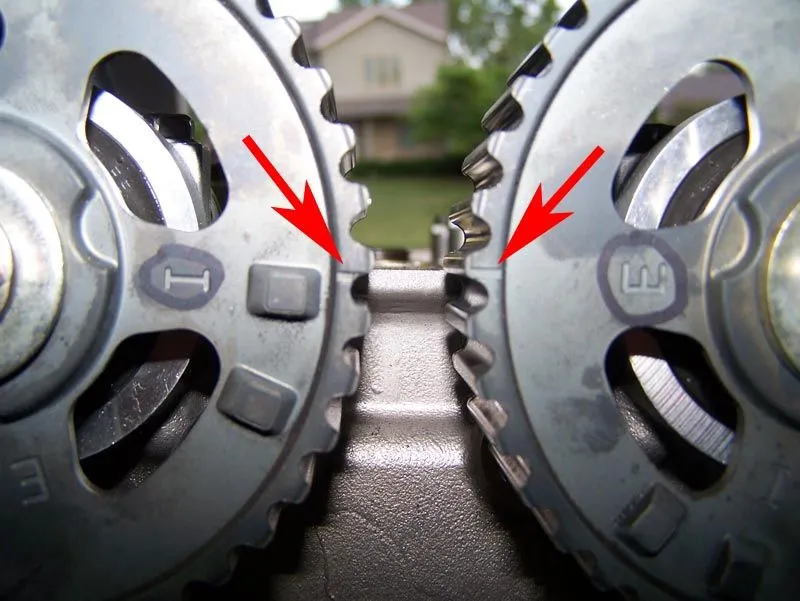

And the last pic is of the cam gears, I'm sure i'm right on this just want to double check that these are the marks that are supposed to be pointed at each other. I'm not taking any chances this time.

well if that was me I would try and contact someone about shaving the bottom of the cylinder before going balls out. if you had to I would personally break the block down to nothing, then shave it and then go get the block hot washed (dipped) to get any and I mean ANY shavings the **** out of there. now ( I know I know) is not the time to cut corners. do you really want to do this a third time???
if you ask me ( ive only rebuilt these motors a couple of times) it seems that you jumped the gun on this one and all you should have done is go and get another battery first before going this far..... sorry but it looks fine to me, gots clearance fer the sqirters, rods, pistion skirts, "cylinder skirts". cant amagin that forged goodies flex that much at 7.5K and under.
waits to be corrected........
Igdrasil has been pretty knowledgable, so i'm hoping he'll chime in again. Kooldino have any opinions? And I agree about breaking down the block. Thats why i want to be sure that it has to be done before i do it. And hell no, I dont want to do this a third time!

Posted the link in your other thread. If the cams are off your car won't even sound right when cranking. Hopefully he set up your head properly (valve clearances, etc) or you might be in for a world of trouble...
timming is correct. if you never messed with the head other than taking it off it should be fine. Most cams bought for this car are fine with stock clerances, unless its one of those custom GB crap cams.
