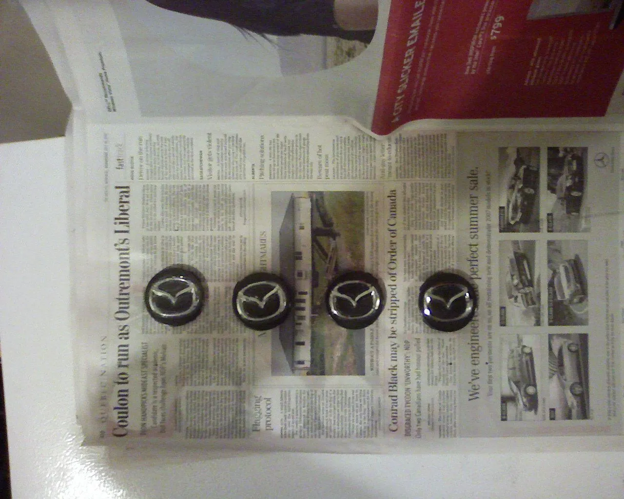

Here is the progress report:
- Sanded down 2 rims, only 2 left to go.
-Taped up the logos for the center of the rims and painted them.
Here is an attached pic of them painted:

Alright. Rims turned out looking great. I will post pics of them mounted on the car tomorrow sometime in the morning. Stay tuned!
Matt
