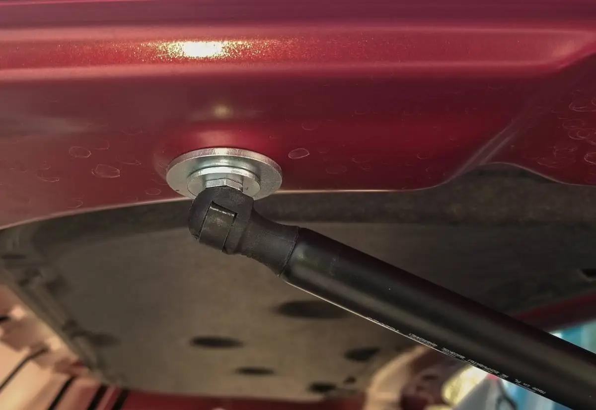

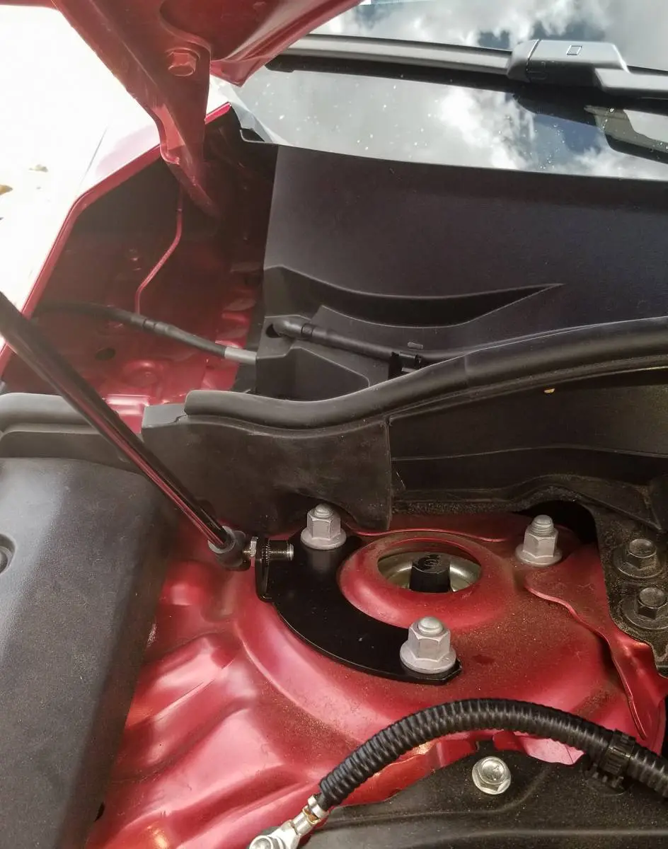

Just installed my new hood struts that arrived Thursday from Russia. The kit was recommended by @Sushi-N-Sake on this thread. Looks like the kit is slightly different for my 2019 as it required no cutting of rubber.
First part was super easy, requiring the install of two plates into which are screwed the mounting points. Just had to loosen two bolts around the strut, slide the plate underneath and tighten again. The left side plate is shown in the image below.
Then, the hard part, installing the mounting points in the hood. A long angled wrench is included which is designed to hold a rectangular nut which is held inside the hood by the provided wrench using a little tension on the rectangular nut. First one went on easily, but on the second side, the nut fell out of the wrench and tumbled down inside the hood to the bottom of the open hood near the windshield. About 20 minutes later with the help of a coat hanger, a small magnet and some electrical tape to hold the two together, I was able to fish around thru the hole closest to where the nut fell and snagged the nut with the magnet.
The second time, I put some tape of the edges of the nut and onto the wrench so the nut wouldn't fall out until I tugged on the wrench. Easy peasy this time. Right side hood mount shown in the next image.

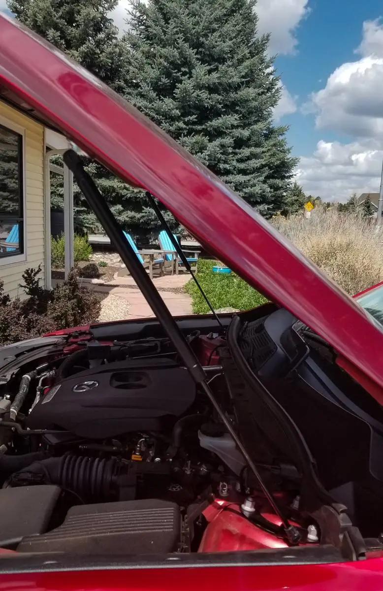

Both installed struts shown in the next image. Hood is super easy to open and will go on its own after the first 30-40% or so. Easy to pull down with two fingers. This is a nicely made kit.
It took about 3-4 weeks to arrive.

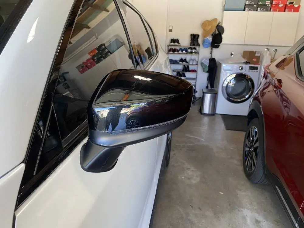

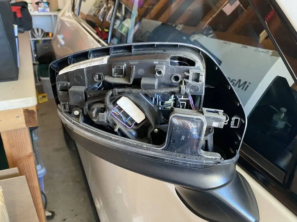

Removed and replaced my mirror caps with Mazda oem black mirror caps.
Very nice. How hard were they to remove and replace? And if you don't mind me asking where did you get the oem caps from? I've been wanting to do the same for a while now.

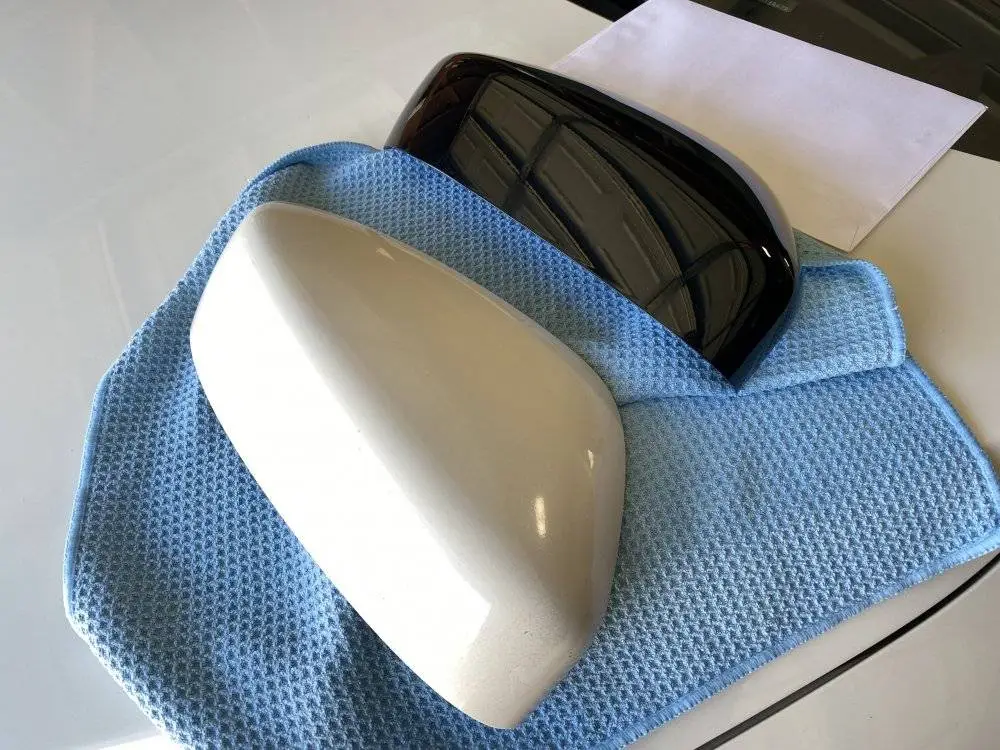

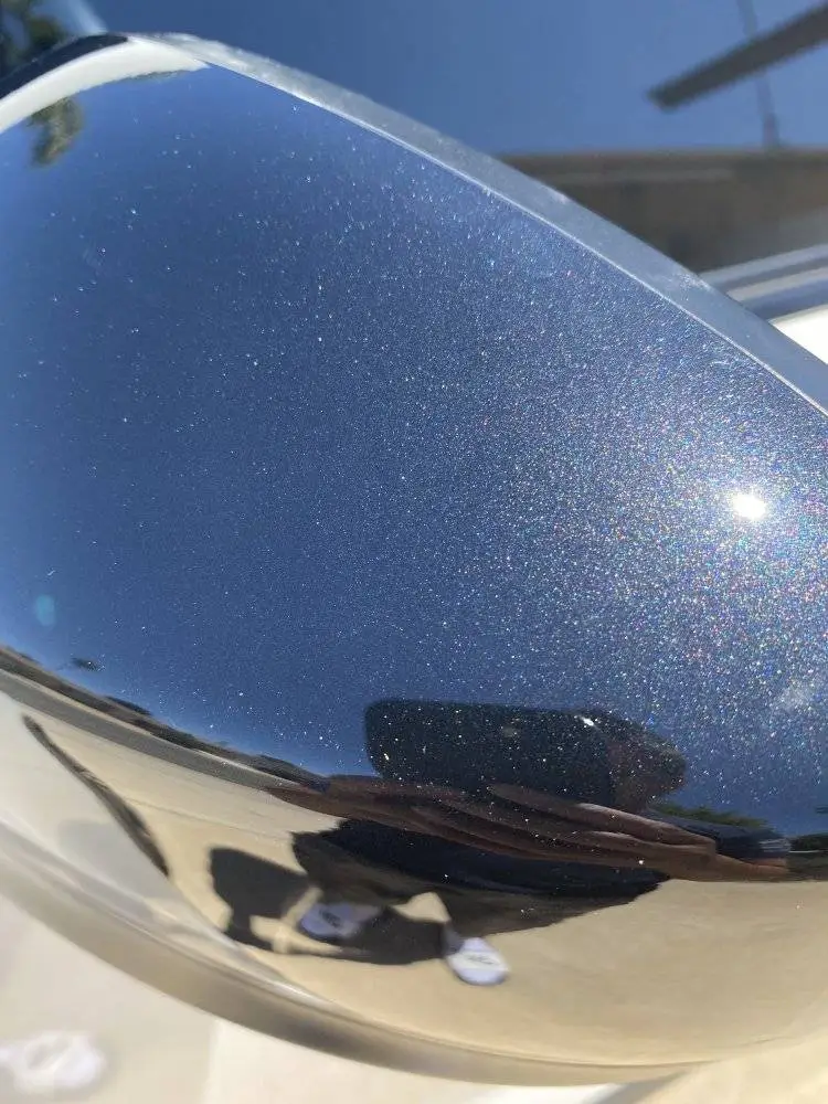

Added oem black mirror caps to my white 17. These are not just plain black. They match the black oem paint so there are metallic flakes in it. Just popped off the old cap and slapped these in. Took 10 minutes.
to remove them i used plastic panel removal tools.
https://www.amazon.com (commissions earned)
i used this youtube video.

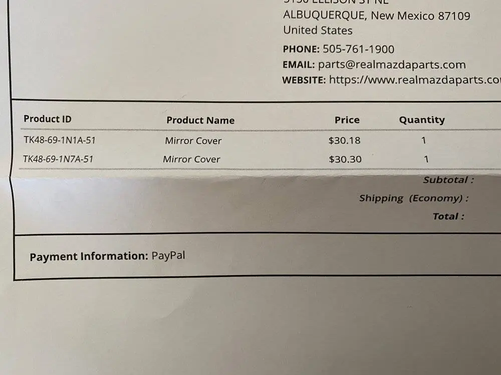

part numbers in receipt.
