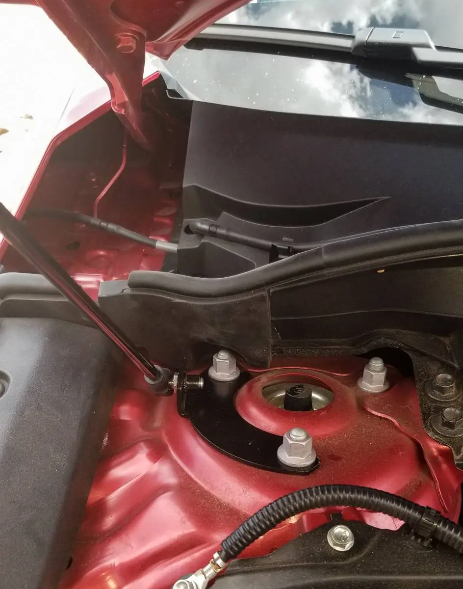

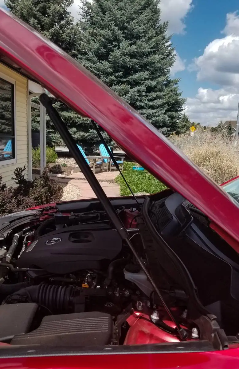

Just installed my new hood struts that arrived Thursday from Russia. The kit was recommended by @Sushi-N-Sake on this thread. Looks like the kit is slightly different for my 2019 as it required no cutting of rubber.
First part was super easy, requiring the install of two plates into which are screwed the mounting points. Just had to loosen two bolts around the strut, slide the plate underneath and tighten again. The left side plate is shown in the image below.

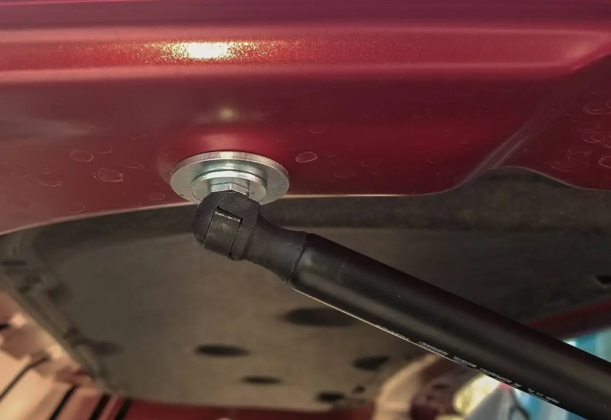

Then, the hard part, installing the mounting points in the hood. A long angled wrench is included which is designed to hold a rectangular nut which is held inside the hood by the provided wrench using a little tension on the rectangular nut. First one went on easily, but on the second side, the nut fell out of the wrench and tumbled down inside the hood to the bottom of the open hood near the windshield. About 20 minutes later with the help of a coat hanger, a small magnet and some electrical tape to hold the two together, I was able to fish around thru the hole closest to where the nut fell and snagged the nut with the magnet.
The second time, I put some tape of the edges of the nut and onto the wrench so the nut wouldn't fall out until I tugged on the wrench. Easy peasy this time. Right side hood mount shown in the next image.
Both installed struts shown in the next image. Hood is super easy to open and will go on its own after the first 30-40% or so. Easy to pull down with two fingers. This is a nicely made kit.
It took about 3-4 weeks to arrive.
Then, the hard part, installing the mounting points in the hood. A long angled wrench is included which is designed to hold a rectangular nut which is held inside the hood by the provided wrench using a little tension on the rectangular bold. First one went on easily, but on the second side, the nut fell out of the wrench and tumbled down inside the hood to the bottom of the open hood near the windshield. About 20 minutes later with the help of a coat hanger, a small magnet and some electrical tape to hold the two together, I was able to fish around thru the hole closest to where the nut fell and snagged the nut with the magnet.

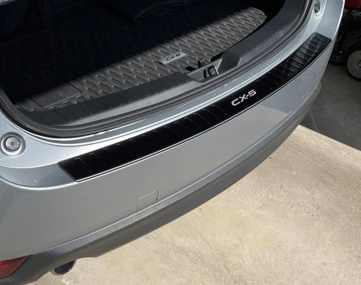

I really like the trim on the rear hatch and on the bumper. They look good on your CX-5. Is the trim either side of the Mazda emblem plastic or metal? Where did you get them? Can you provide a link to the seller?
Thanks, I got the upper trim on Amazon and the bumper trim is Mazda OEM.
I have the same trim on mine - it's chromed plastic. I got mine from eBay for $15, but the same vendor has doubled the price now (!): https://www.ebay.com/itm/122680679987

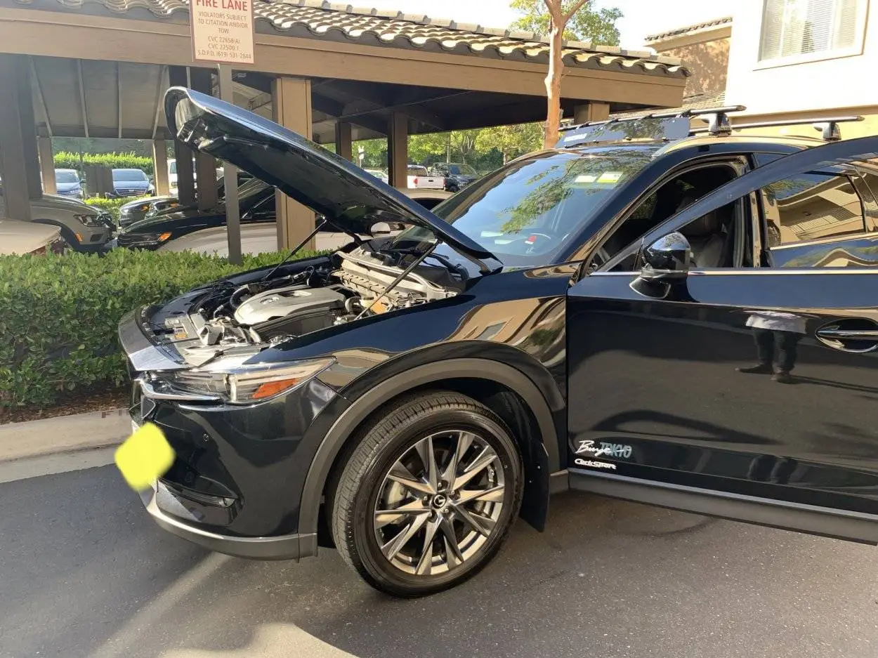

From Amazon, High Flying Hood Struts!
As per review recommendations, I "exercised" one strut before installing the second strut. All works fantastic!

Do you think the trim pieces will stay on? Was their curvature close to that of the rear hatch?
They've been on mine for about 6 months now without issue. They were curved, though not quite as much as the hatch (maybe 1/4 inch gap at the tip IIRC) but it didn't take much effort to push down when sticking them on.
Thanks, I might order the trim for my car. They do make the back look less plain.

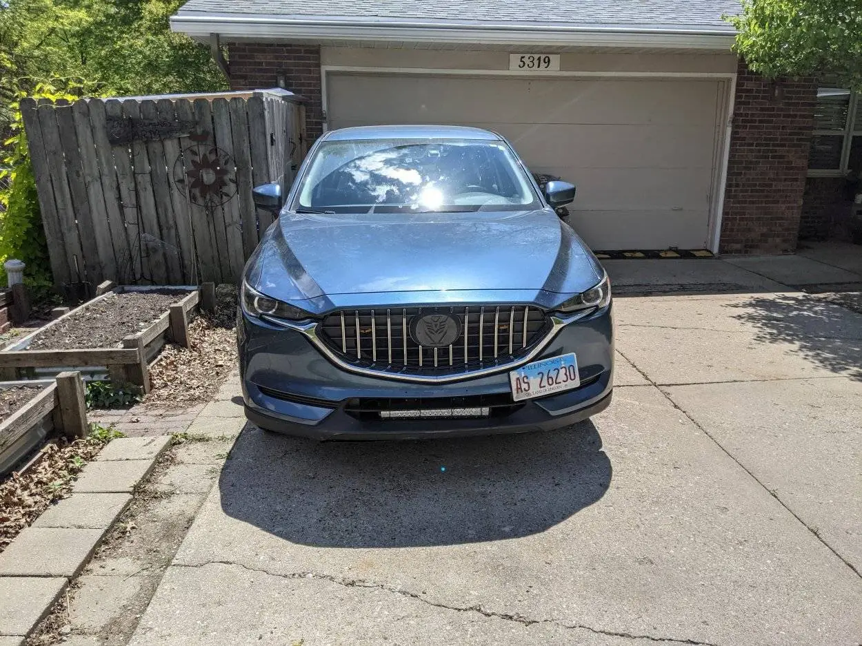

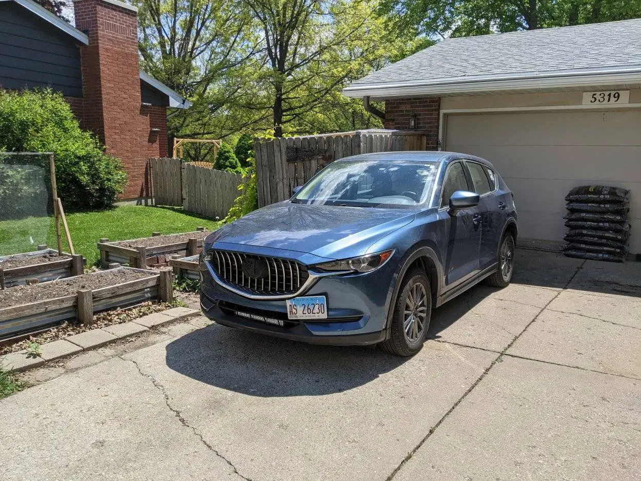

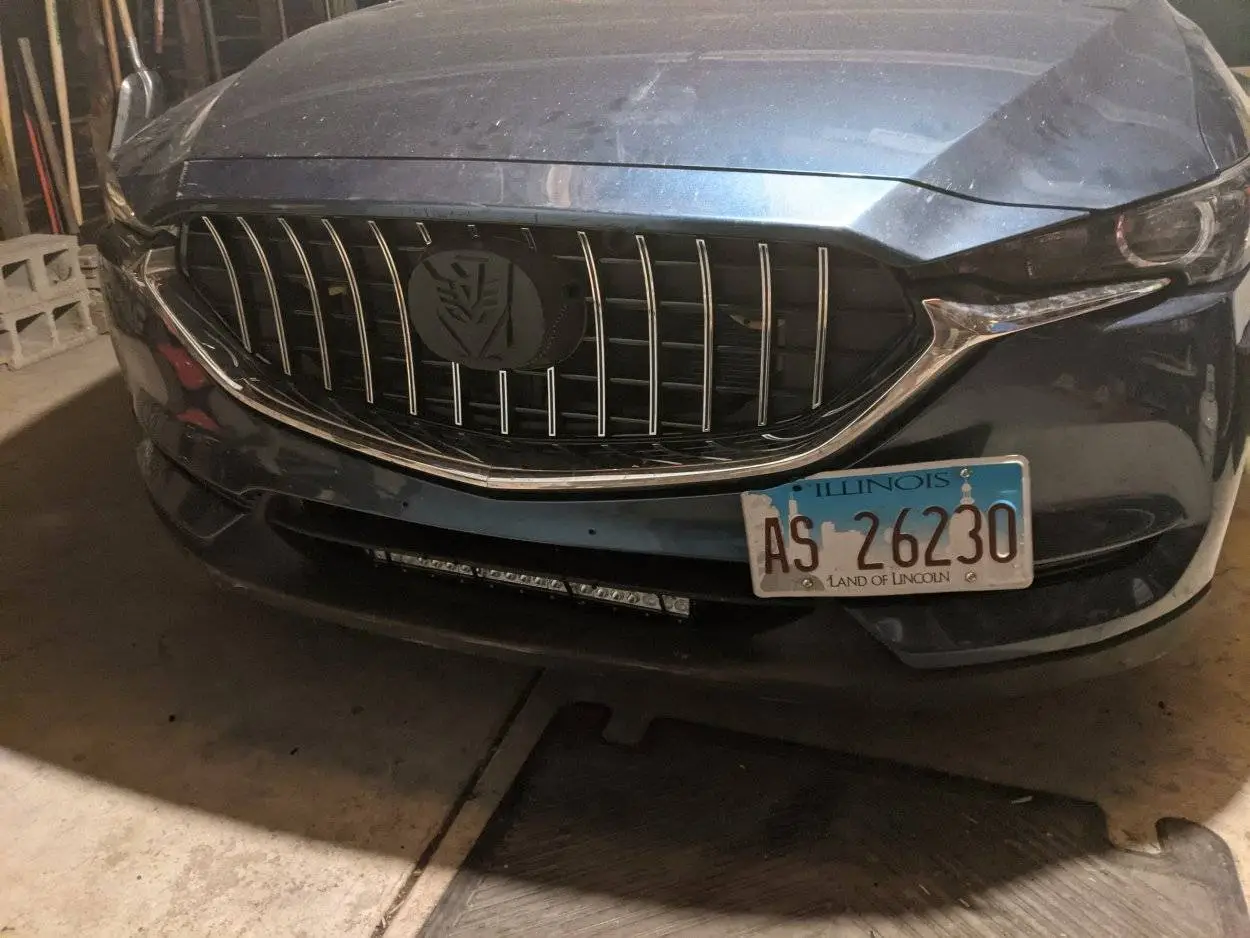

Installed my new aftermarket grill yesterday.
It would look WAY better without that front license plate!
I'm also in Illinois and have been driving without a front plate on any of my cars since 1985. The only issue was when I got warned about no front plate in a written warning left on my Grand Prix in a parking lot in Elgin. That was over 15 years ago.
YMMV
EDIT: I most certainly didn't have a CX 15 years ago. I meant to type GP and typed CX by habit.
