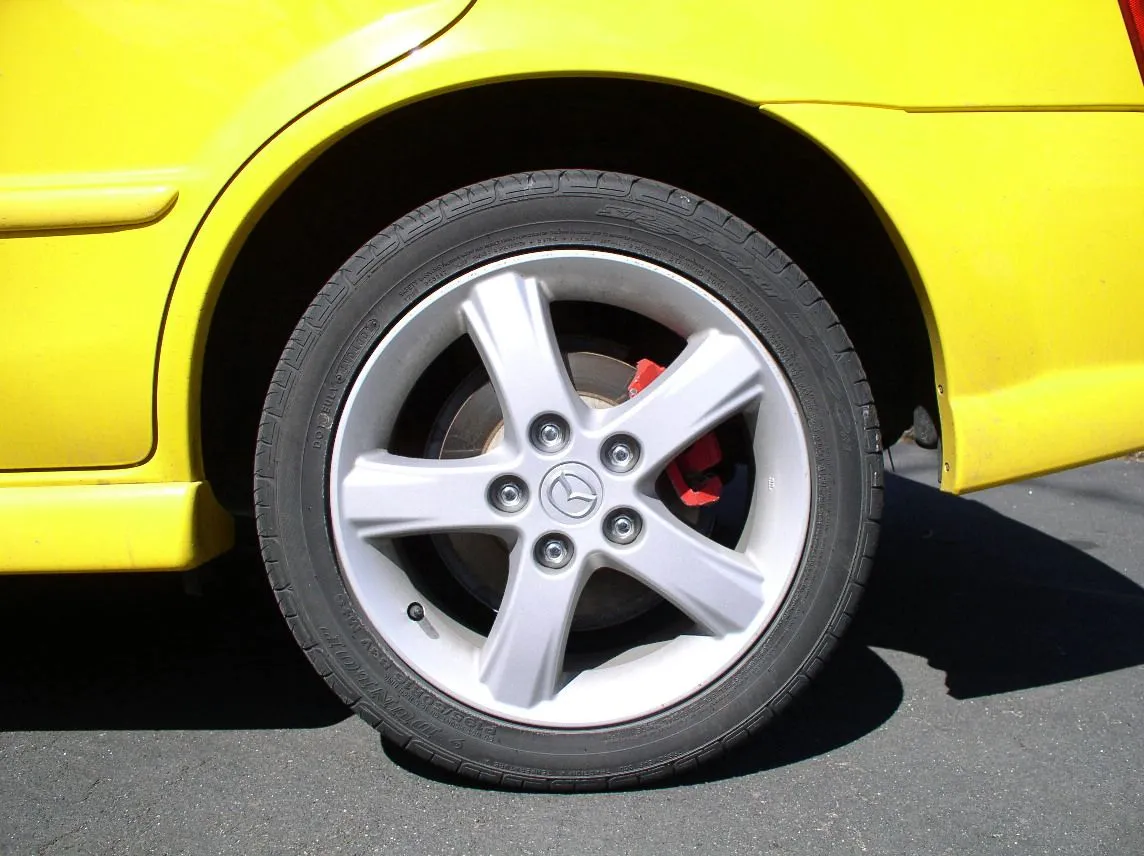

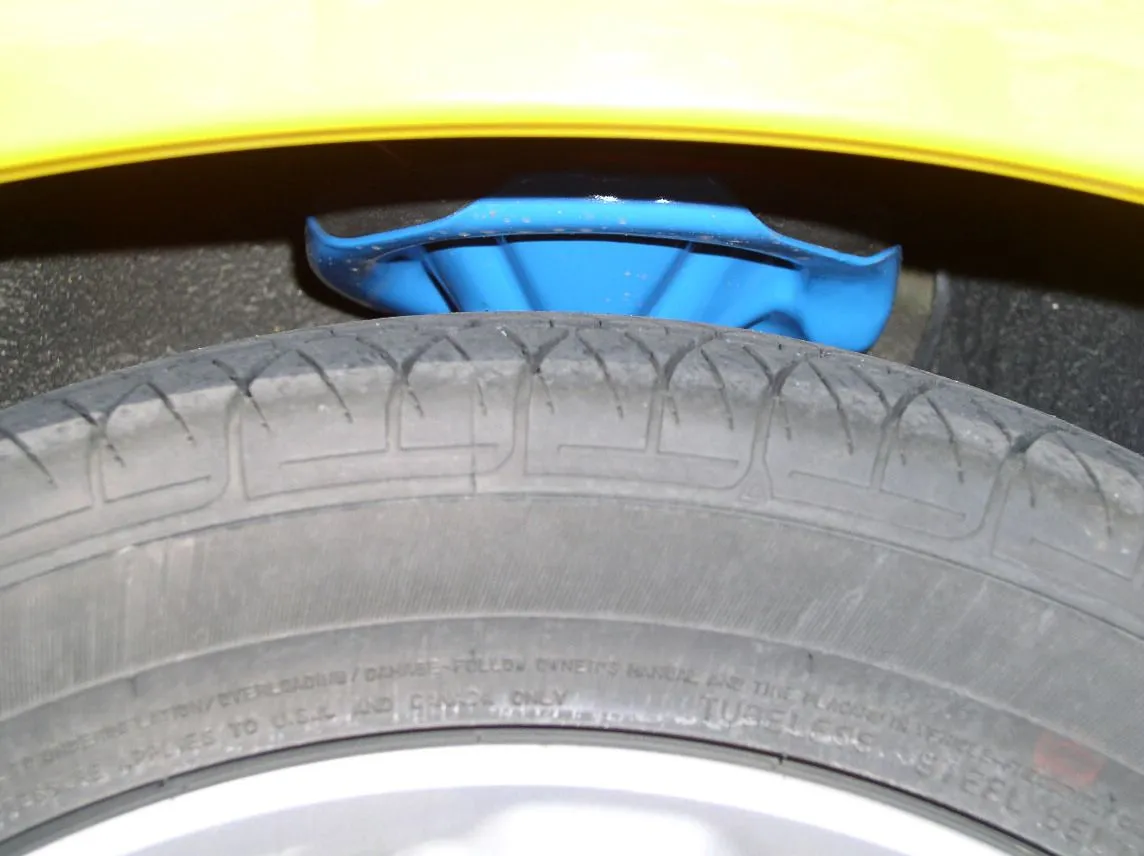

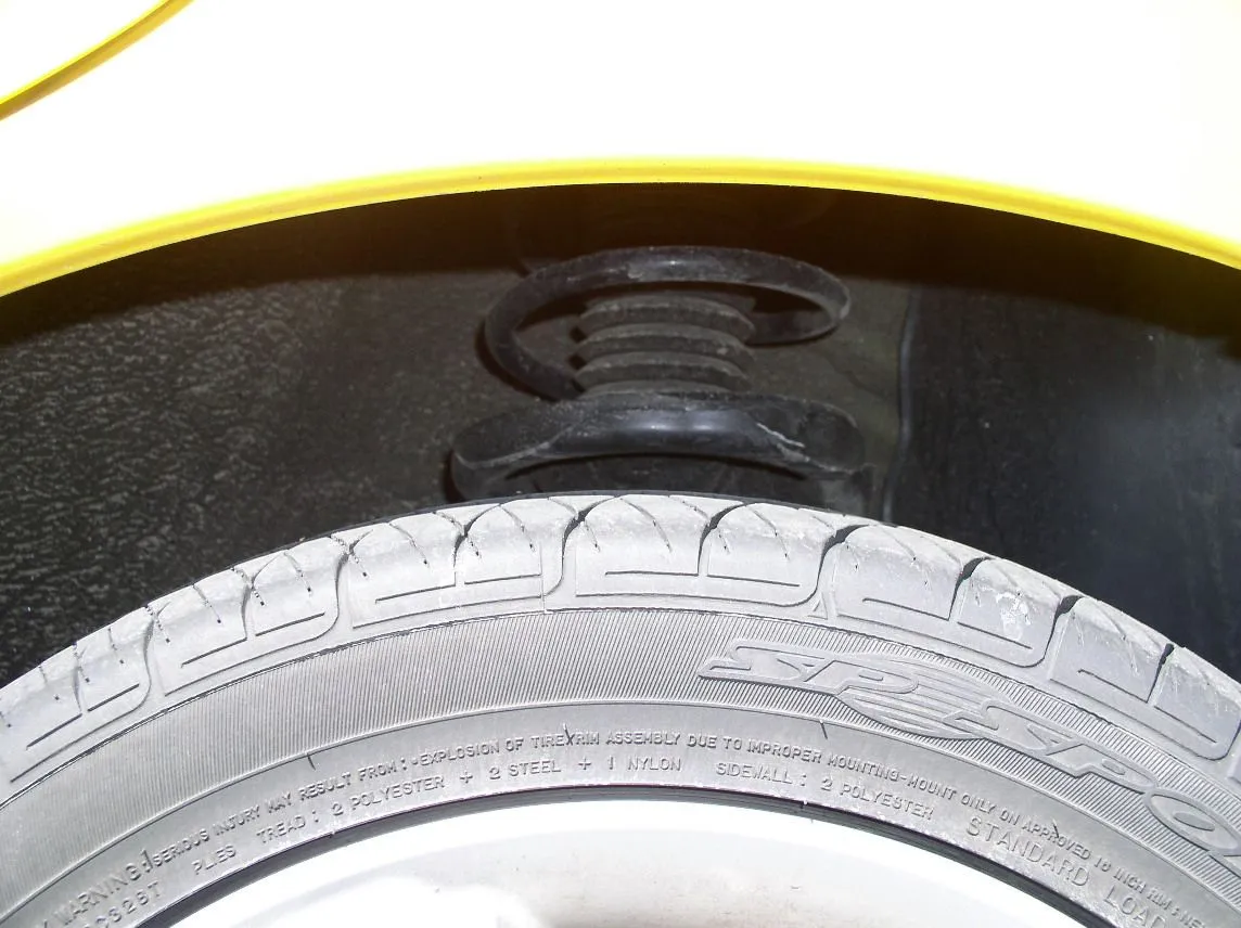

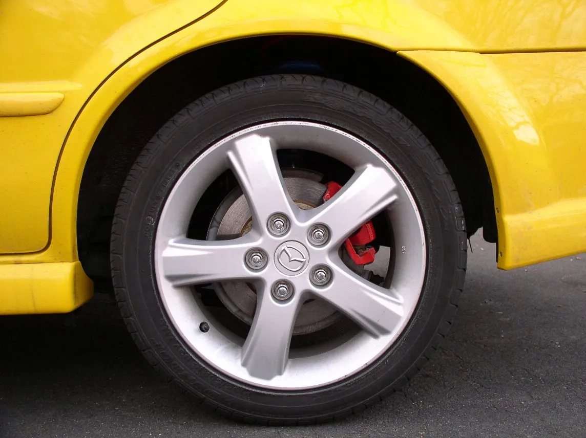

I just installed both the Racing Beat springs and Tokico HP's on my P5 the other day and snapped some before and after results. This for those of you who are wondering how much of a drop you get with these springs. These are factory direct P5 springs, not the ones off a MP3 or MSP. According to my measurements, my wheel gap went form 2.25" all around to ~ 1.25" rear, ~1.5" front. I now have about a 2 finger gap in back and about a 3 finger gap up front.
As for the handling, well it is harsh, but I'll take it. There is considerably less body roll then before and the ass end doesn't sit down as much during a launch.
I took me about 6 hours to do the whole car...and i swear one hour at least just to get the f'ing end link bolts off just on the rear(notcool) Can't complain though, cause Matt at Racingextreme hooksed my up real tight.
I rented spring compressors and didn't need them...waste of time and $10. For spring install tips, just pm me and maybe i can help...
Peace
Here are the pics...

looks great, how is it harsh?

Well let's just say it rides more like a vette now than a caddy.

Works for me as a daily commuter. If I went any lower around here in the winter I would have to put a plow on the biotch...a stock pro only has about 6" clearence to work with...I mean have you ever behind one of our cars on the street....she is a squater!!!
Btw i planned for that wheel gap because i'll need it when i get 18's (burnout)
