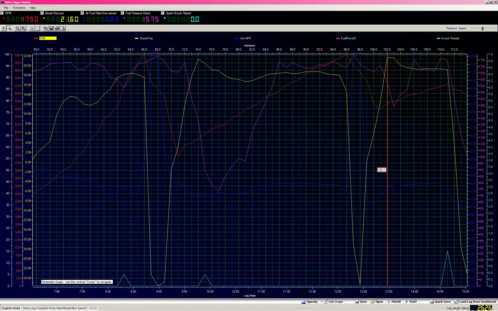

the first log shows a 1-2-3 pull. i had to pedal it in first and some in second because of the temps. i was having traction issues in all gears.

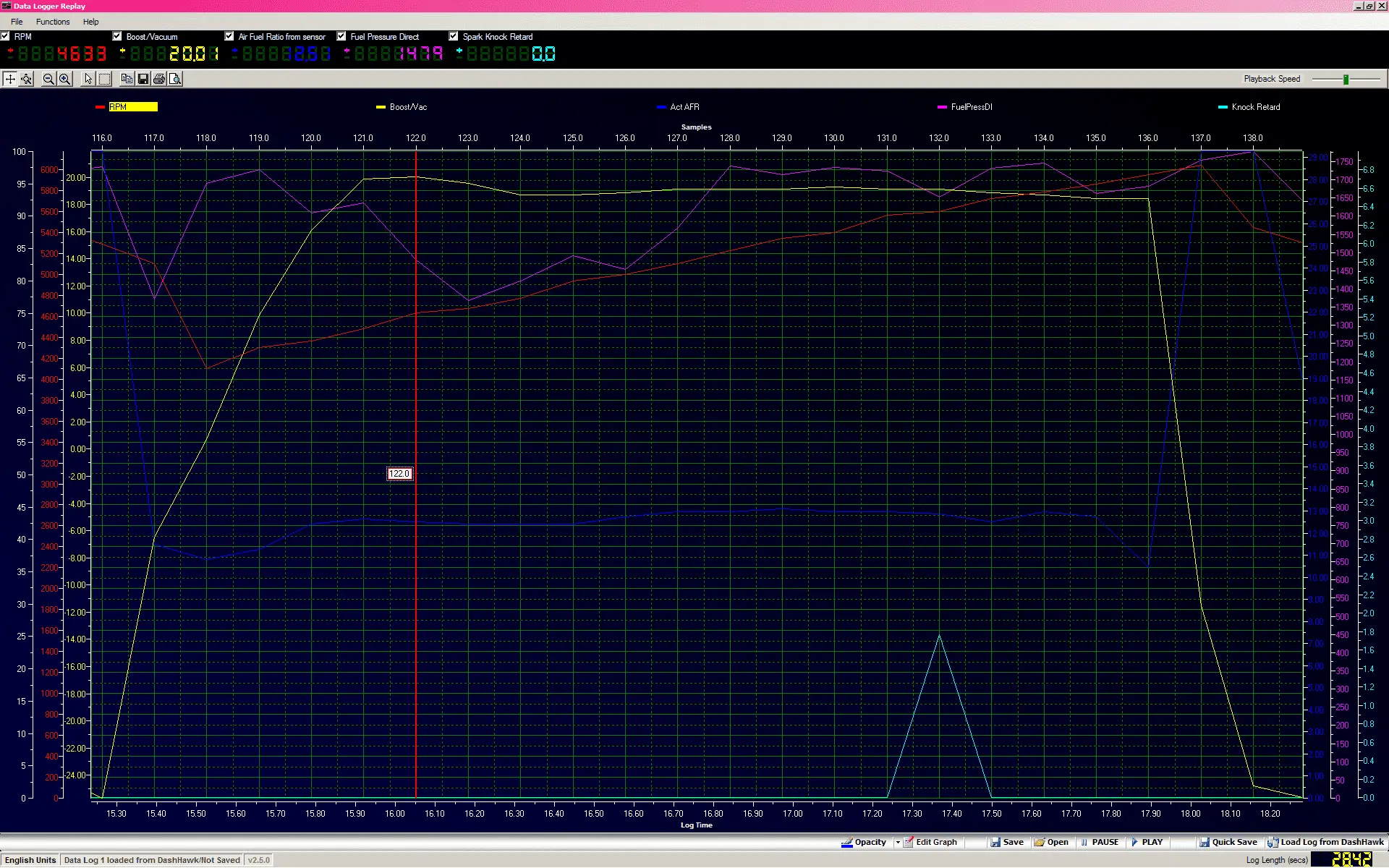

the second log shows 1-2-3-4. same story, but 4th had no traction issues and i stayed in it for as long as i could without getting nuts on a back road.

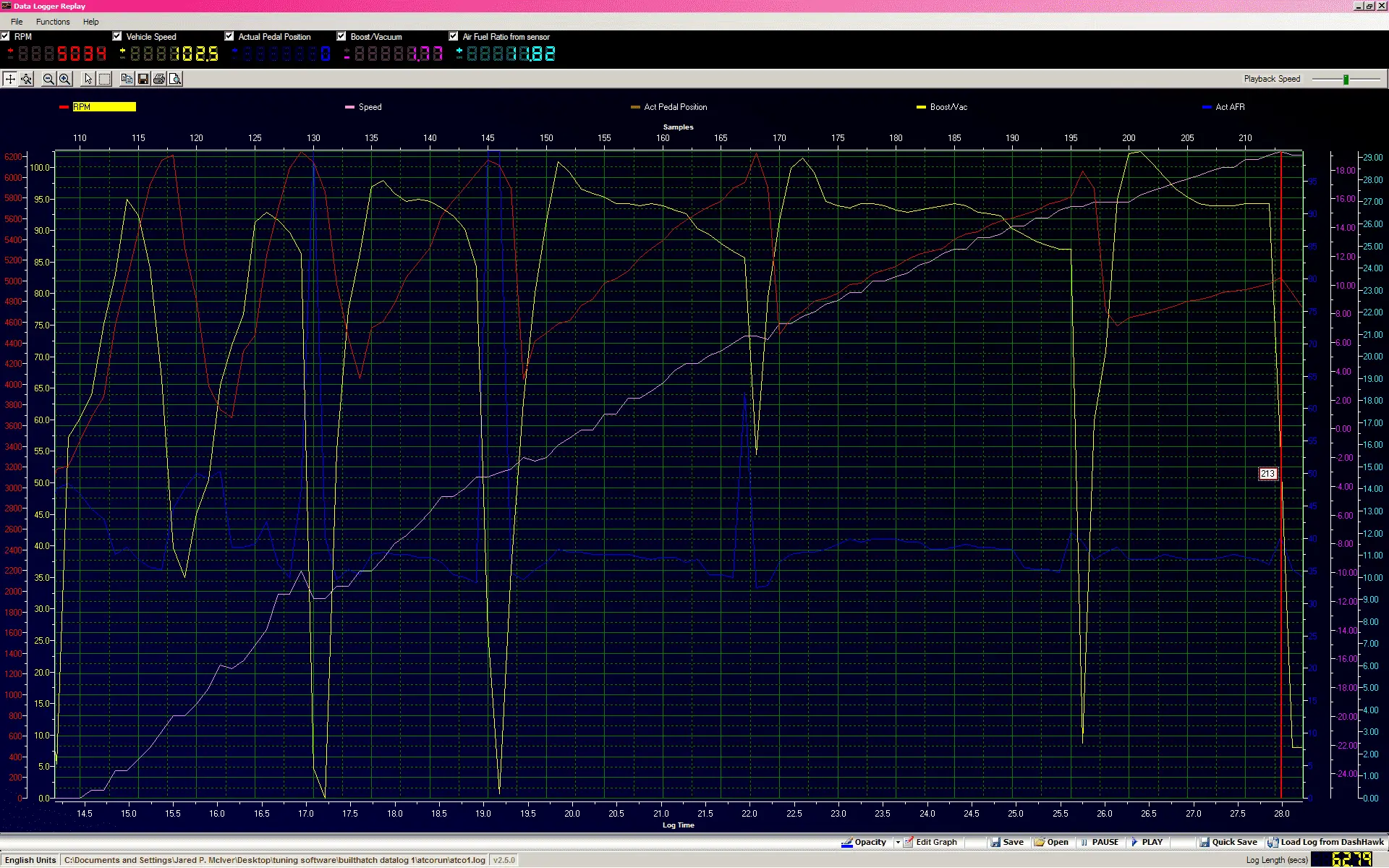

the third log is from...i dunno, the end of the spring/beginning of summer? it's a run at Atco Dragway.

Its hard to read a log with multiple gear changes, try posting some up of a 4th gear pull.
Also I thought the fuel pump was really supposed to dip below 1500psi, the fuel pump but you get some dips (quite a few) of 1000psi. But also thats hard to tell with the gear changes because we cant tell if your foot is all the way on it or not.

however, i don't have any dips like what you mention. are you looking at the purple scale? in those logs, one log shows one time dipping to 1100 and 1300, and then the other one shows 1300, then the rest of the time it's high. but for me, the main thing to worry about is the a/f. my a/f is rock steady during the times when i'm on it. you can tell when i'm on it when manifold pressure is positive and the RPM are climbing.
look for a climbing red line and a peaked then flatish yellow line...that is a gear pull.
also, i just noticed, but the atco run's colors are all out of whack, but you can figure out what is what by looking at the scales. i tried to change the c0lors to match the latest logs, but didn't change the scale colors :X
Builthatch, while I was walking back from work I had an epiphany that will make us all nod. The reason you're getting a tiny amount of spark knock in 1, 2, and slightly into 3 is because of the TMIC not getting enough air. By fourth gear there's enough air moving over it to kill any heatsoak and to reduce induction temps enough to avoid knock.
Seems obvious now.
Seems obvious now.
the only wrench in that works is the temps...ambient air temps were 14 degs...boost temps were something insanely low...40's, possibly lower.
honestly, i think it's just a feature of the tune, like, changes from open/closed loop OR something mechanical that the knock sensor 'hears'.

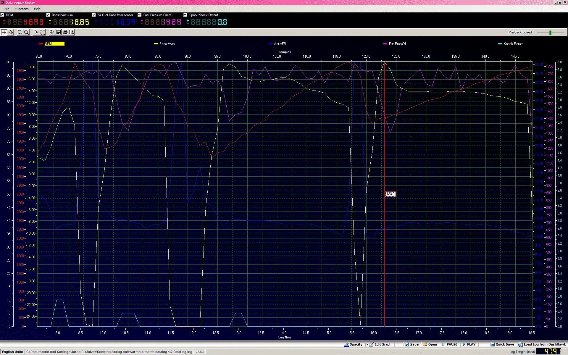

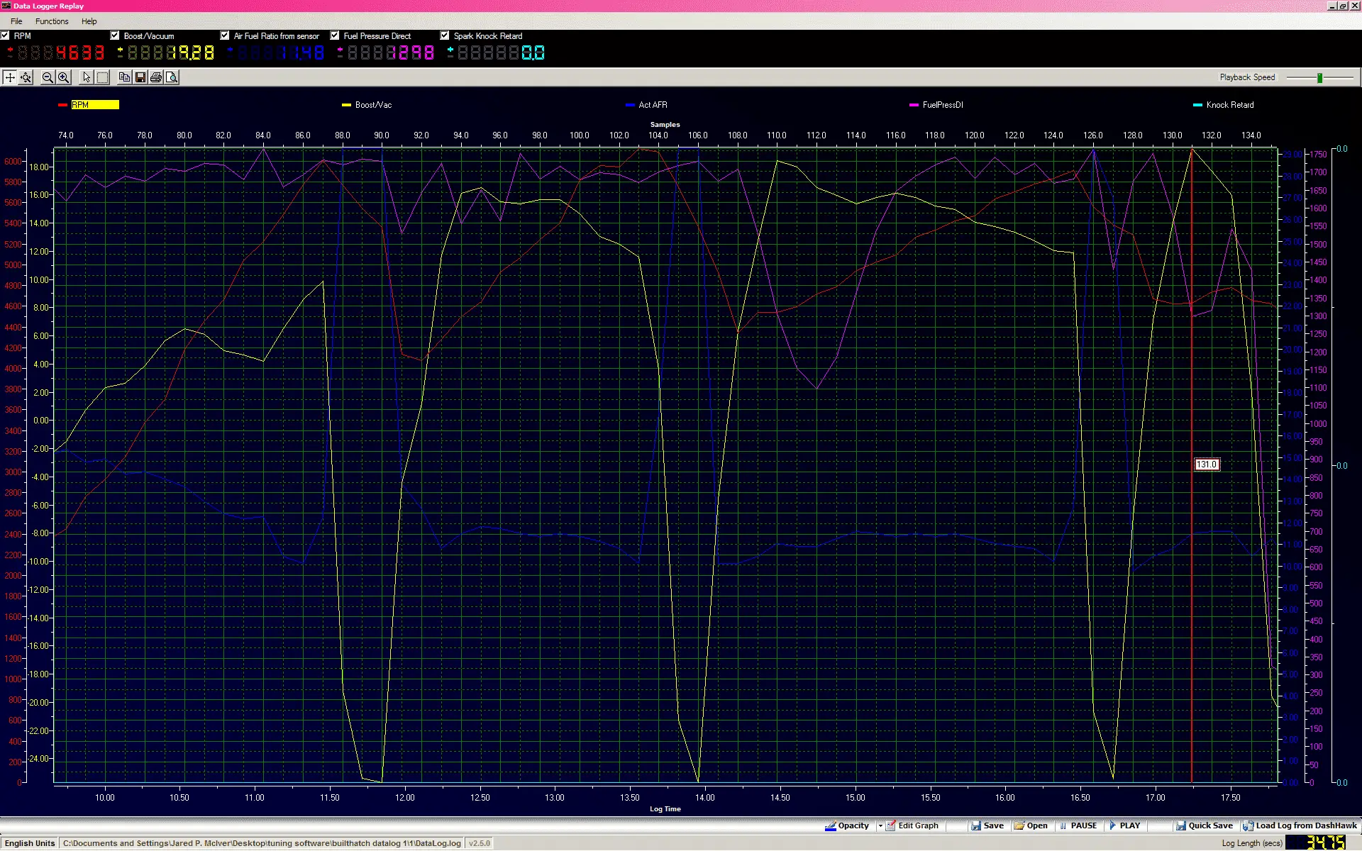

i flashed the thing tonight and put some miles on it...i put about 40 miles on it with a few key cycles, so it's probably still learning.
thing definitely holds boost higher than stock. it's wild! peep the logs. a/f are a hair leaner than stock. the one log shows a FP dip but i don't care, as long as the a/f is looking lovely. again, it's probably still adjusting.
the first log was out of a toll. the second was at my normal test spot but i could not go that fast.
yikes, you're hitting spikes of 21 holding 18...knock of 2 for some reason towards the end of fourth. No explanation for that one. Looks like the fuel pressure dips slightly when the knock occurs.
