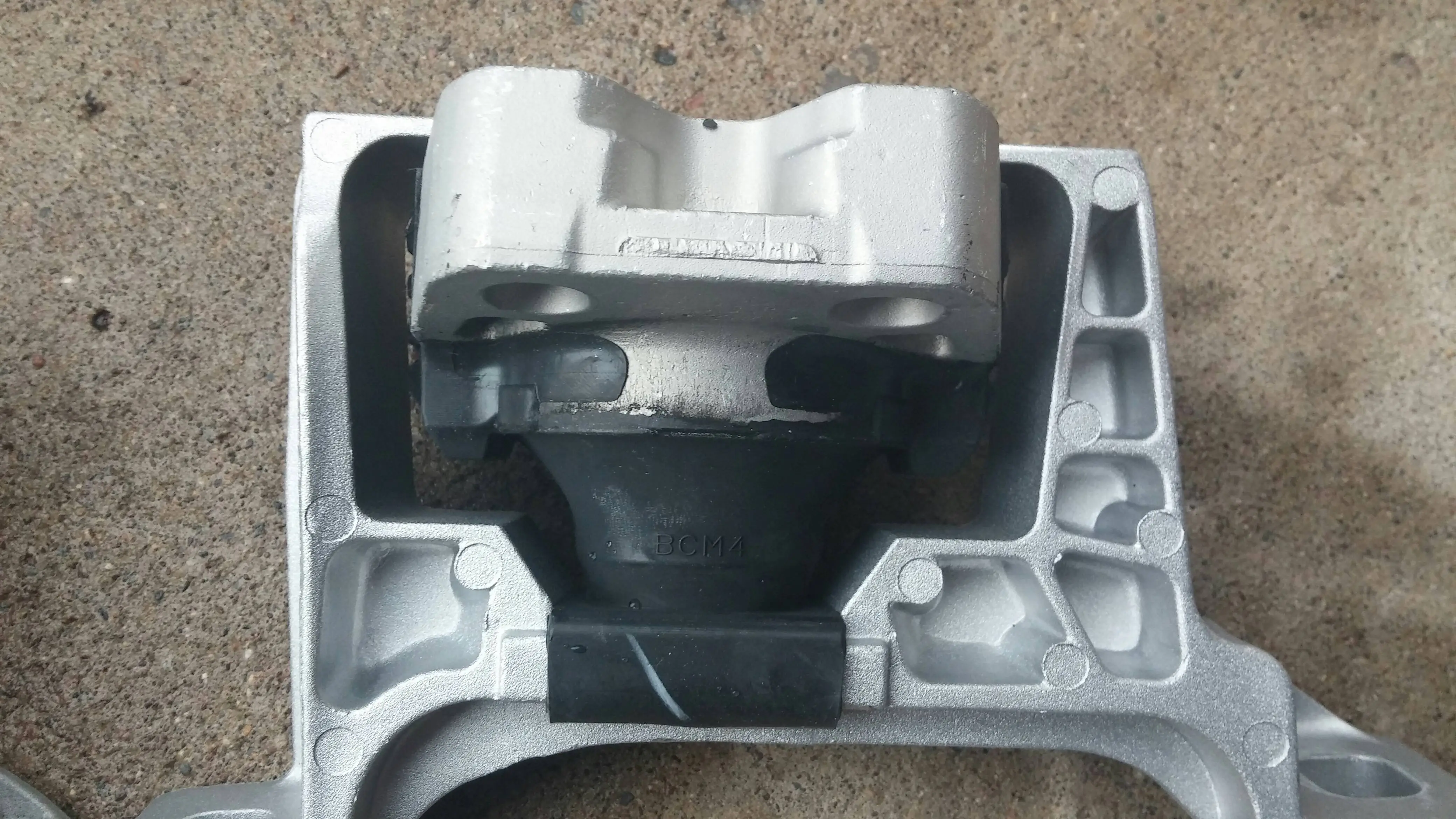

Picture day
Is that the famous E-Focus mount? Did it ever smooth out at idle for you? There is noticeably more rubber in that mount than the one next to it in your comparo photo... I am so conflicted about doing mine due to the expense. On the one hand it should be done before the dead mounts cause some other thing to fail. But on the other hand, I don't have three hundred or so bucks laying around, and mine really isn't that rough at idle yet....
No, that is the #3 by the belts. The eFocus mount would be similar to the ones in the 1st video of post #21.

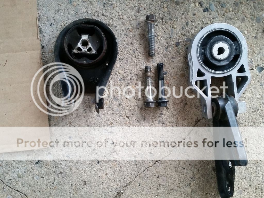

Uploaded the RMM pic above. Note, the threading for the horizontal bolt is different, reuse vertical bolt.
There should be no conflict. IMO, tackling the motor mounts should be a 3 step process. Do the PMM first @ <$100 and takes 30mins? You will love driving it again. This is 99.99% likely the first to fail. I'm positive a lot of folks are broken but they just don't realize it b/c they are use to it and accept it as the norm. Do the RMM if you are a "no wheel hop and instant power to ground" fan but trade-off is slightly more vibration. The TMM is last recourse since it does involve removing a bunch of stuff to get to. My RMM and TMM looked OK. Vibs settled down a little bit can still "feel" it.

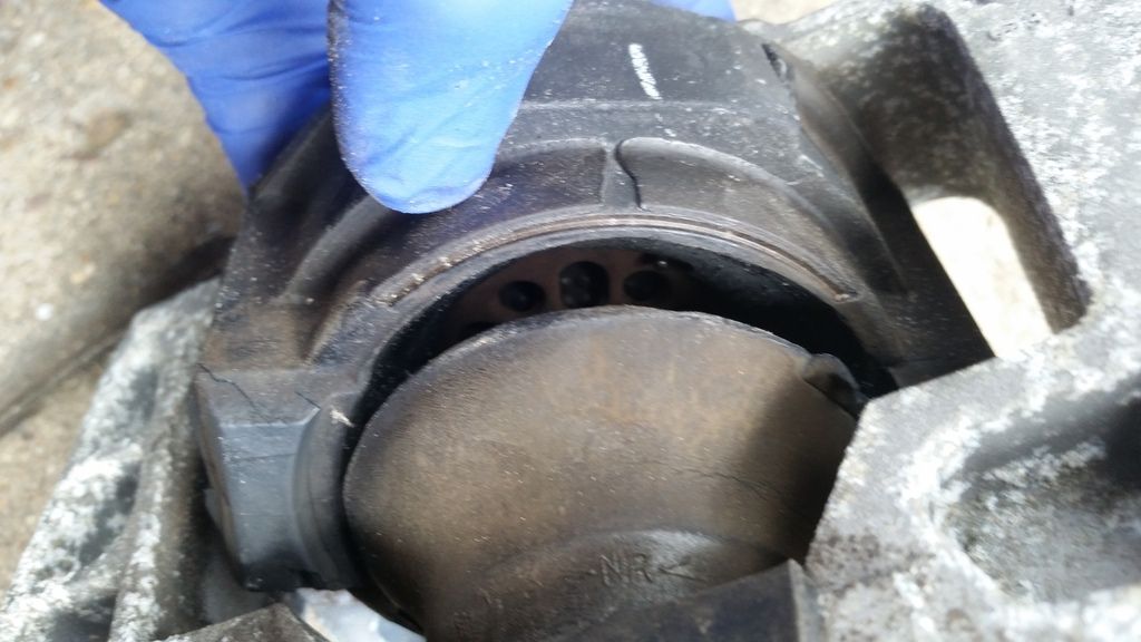

The PMM, not so much. (No, it is not suppose to be like that. It should be enclosed)

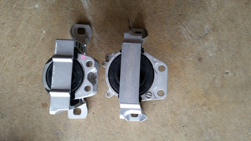

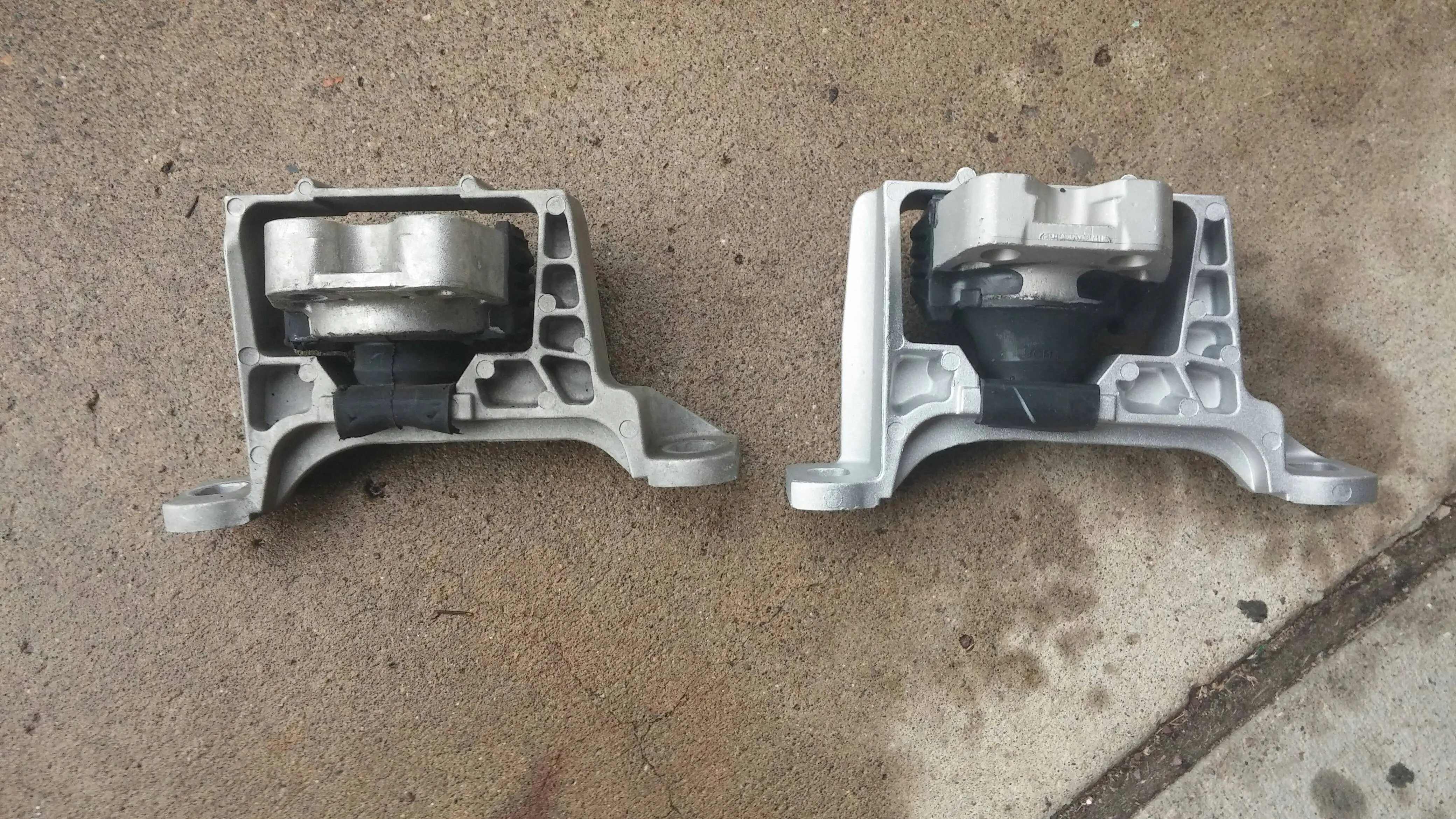

So why do they look different. Is the one on the left OEM and the right one aftermarket?
Both OEM. See post #13. Transitive theory WIN ;)
I can only say this is technically NOT RECOMMENDED, is bigger, is stiffer by ~3-4 times, cost LESS, has 3-4 revisions, and you can add a counter balance weight (MS3's PMM comes with this and why it cost 2x but our layout does not fit it without having to relocate some stuff). Otherwise fits/works perfectly.

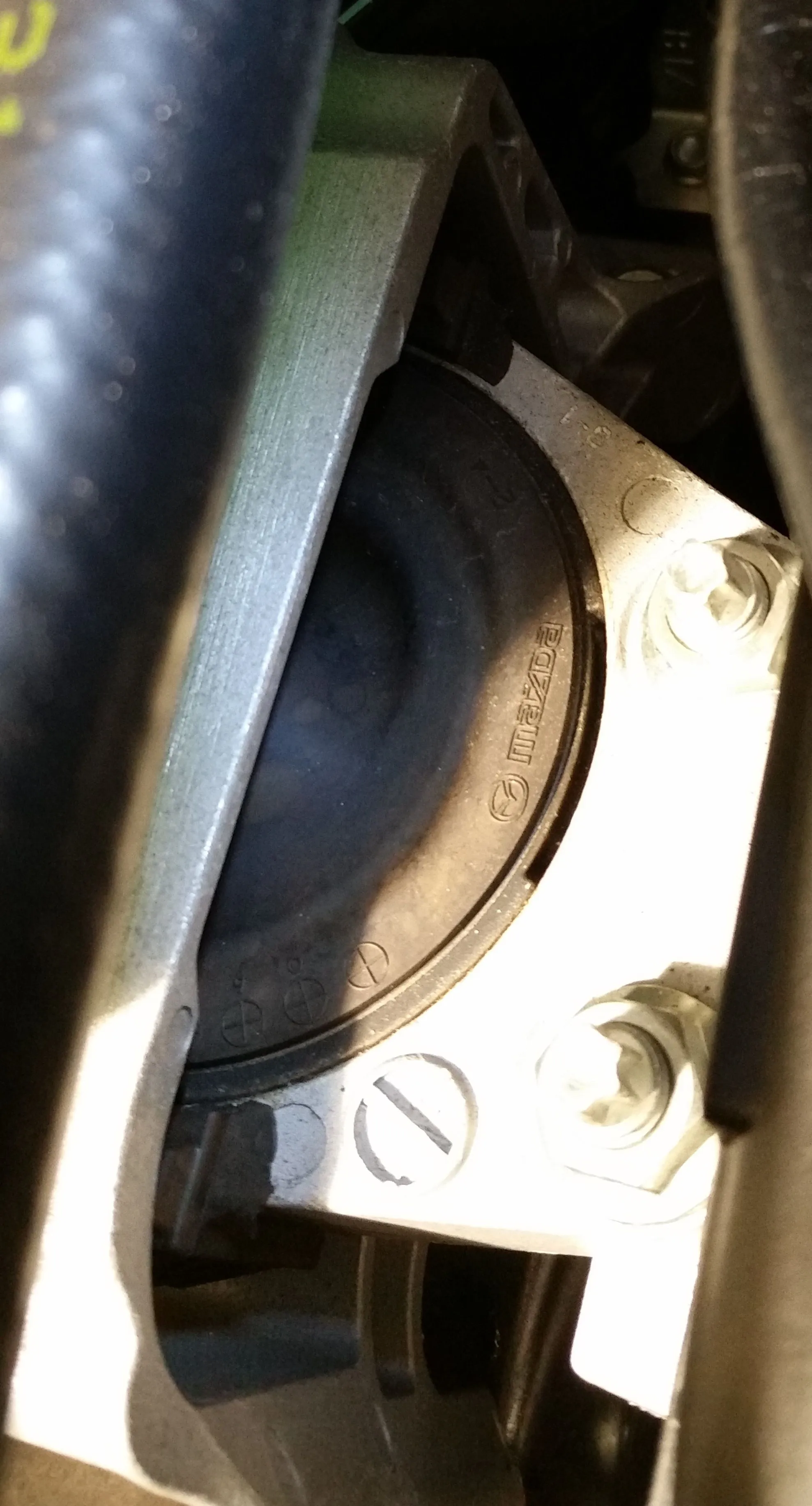

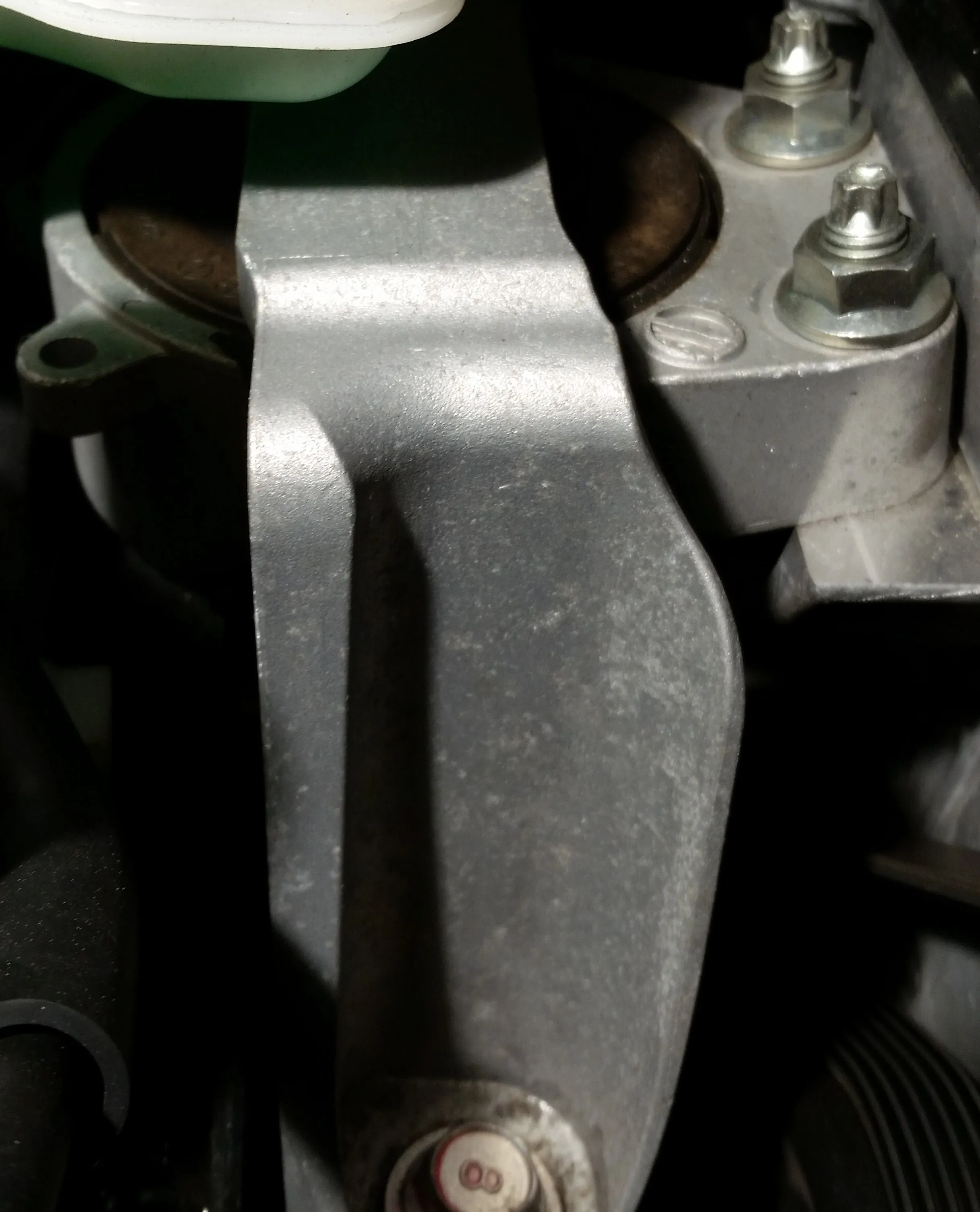

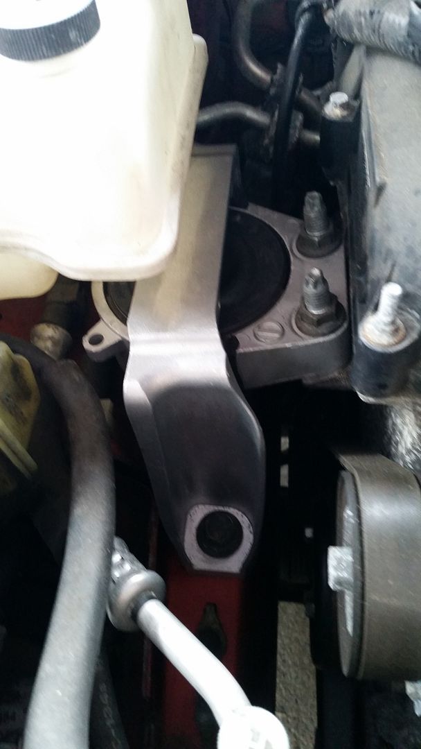

I don't have great pics here but I do have something... from my '14MY w/ 32K miles. Took them while I was "in there" while changing ATF. As far as I can tell both this and the rear mounts are in good shape at the moment.

My fault. I've only seen that larger PMM as an insert. Is that the Roca on the right?
Not the Roca. It is OEM.
See post #13 and #28. I prefer folks to understand "why" instead of doing it just b/c some internet says so. Few posts above even offers a suggested part number.
I re-read a few more times and I see this now. So the pic above is two OEM mounts
Left is P/N BCM439060D
Fits the following models:
Mazda 3, 2004-2009
Mazda 5, 2006-2010
Right is P/N BBN339060A
Mazda 3, 2010-2013
Mazda 5, 2012-2013
But what your saying is you put the newer mount in your '08 and it fit?
Swenny , That is correct. The newer mount BBN339060A will work in the older 5's. I have a 09 that I just did this to a few weeks ago.

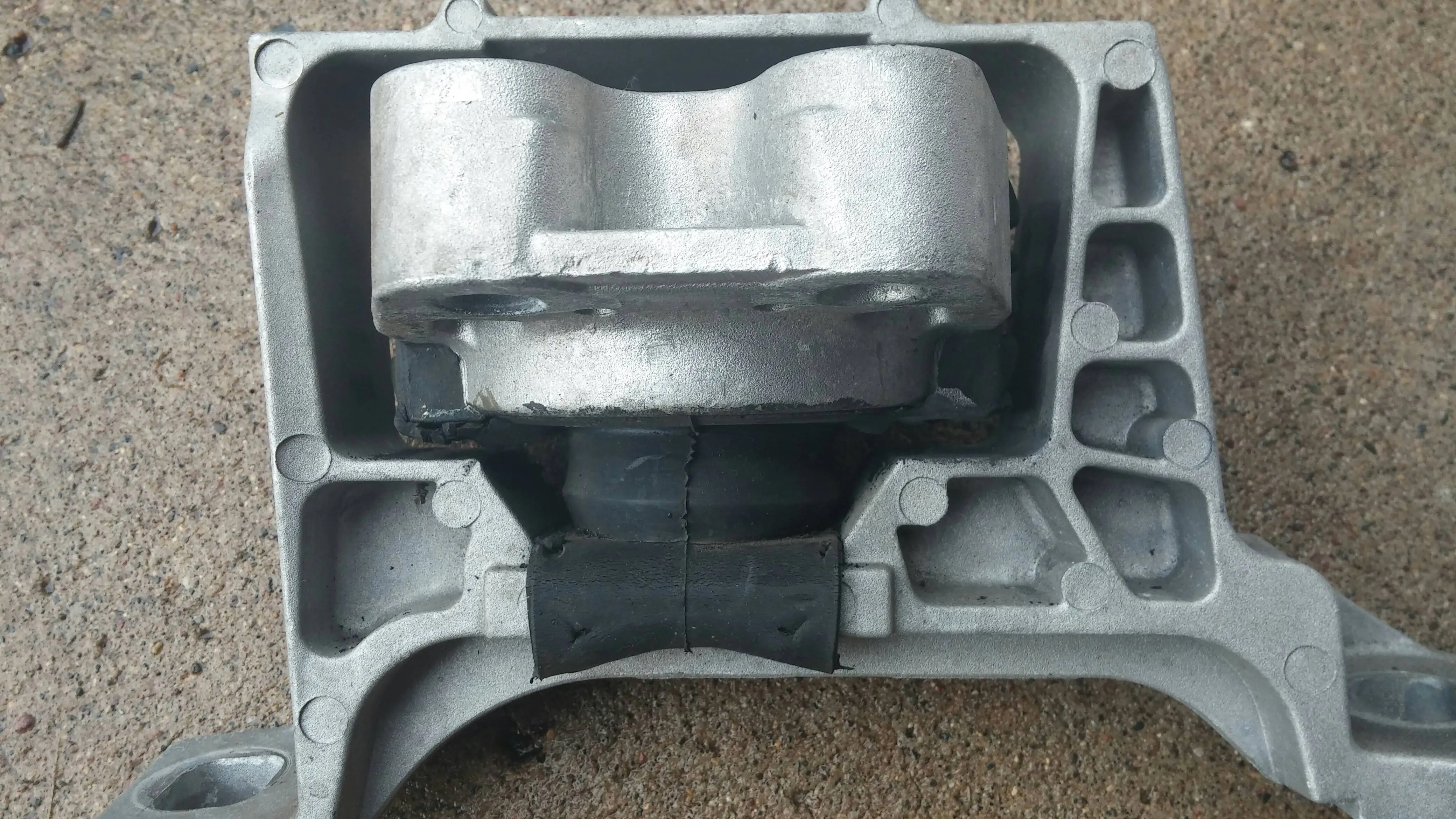

Disappointed in the DEA mount that only lasted about 15 months though. Here's some pics
Old one on the left: 20160206_152952.webp
Old one: 20160206_153016.webp
New one: 20160206_153022.webp
