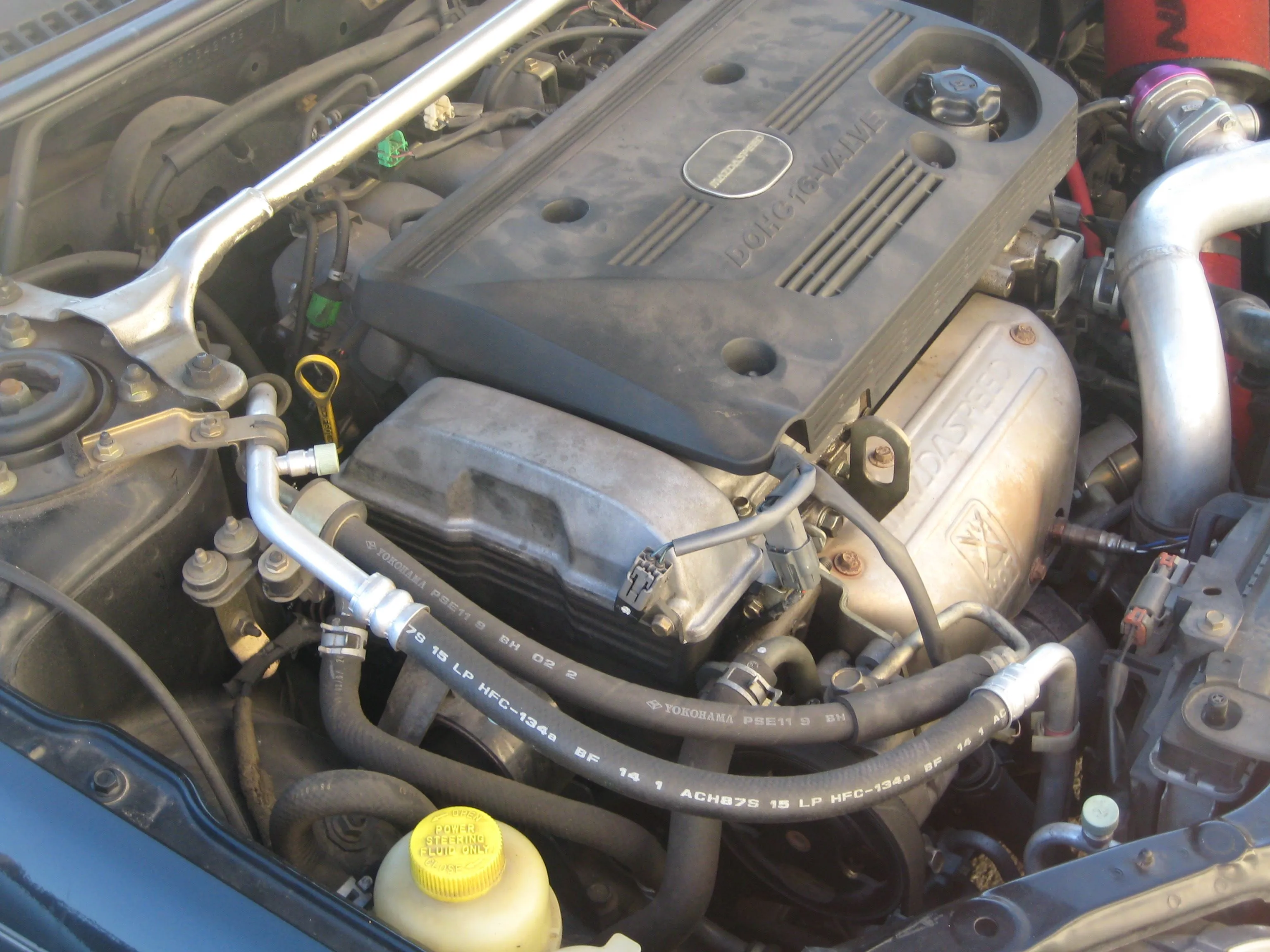

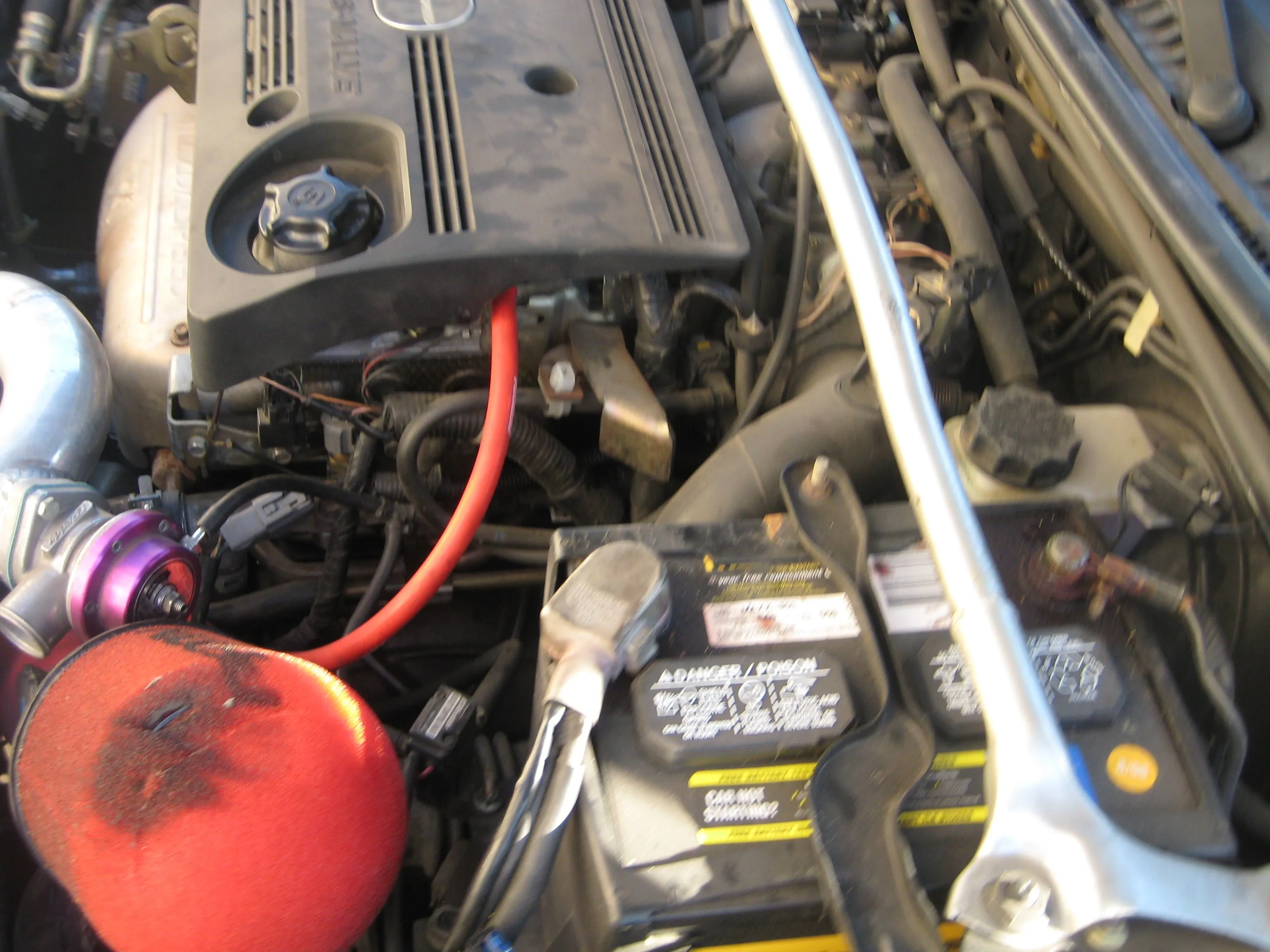

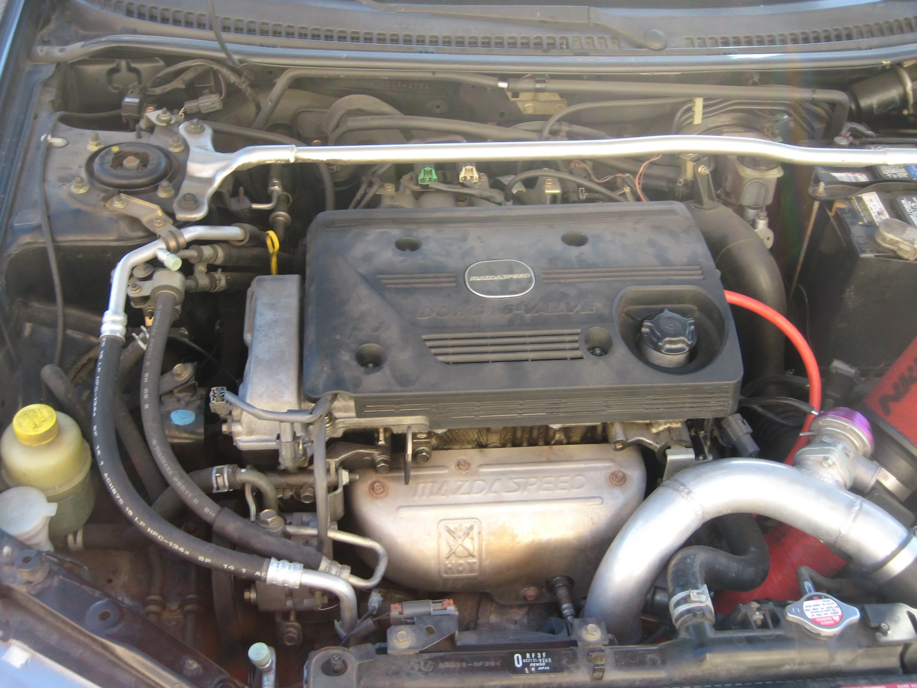

The current mods on the car are Vibrant Turbo Back Exhaust, Perrin Intake, and GReddy Purple BOV. The problems that I am having are stalling issues, and when I go over 3000 rpm the car begins to jerk.
Here are some pictures of the setup in my engine. I forgot to mention there is also a GReddy Electronic boost Controller (GReddy Profec Spec II) as well
is the boost controller on stock boost settings? the jerking you feel in the upper RPM range could be a result of the stock tuned ECU. Look at getting a SSAFC, that will definitely help you out and the stalling issues you are experiencing are because of your MAF sensor being on your intake. Either relocate the sensor to your cold pipe or recirculate your blow off valve.
Where can I relocate my MAF sensor? What do you mean by recirculate a BOV? Sorry guys I'm new to this bare with me
Recirculate the BOV means making it into a BPV, you wont get the same sound as you get with one.
You will need to relocate the MAF after the BOV. Atleast 6" away from the intake mani, and atleast 6" away from the BOV. (this is all on the cold pipe, aka the Intercooler to the Intake mani)
I see you still have the stock SMIC. You have hard pipes as far as I can see.(hot pipe) what about your cold pipe, is it still the plastic pipes or is that upgraded too? If it is upgraded, you can take the MAF sensor from the intake, cut a section out of your cold pipe and put your MAF sensor there with two couplers and some clamps. That will keep you from stalling and your MAF sensor will always see a constant amount of air. Or you could take some type of hose and run it from the outlet on your BOV to a fitting on your intake at least 1" in diameter to keep the turkey away..lol. I don't know anthing about the Perrin intake. If it is anything like the Injen intake. It should have a fitting on it to recirculate. If not, you would have to get a fitting welded onto the intake pipe to recirculate. Basically, the way you have your BOV setup now is VTA(Vent To Atmosphere). When you back off of the throttle quickly and the throttlebody closes, the turbo is still spinning causing pressure to back up in the pipes. With your foot off of the gas, a vacuum is created causing the BOV to open venting all of the backed up pressure. That is when you hear the big WHOOOOSH that everyone likes. Side note: during this time, your car is unhappy and your MAF sensor is freaking out because it doesn't know where all of the air went that it just read causing a temporary rich condition(dumping excess fuel and stalling) When you recirculate a BOV, the same thing happens. But instead of venting it to the atmosphere, you are venting it back into your intake and this way your MAF sensor remains happy and your car drives fine. With mass air flow metered cars like ours, the sensor has to stay within a certain range(voltage) to drive good. When the sensor is above or below that range, you start having issues. Hope this helps and anyone feel free to chip in and correct anything that I said.

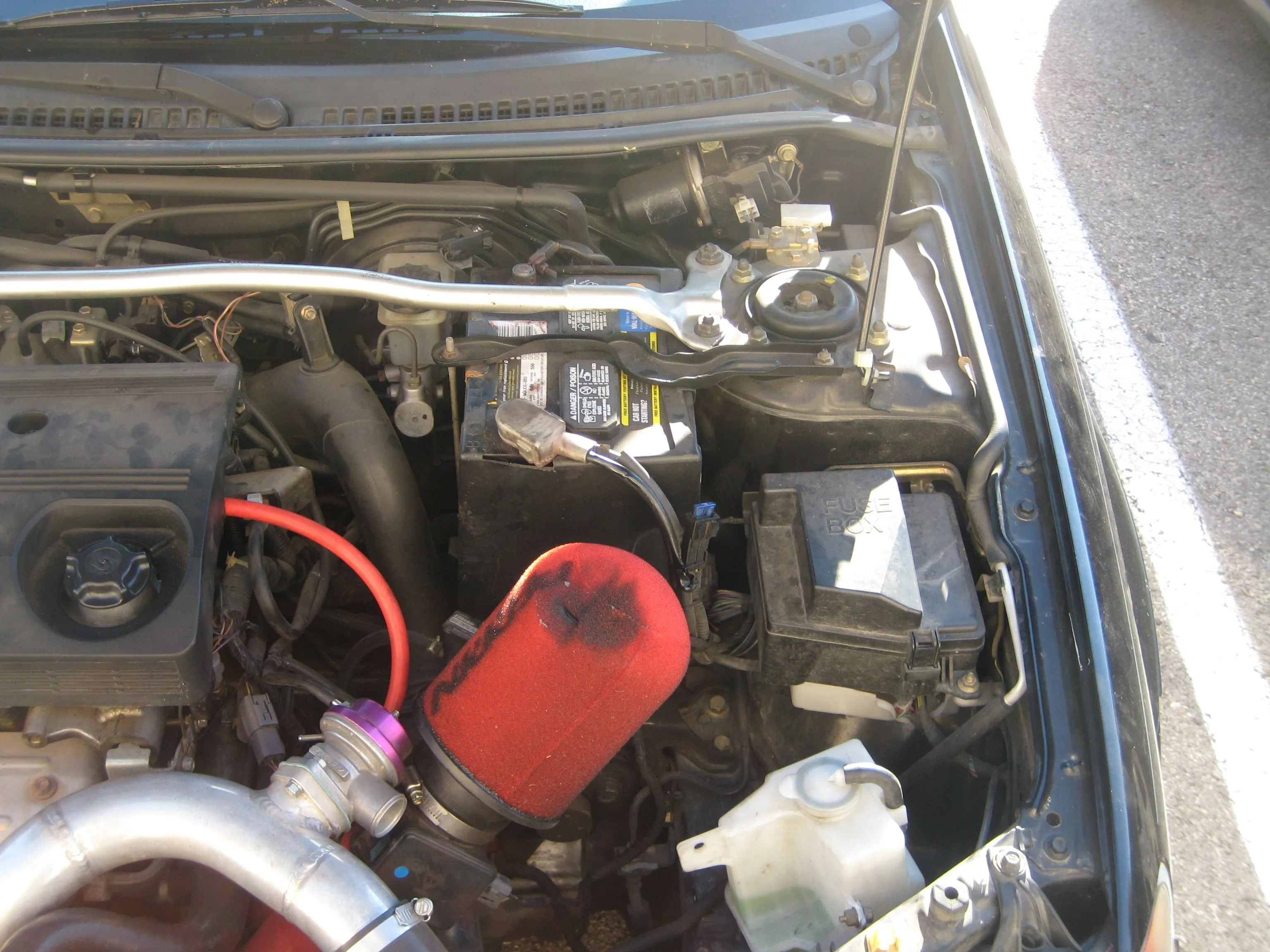

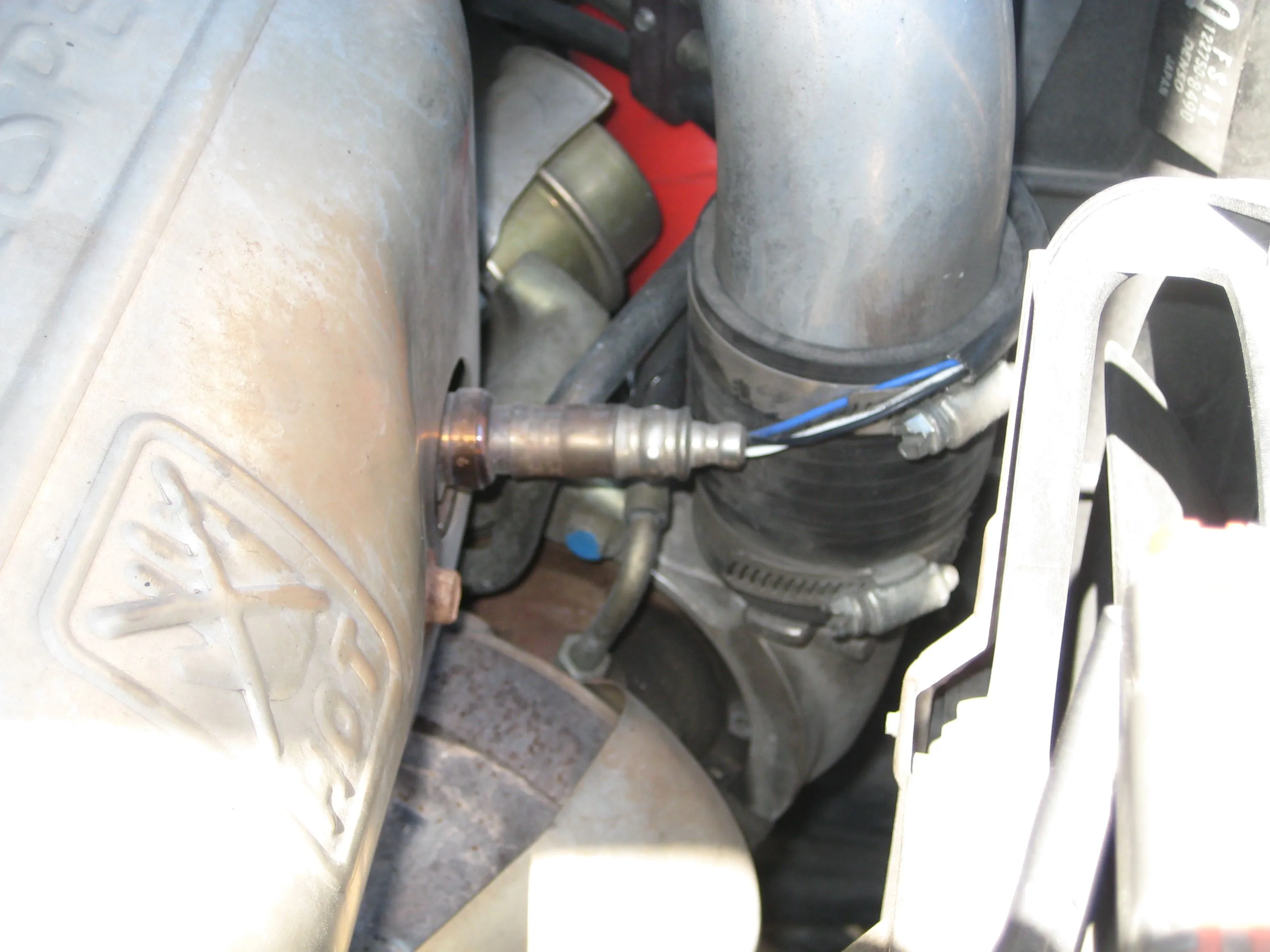

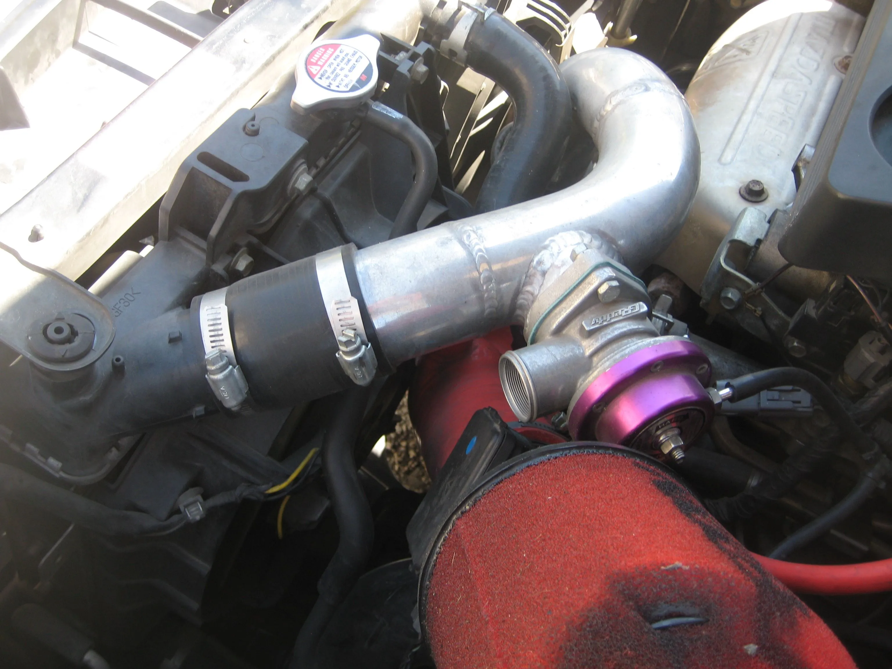

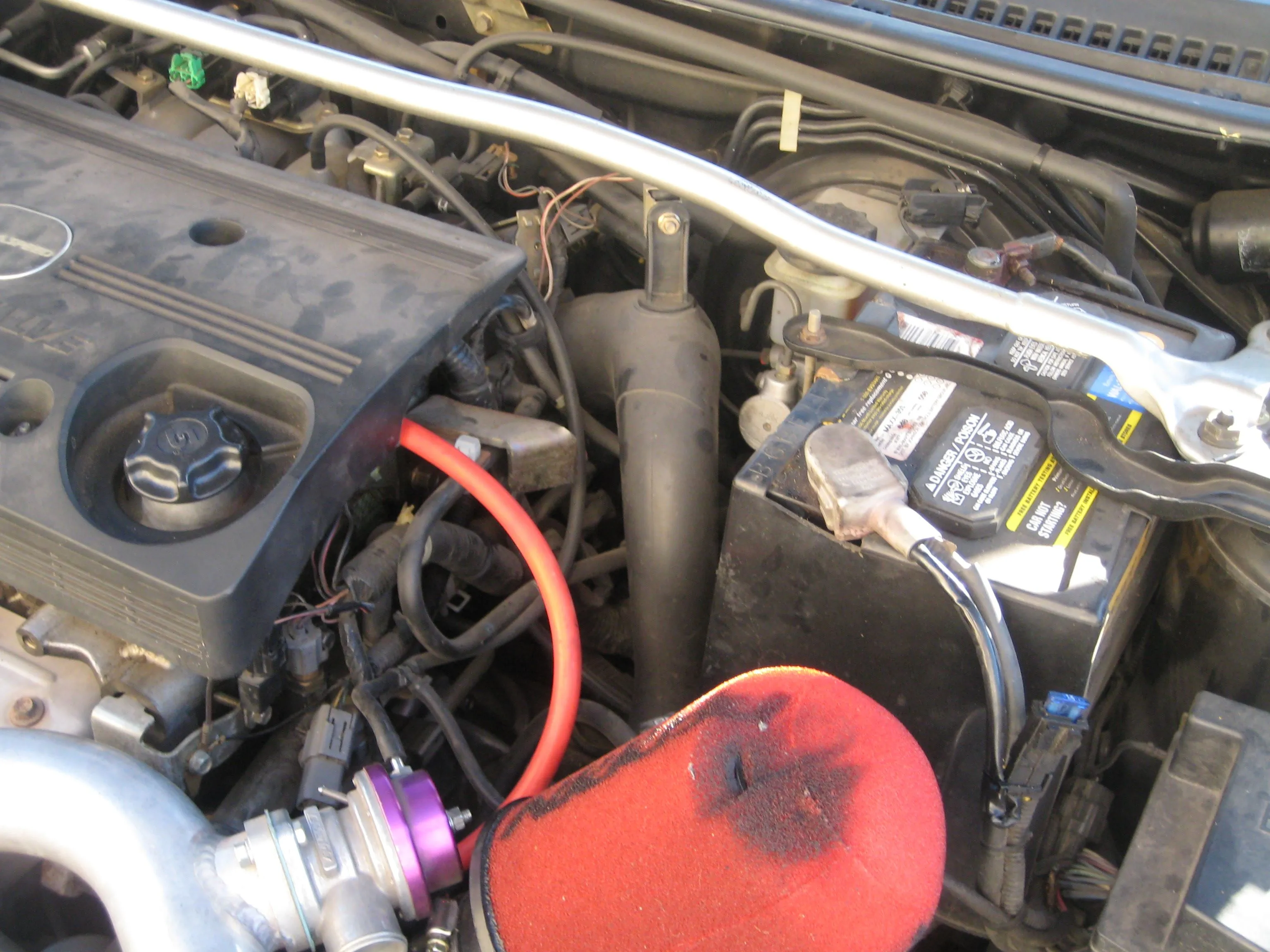

Here are some better pics of the entire setup in the engine compartment. What all will I need to relocate the BOV? (pipes..etc...) I'm probably going to replace the intake and go with an cold air instead of a ram air.

thanks for the clearer pics, before anything you will need hardpipes. The hot pipe is ok. The cold pipe is still the stock plastic pipes. You could probably cut the plastic pipe and replace the cut section with the sensor but I have never seen anyone do a MAF relocation with stock pipes. But anyway, you will need an upgraded cold pipe, cut out a section of the cold pipe and replace it with your sensor using couplings and clamps. Someone mentioned earlier the distance from the TB and the BOV. That should be it, just make sure you clean out your pipes after you finish cutting so you aren't sending metal shavings into the intake manifold, etc.
