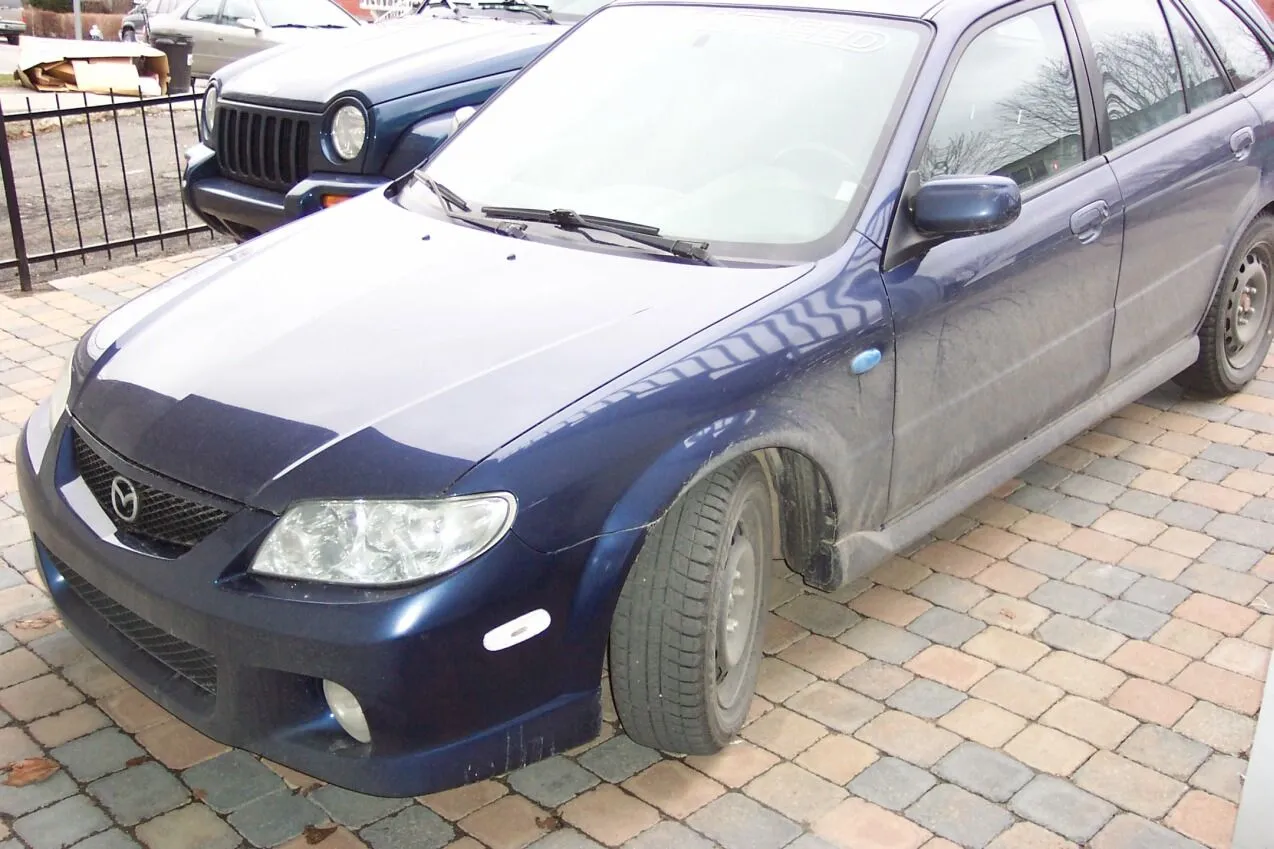

I'm VERY careful when I take stuff apart and still cracked mine in the middle! I welded a strip of plastic on the back side and put it all back together. You can't tell, but just letting you know mine broke. I couldn't believe the amount of force required to remove such in insignificant piece of plastic. It has 5 clips...yes, FIVE. In any case, here's a pic of my car where you can see my strip. I didn't take this pic to focus on that strip. In actuality, because our cars are midnight blue, you can barely tell the difference between painted and not painted since it's such a thin strip. I didn't get much satisfaction from doing mine, but still a nice touch I guess. Also, Get touch-up paint in an aerosol can and don't use a brush or it'll look like crap.... Good luck!
