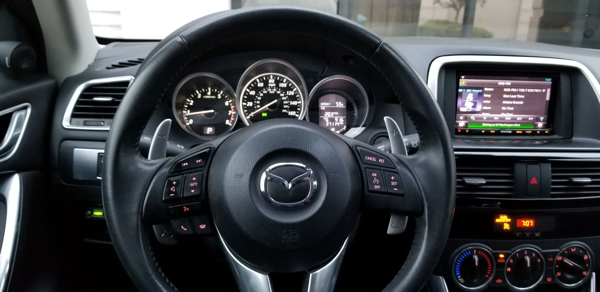

Anyone know if there is any place to get a kit for a 2016 still? I'm having issues finding some of the Japanese parts and it looks like there aren't any kits available anywhere anymore.
Correct, when you order from japanparts, select Option #15 on part No : 479-006-002, whether or not you have radar cruise or normal cruise control.

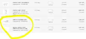

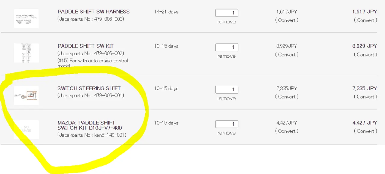

So I understand that this is the COMPLETE package you need for a 2016 GT with normal cruise control. I noticed that Japan parts added a NEW part (last on the list, JAPANPARTS MAZDA: PADDLE SHIFT SWITCH KIT D10J-V7-480 (D10J-V7-480) | JDM Japanparts.com |) that seems the be the excat same as the one just above (Mazda SWITCH STEERING SHIFT | JDM Japanparts.com | KEEAW/ KEEFW/ KE2AW/ KE2FW/ KE5AW/ KE5FW), but at HALF the price.... I asked them what the difference was....
