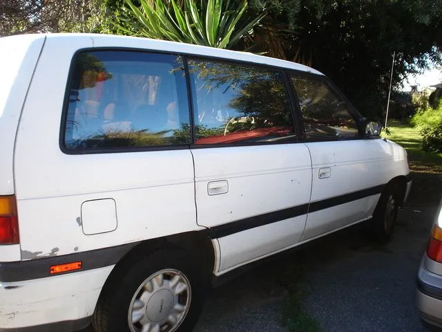

P5 with 15x6 +40mm offset
Anyone know if this will cause any issues on stock suspension? I plan to run the stock size tire of 195/55-15R with the wheels. I also did use the search function before making this post but 99% of the posts were talking about going with a bigger and wider wheel.

Kinda looks similar to the NA-6 Miata's "Daisies"...
Yeah good eye. I did want a wheel like the Miata Daises, but not only did they have an incompatible lug pattern like you mentioned, I think 14's either wouldnt clear the brakes, and I think 14's are a bit small for what I was looking for. But yeah these MPV wheels do have a similar look, as they also have a larger center cap with with the lettered Mazda logo.
