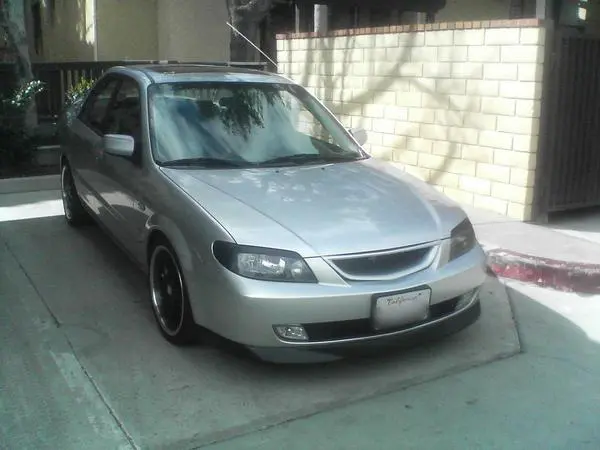

I believe that the grill in the front bumper is different, that is why mine does not fit properly, msp & mp5 grill is diff from the sedan
Yes they are different. Compare this pic and you can see the difference.
