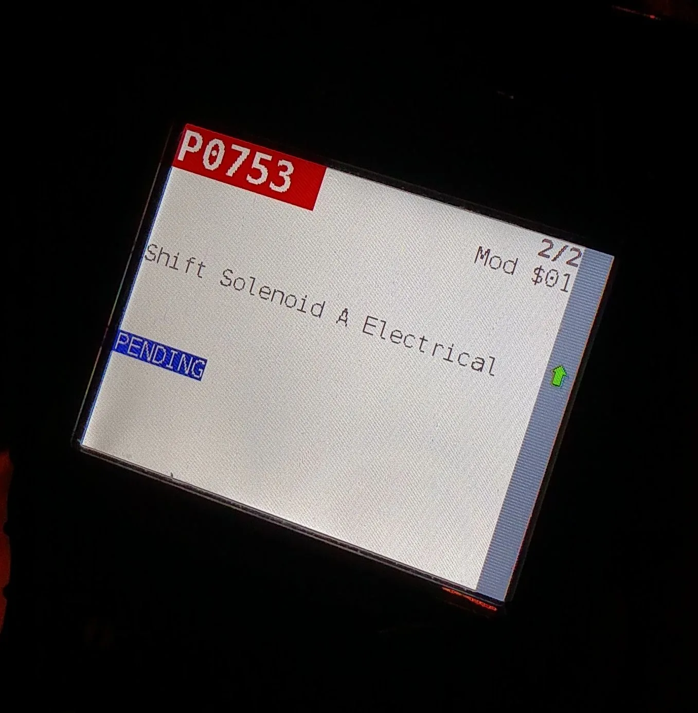

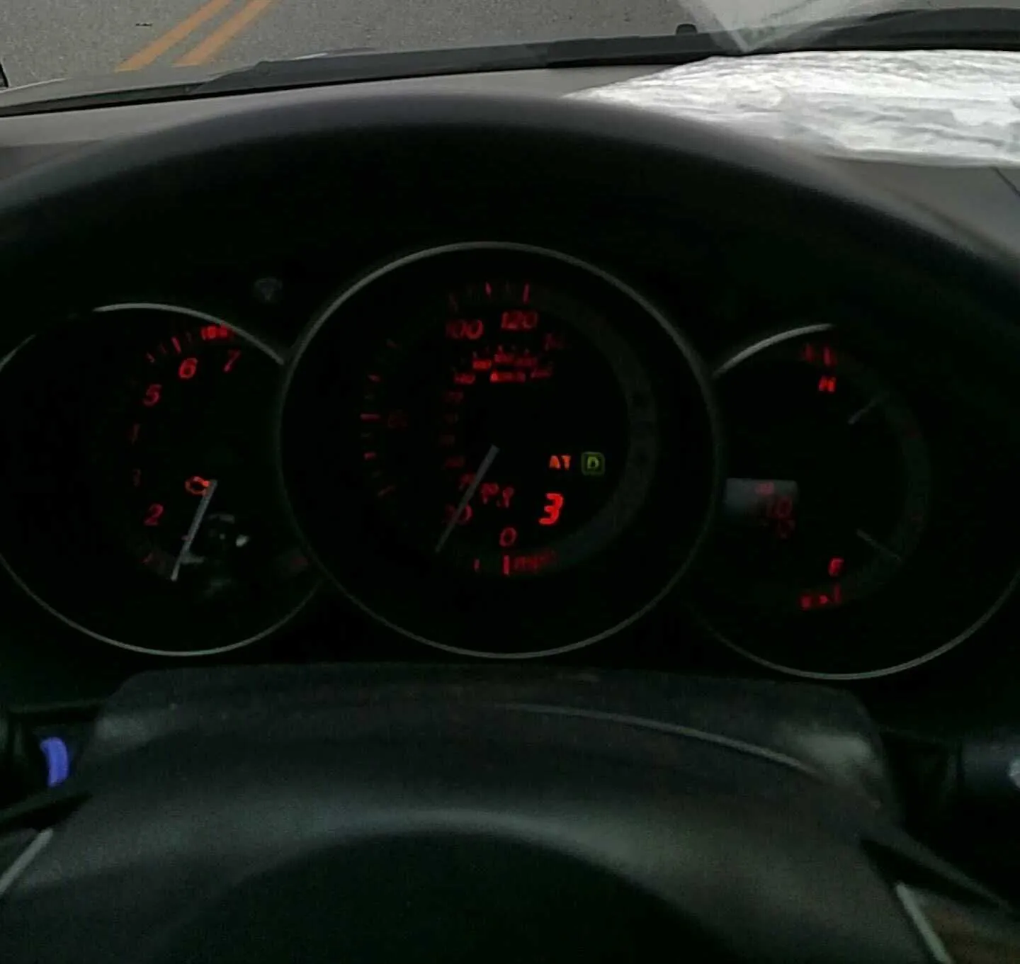

We have a 2008 Mazda 3, 5 speed auto. Last Tuesday my Fiance` left to go to work. She crossed a set of rail road tracks at 25-30mph and as soon as she got over them the car shifted hard and the "CEL" and "AT" light came on. She pulled over and called me. I looked everything over and couldn't find any loose connections or shorts. At first I figured it was a vehicle speed sensor but, after doing some homework on the symptoms I had the local autoparts store look up the error code.
P0753 - Shift Solenoid A Electrical

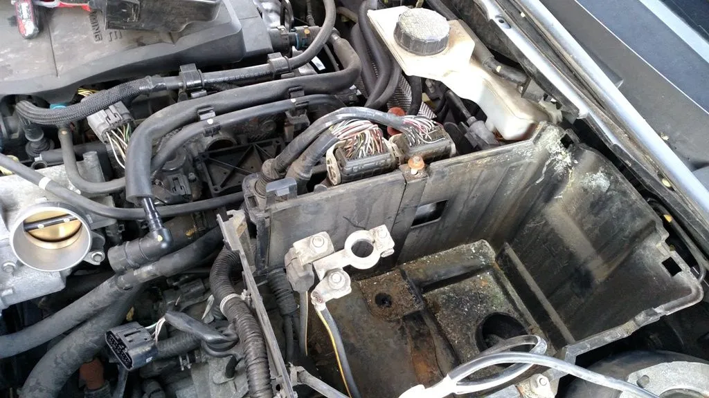

Since I am not that familiar with Mazdas I started doing some home work on the error code. From what i have read this is an electrical issues between the TCM and the solenoid A. So, I had to wait until Saturday morning to work on it. I pulled the air box and battery tray out to look at the wiring harness closer. I couldn't find anything obviously wrong. Since I was working in my parking lot I couldn't hear to test the solenoid in the car.
I have reset the check engine light several times and had to have her keep driving it to work (in limp mode) which is across town at slow speeds. She said that sometimes the AT light will not come on and the car will shift normally. Other times it will come on and stay in limp mode. I reset the CEL one last time and took it for a test drive. I made it about 10 miles starting and stopping before the AT light came on. Once it came on, it would stay on for me.

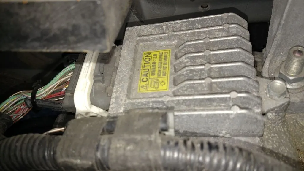

From what I can tell the TCM is most likely the problem. But, I know that her transmission fluid is due for a change. So, I parked her car and let her drive my truck (gah)
I ordered a new TCM from a module re-builder in California. It should hopefully be here this week. I also ordered a filter,gasket, and solenoid A & B kit off of ebay. My plan is to once I am off of work on Thursday to drain her flush her transmission, put in a fresh filter, and to bench test the solenoids according to the FSM procedure. (I am sorry guys I have damaged hearing so I don't know that I could hear the solenoid work in the car). That way if she does in deed have a stuck solenoid I can go ahead and swap it out. The solenoids are accessible by just dropping the pan right?

Thanks for the reply. We ordered a rebuilt TCM from a module rebuilder in California last Saturday. We got it in on Wednesday and I installed it on Thursday. Because of the weather I have not been able to flush the transmission or check the solenoids. However, this seems to have fixed the problem so far. I am planning on flushing the transmission in a couple of weeks and change the motor mounts while I am at it.
I will keep you guys posted if the issue comes back. But, I am hoping that was it because (with the holidays) we have driven the car about 215 miles since I swapped the TCM on Thursday and SO FAR the issue has been resolved.

Brute what are you using to get your engine codes? Display looks nice.
