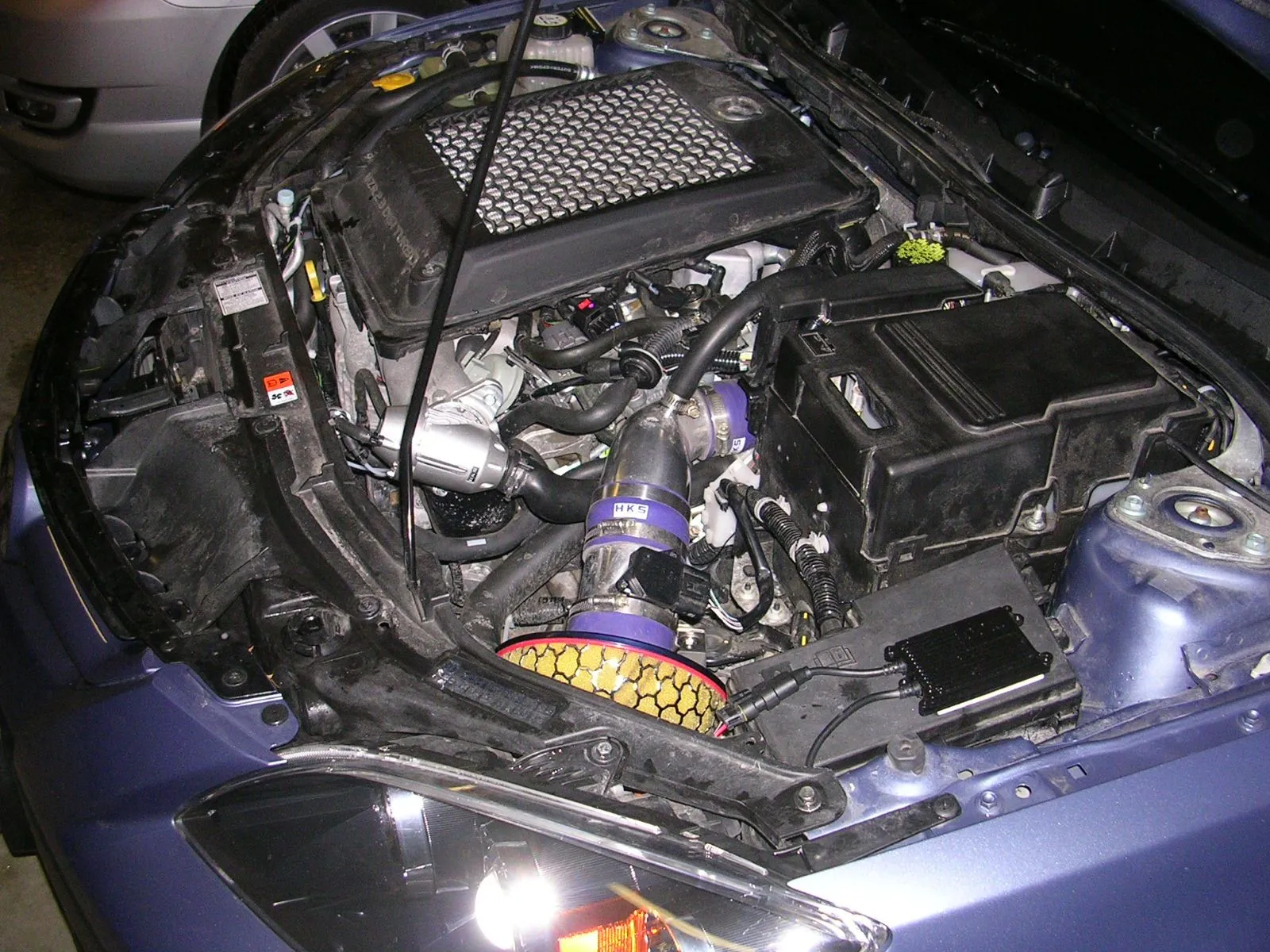

you don't have an aftermarket hose - you can use the stock one, but the only way you can tilt it forward so it doesn't hit the plastic stuff i talked about it will cause a little kink in the hose - it really will recirc and work just fine this way - see mine
but if you wanna get the hose this is the guy i was talking about
http://www.mazdas247.com/forum/showthread.php?t=123745892
if not that su sells a silicone hose as well - they actually sell everything but the recirc fitting they sell is from cpe and is only 1"
