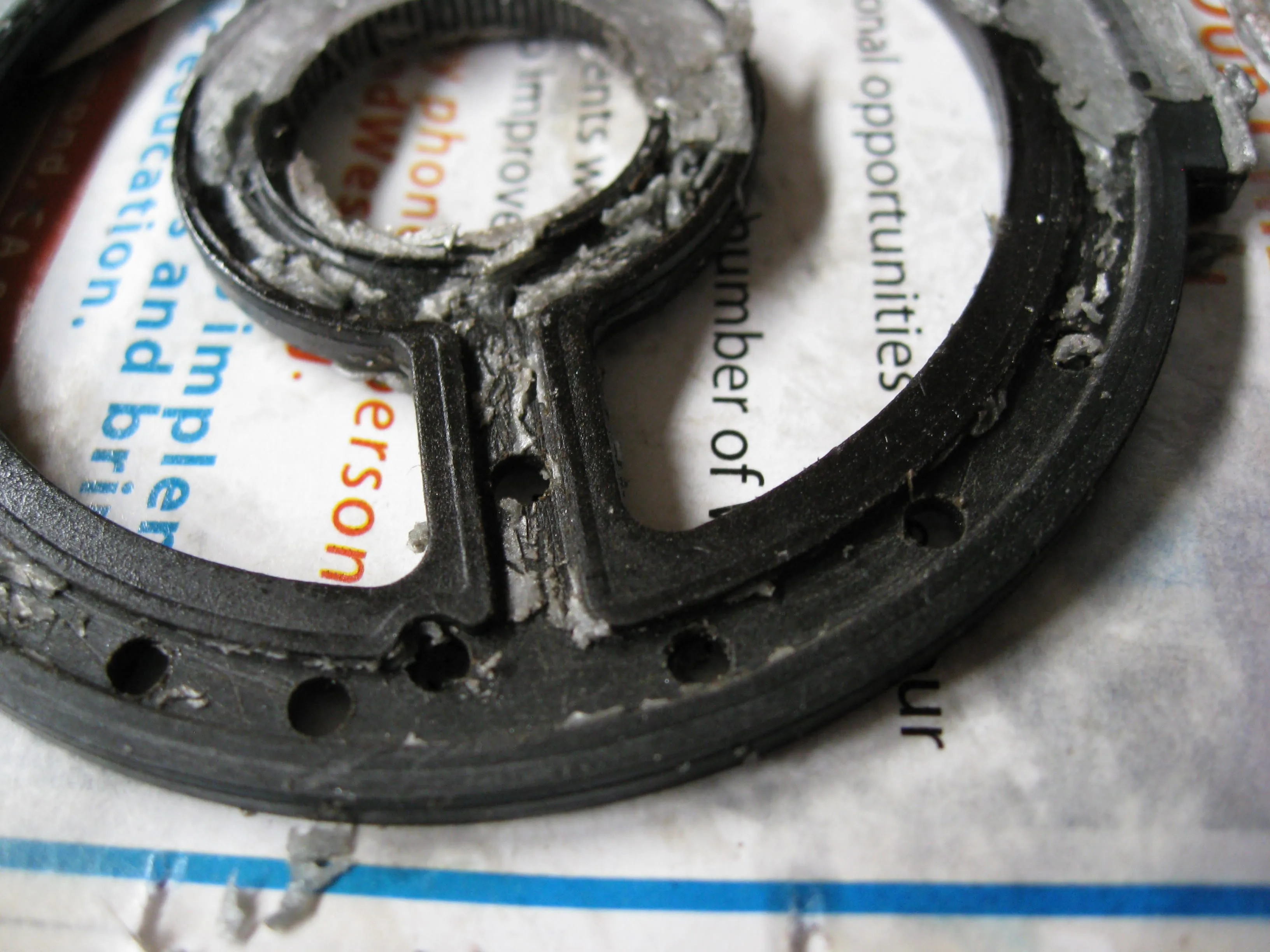

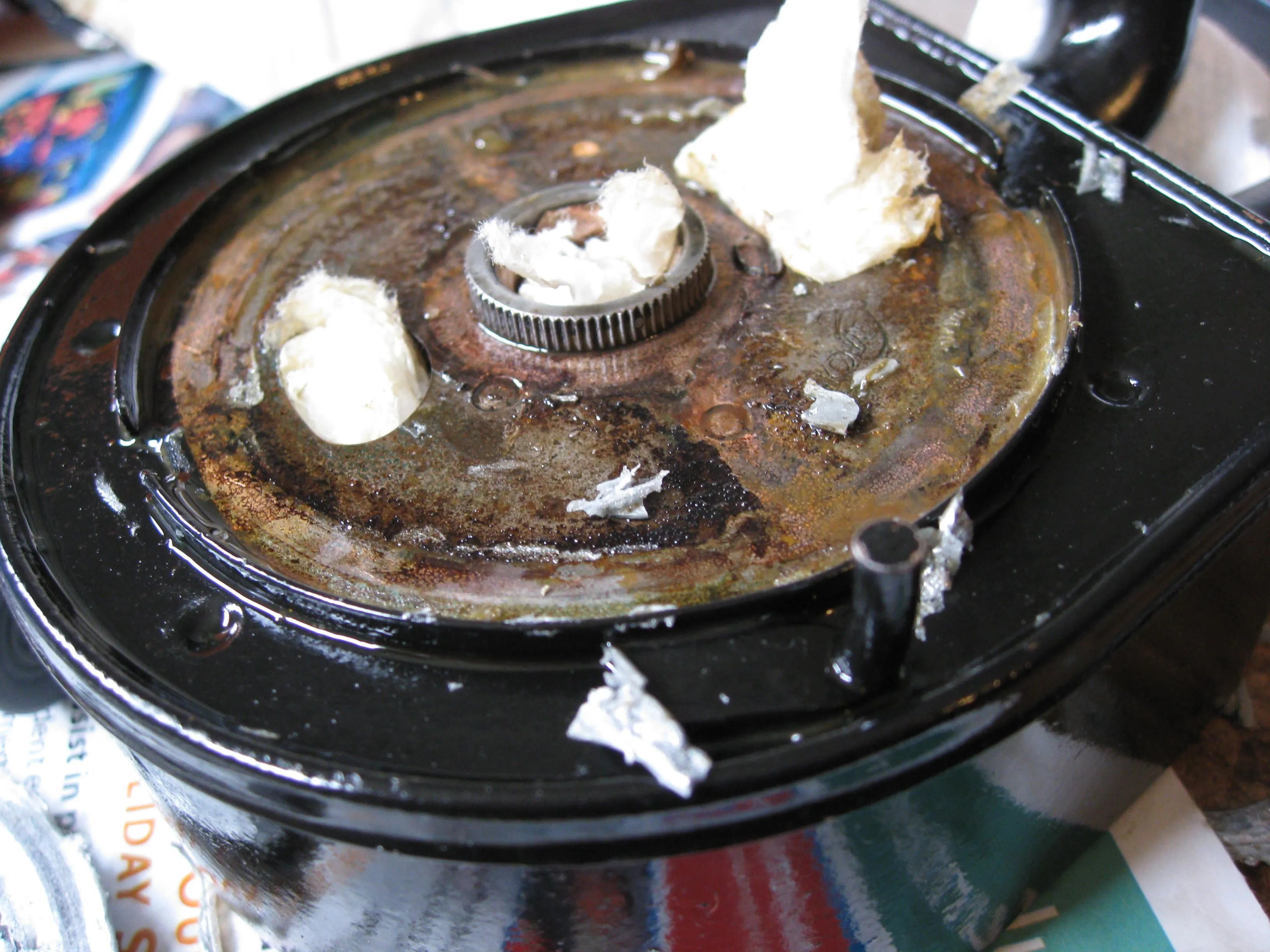

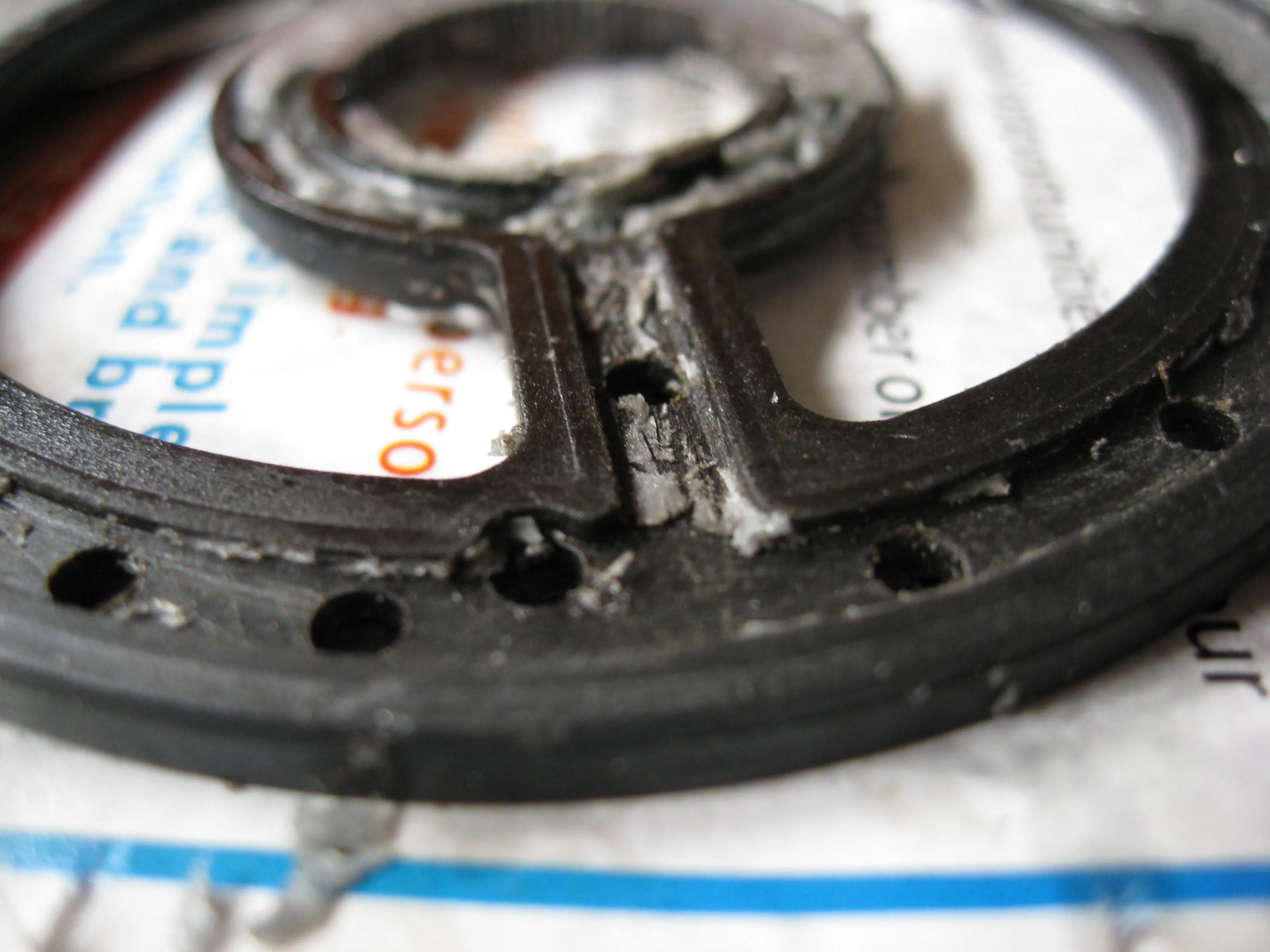

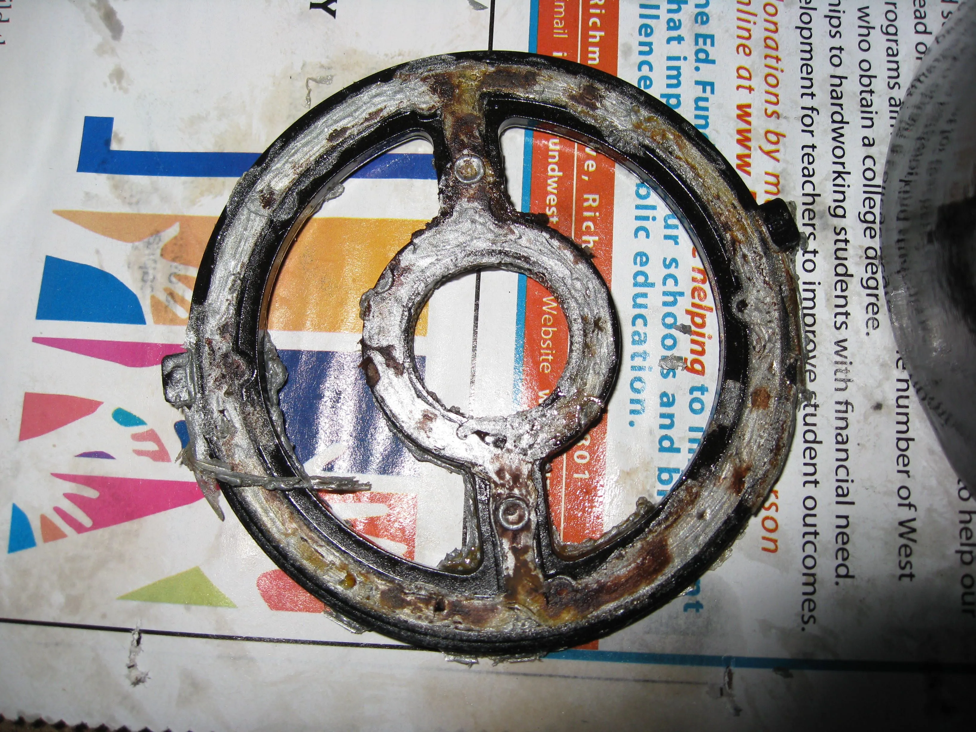

In trying to update my 2009 Mazda 5 cartridge oil filter to the current Spin On Filter Conversion, I inadvertently split the silicone seal/gasket between the oil cooler and the oil filter housing! This caused me to lose 4qts of oil during start up and almost lose my engine! Be careful not to do what I did!
Does anyone know how to resolve this problem?
The seal is only sold with the Oil Cooler = $420!
I removed the ridged (looked like 1/2 o-ring on top of silicone gasket) silicone seal from the plastic plate attached to the oil cooler and tried to make one myself out of Make a Gasket Silicone but to no avail. Carefully beaded the caulk onto the plastic plate, let it form a skin. smoothed it out leaving enough for compression with an ice cube, put together, tighten bolt on cooler to housing, let dry 36 hours,re tightened.
Started it up = oil seeped out at seal interface! Totally frustrated!! In DYI for more than 45 years, this got the best of me!
Any thoughts:
Resources to purchase just the Plastic Plate/ Silicone seal rather than the $420 Oil Cooler with seal.
How to build a silicone seal that will withstand the oil pressure.

UPDATE: Just have to buy this gasket: LF8X-14-702 same as pictured. $4.70 list, exact replacement w/o any headaches... woohoo!
UPDATE #2:The gray ridge part of the o-ring on the black plastic spacer/gasket interface between the oil filter housing and oil cooler had torn when it stuck to the old cartridge housing,causing the leak between the new housing and the oil cooler.
