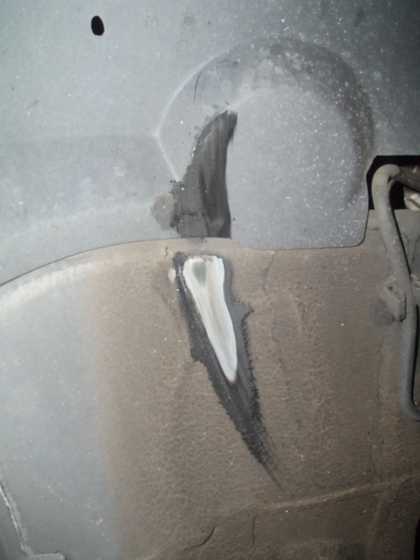

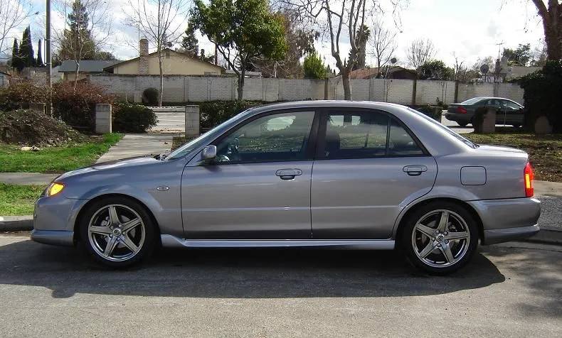

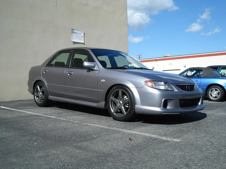

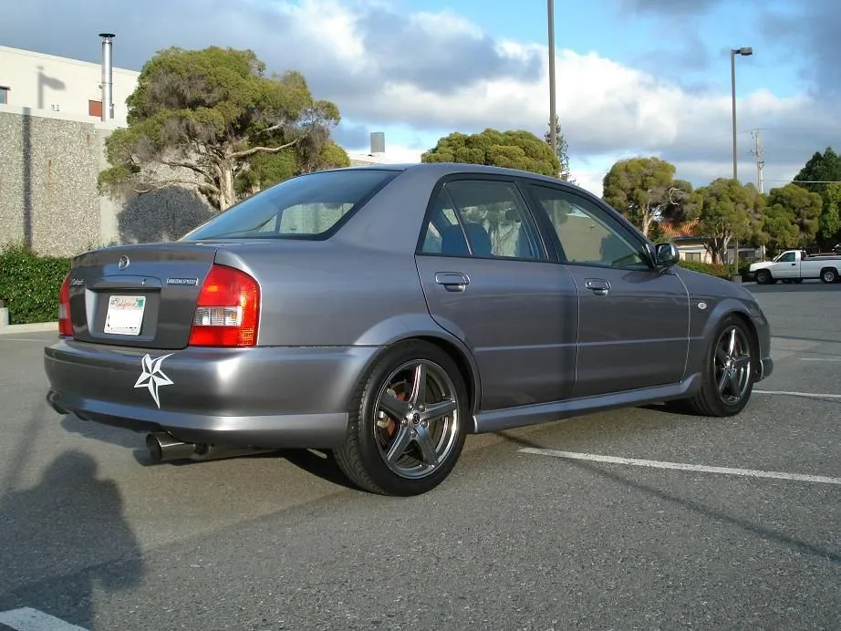

falken fk-452 225/45/17 rub on my car...i'm lowered on goldline springs
