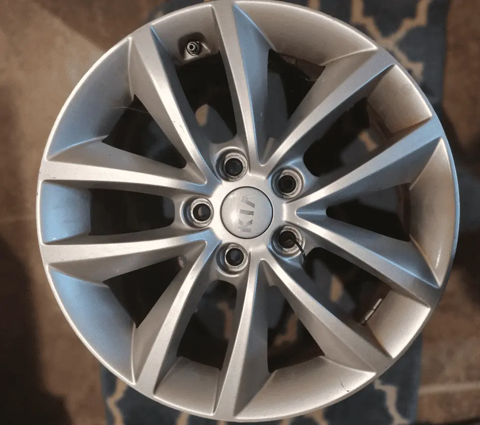

Also do you have junkyards down there? Are Mazdas, Hyundai's or Kias popular down there? Most of them have the same bolt pattern PCD and centerbore. Offsets might slightly differ but are usually acceptable. Up here i get decent salvage rims for cheap like $25 to $90 each. If you tell me which brand is popular, i may be able to point you in right direction as fas as what to look for. Imo, An extra set of 17 inchers will never be wasted, especially for your terrain .

If you are somehow able to find a junkyard that has used cars,
look for this:
Kia Sorento 17" x 7" width rim with 47 offset.
I got one as a full-size spare for $45 or $50 at junkyard to use on my Mazda CX-5 as it matches my aftermarket wheels almost perfectly.
I'm sure there are other Kia rims that are similar, you just need to research.

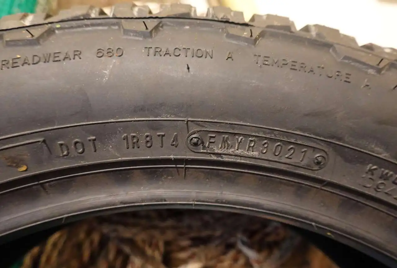

My tires arrived today yippee! If I'm reading the sidewall correctly they appear to have been manufactured July, 2021. Is that considered old? I assume they came to Colombia by cargo ship.
Nope . You got a couple years left...usually don't want to use them if theyre over 8 years. My nokian winters are 7 years old and still used. You should be out of tread before that happens. Here in US we even get tires from tireshop that are a year or two old.
"Tire Aging: FALKEN recommends tires which have been in use for 6 years or more should be inspected regularly by a qualified tire specialist. Plus any tire that is 10 years or older from the date of manufacture, including spare tires should be replaced with new tires regardless of appearance, even if the tires have not reached the legal wear out limit.
"Tires sold by SUMITOMO RUBBER NORTH AMERICA, INC. (dba) FALKEN TIRE CORPORATION (“FTC”) may be submitted for warranty adjustment by dealers only within six (6) years from the DOT number date (for 2021 produced and newer) of production, using the following guidelines.
Wow. Thanks for posting the aging specs. Didn't know they had that online. I thought 8 was limit. Good to know you can run them up to 10 if they look ok. Sounds like OP works and drives alot. He should hopefully be outta tread before he even has to start worrying about age effects.
Inspect after 5-6 years with a 10 year max is a typical recommendation in the industry. Dry rot, cracking or bulging are the culprits to watch out for. A lot of off road or bumpy road driving may cause premature wear of the steel belts though I don't know how you'd inspect for that other than driving feel.
