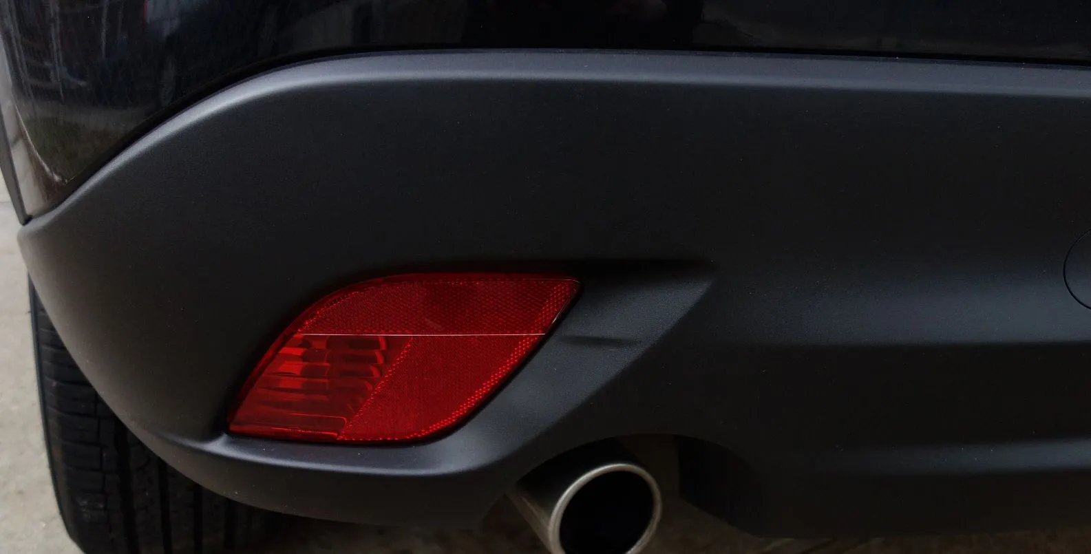

OEM bumper lights and JDM reverse lights
2016 CX-5
lighted bumper reflector housing and bright LED reverse bulbs

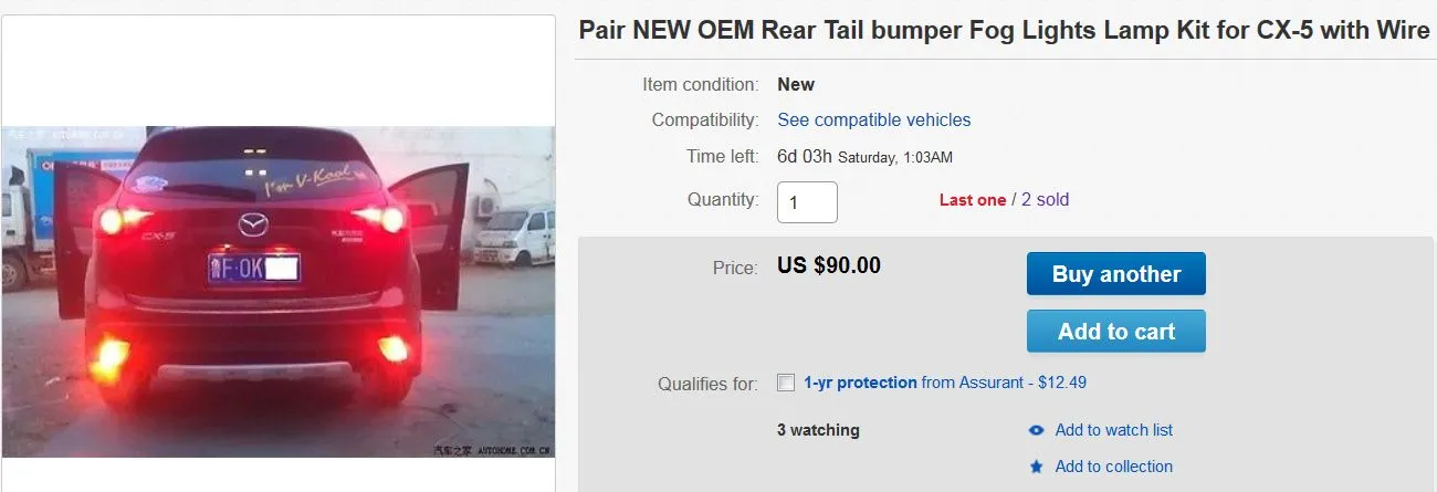

for those interested in bumper brake lights, this seller is selling them for $90 per pair :
LINK: http://www.ebay.com/itm/1-Pair-OEM-Rear-Tail-bumper-Fog-Lights-Lamp-Kit-for-Mazda-CX-5-with-Wire-harnes-/222346378822?fits=Model%3ACX-5&hash=item33c4e07e46:g:jVYAAOSwA3dYT9oz&vxp=mtr

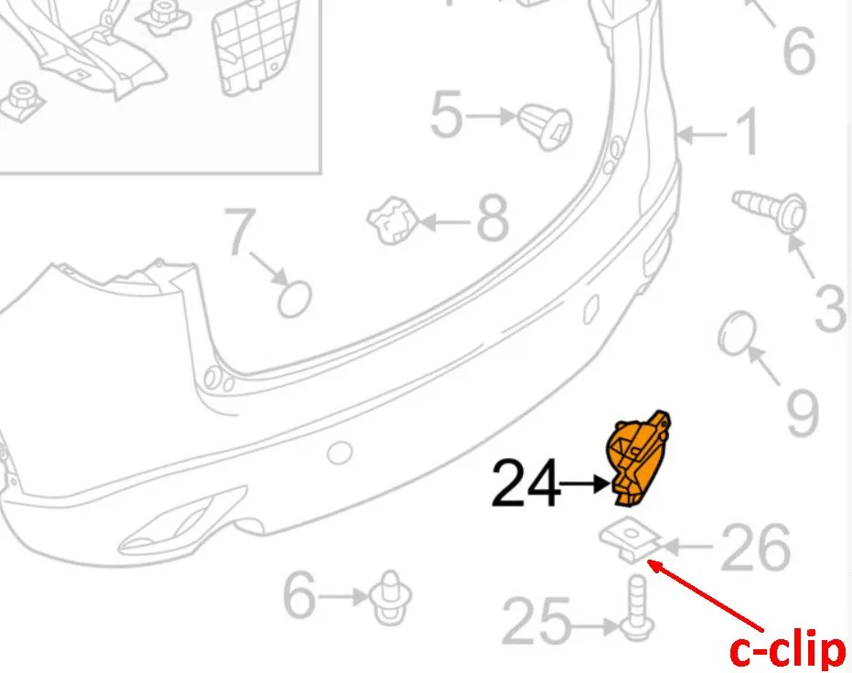

I got them and installed them, very easy to install, you will need to re-use the C-clip on the bottom side fastener since he didn't supply the housing with those, but that's no biggie, they slide right out of the old housing:
attachment.php
also no need to remove bumper at all, just need to remove the plastic panel underneath the reflector and a couple of panel fasteners by the rear wheel wells, then remove the rear tail light and thread the black+red wire thru the hole in the quarter panel and splice to the brake light harness (*Note: the seller supply pretty thick gage 14 red/black wires, I didn't need that thick gage since I replaced his halogens with red LED bulbs below, also safer to go with the LEDs than the halogen as the LEDs run much cooler and less current.

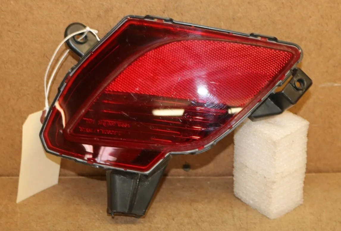

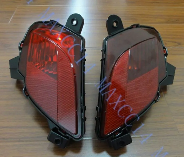

if you look closely at the seller's listing, they are OEM Mazda parts, one has a internal chrome reflector and the other one doesn't, probably the UK version where only the reflector side is lit, note sure ?

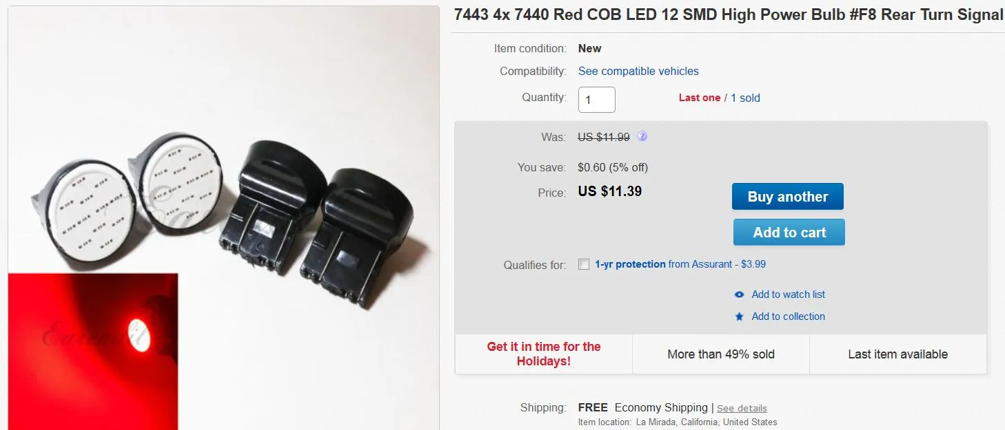

he retrofitted the non-reflector with 7440 sockets, so I got these red LED with no back facing light, so it won't matter that one doesn't have a reflector, they both shine identical since these LED's don't shine into the reflector
http://www.ebay.com/itm/172386403642?_trksid=p2057872.m2749.l2649&ssPageName=STRK%3AMEBIDX%3AIT

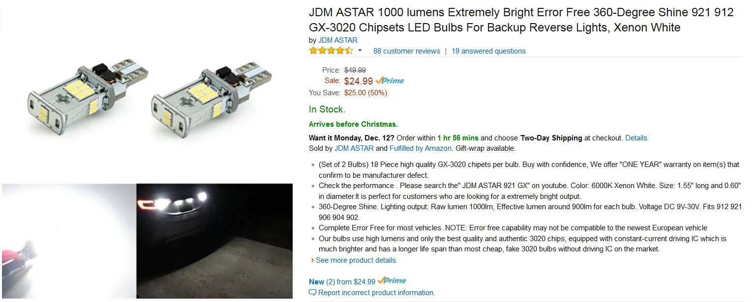

Also, I got these for 921 LED reverse lights, these are extremely bright and much brighter than the OEM 921 halogens

see video below on how to remove the rear tail light 1:00 to 2:00 minute mark, again you don't need to remove the rear bumper to install the lighted bumper light housings,
there's plenty of room back there:

Any lights been put in these two bumper locations is better than original red reflectors for DOT regulation. I would think in the US using these for brake lights is the best but there're too low for the location. I was wondering if the red reflecting function on the lens is still there from these aftermarket rear fog light kits?
.....I was wondering if the red reflecting function on the lens is still there from these aftermarket rear fog light kits?
good point yrwei52, I was curious myself, so I asked my wife to drive in front of me tonight as I followed her and yes, the ones I bought do still reflect light at night when my headlights shined on them even without the lit bulb inside.

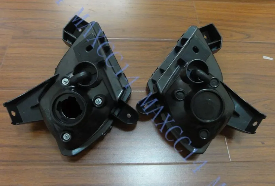

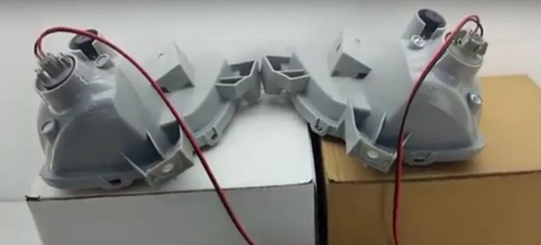

Actually the ones I got and ebay link in my first post are actual OEM Mazda parts (not aftermarket parts per se), one of them already has a socket hole/bulb for a 7440 bulb the other one doesn't so the seller drilled a hole and added a 7440 socket into it,
attachment.php
below is a picture of euro/overseas spec reflector without the retrofit, but you can see one side has a socket for a bulb, the other side has no bulb
EURO/CHINA/TAIWAN CX-5'S Right:KD77-51-650-A Left:KD53-51-660-A

and here is USA spec reflectors, no cavity at all, it's completely flat
USA REFLECTORS, just a flat black plastic panel reflector NO CAVITY FOR LIGHT BULBS: KD31515L0

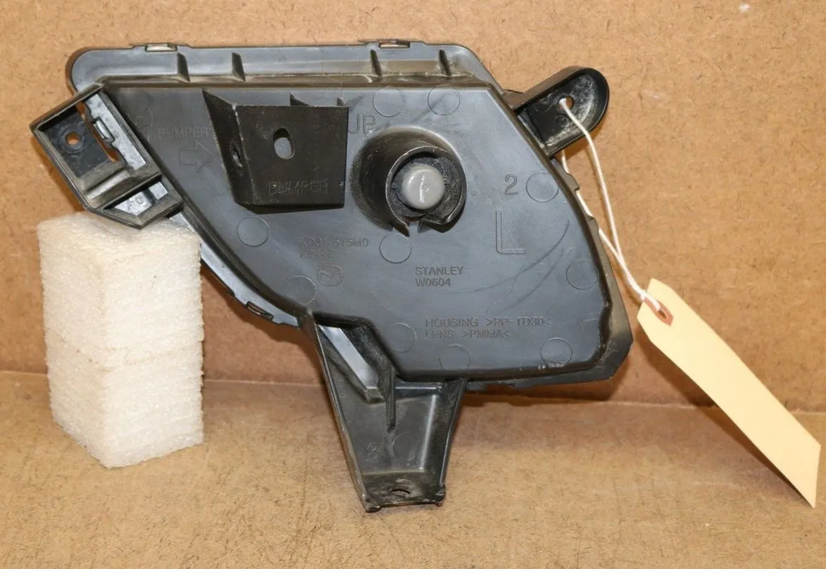

What is that gray plug in the 1st picture? Can't we add an LED in there?
attachment.php
that's a "gore vent" like a one way valve for moisture, it lets moisture escape but not enter into the lens cavity, otherwise you get water droplets inside the red lens. That grey cap can come off but you won't see a hole instead you'll see a molded stump with some sort of filter stuffed in there.
I'm sure you can retrofit the USA version but it'll take a lot of work, you'll need to get a LED panel and dremel out the back..... and make it look like Chris_Top_Her's version. it may also be possible to try to bake the lens housing and soften the seal and pry it apart, again it can be done but it'll take time and patience.
one LED light at the gore vent won't work, as tomcat1446 noted, there's no cavity to allow the light to spread out before hitting the red lens,
