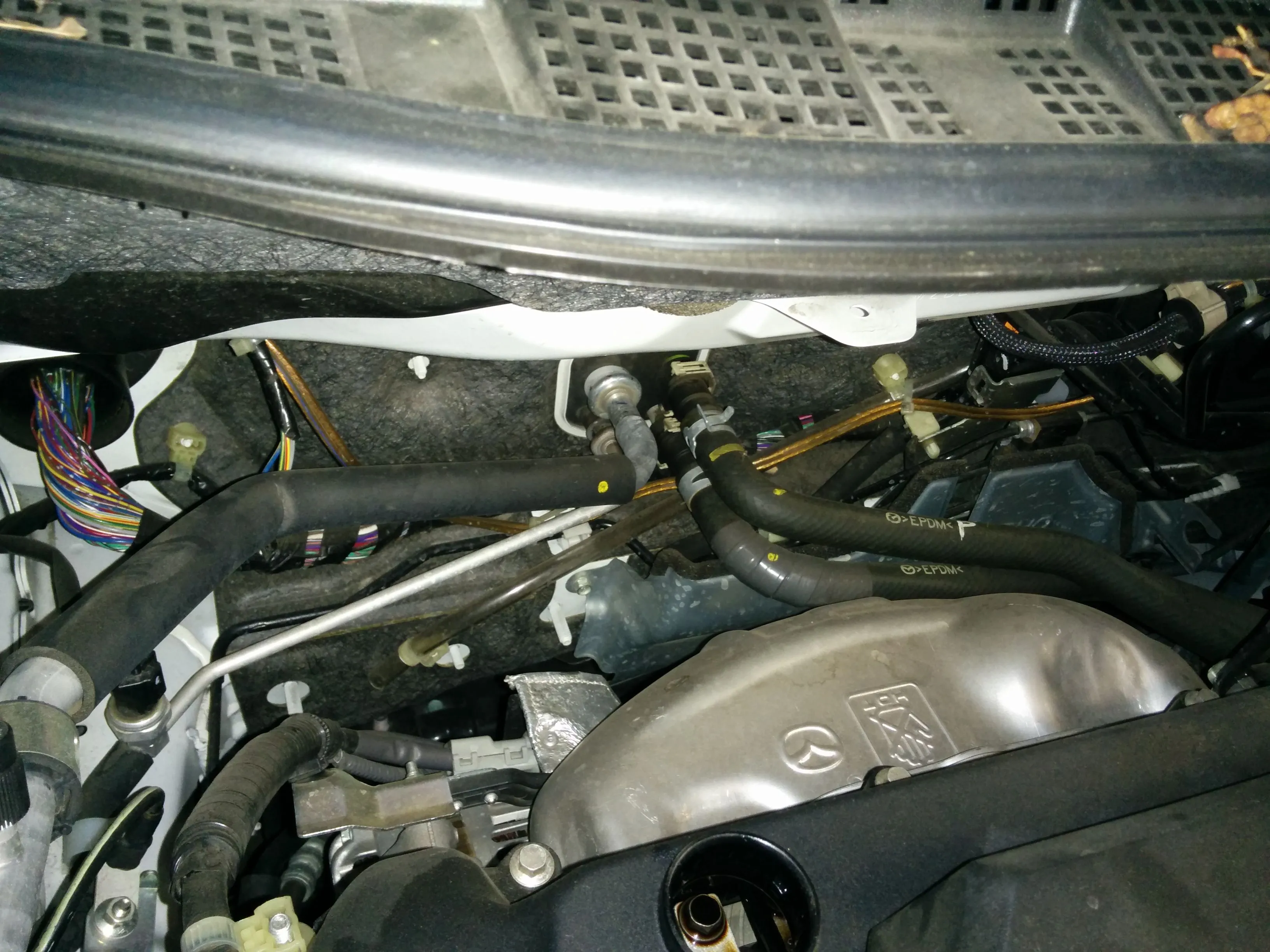

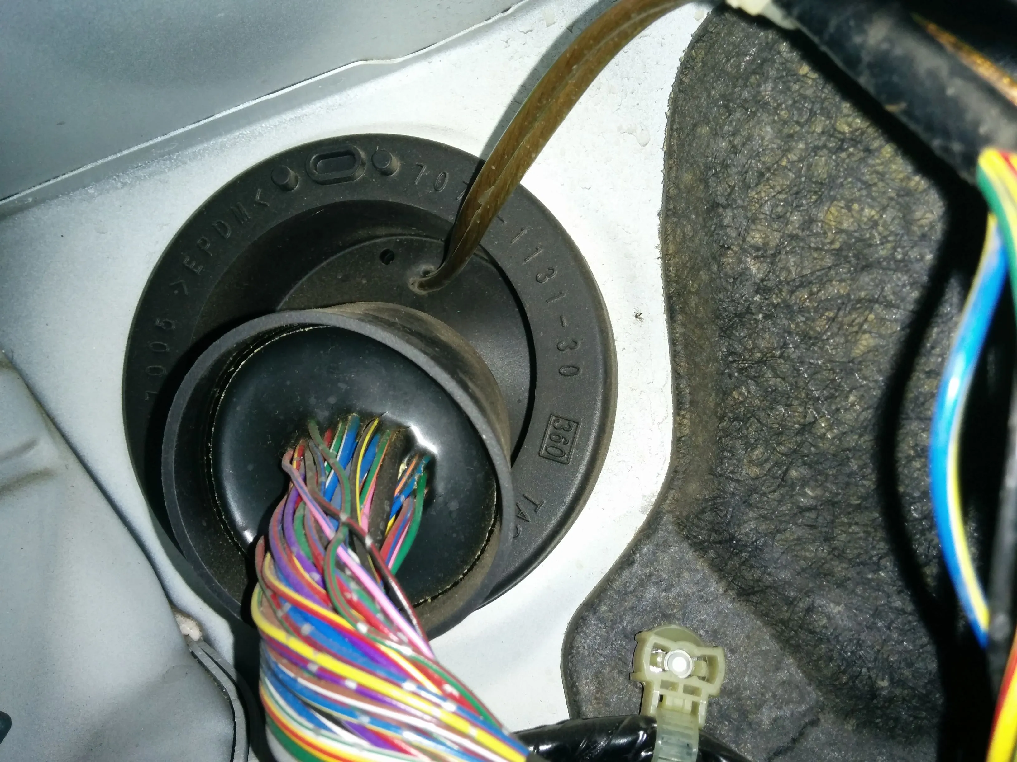

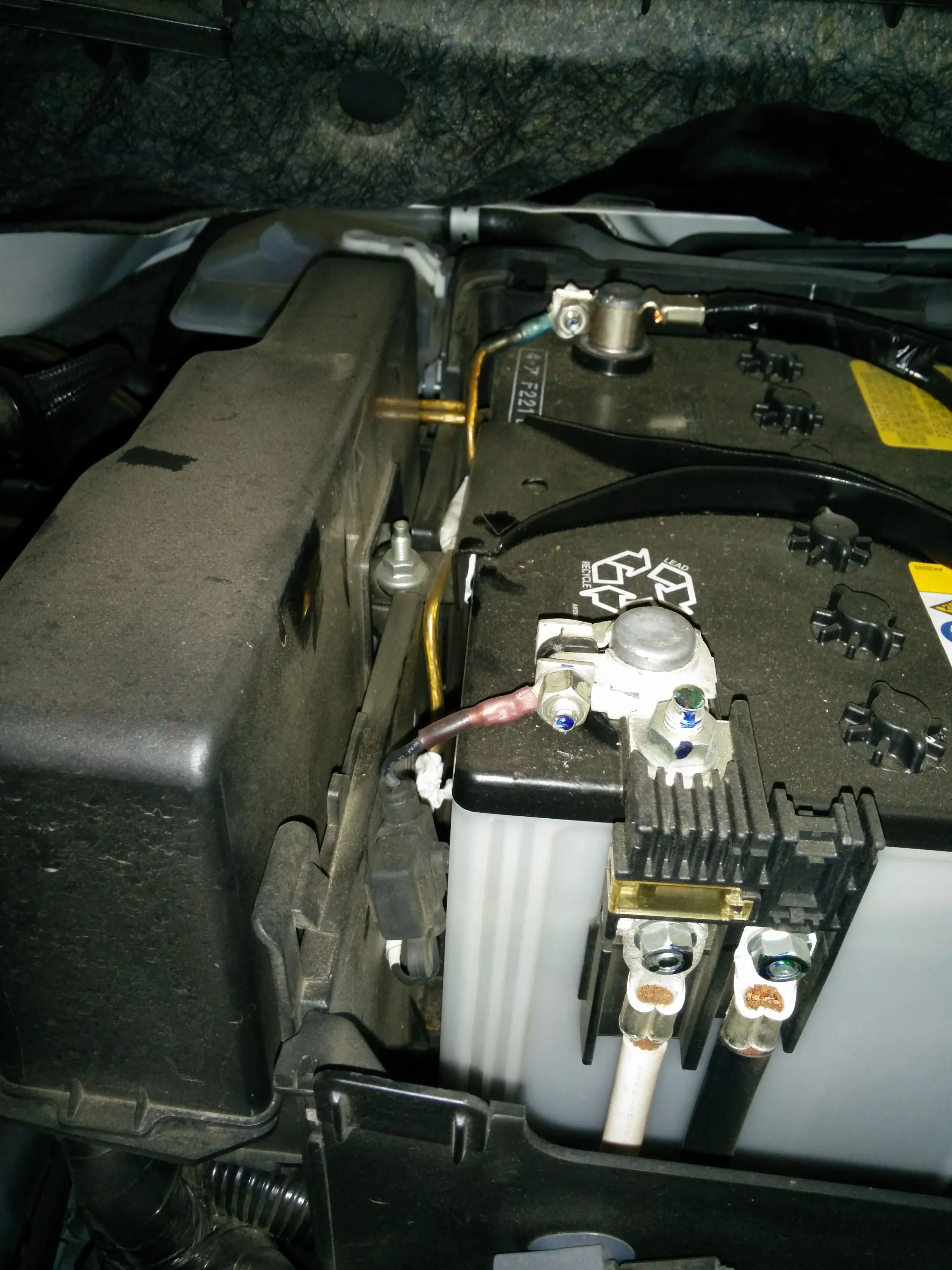

Running your own circuit is the right way to do it, though. I don't think I've got 15' into it. Maybe 5'. And about 10 minutes of work.
Where did you run your own with from and where did you thread it to/mount the switch or whatever you hooked to it?

Yes, it's 12GA speaker wire, but it's more than safe for this particular application.
For poking the wire through the grommet, I used an awl, after making sure there wasn't anything in the way behind it inside the car.
Zip tied in plenty of places safe and away from the exhaust.
