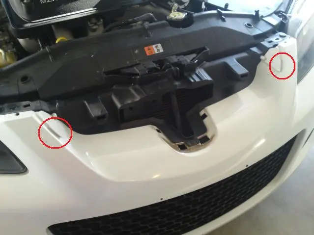

On the back of the grill there is a fiberglass lip that runs around the outter edge of the grill. On the right side of my grill the lip is shaved down to much and the lip won't catch on the piece of plastic sticking out from the bumper that the oem grill slides into. Its hard to explain without a picture and all I have is a crappy cell phone to take pics with.
Stole this pic from the thread in the how to about installing the grille..
But right there is where the grill should slide into and on my nextmod the right side of the grill doesnt have enough lip to catch right there so it creates a small gap on that side.
Oh those... yeah, I needed to file about 1/8" inch into the grill where those tabs attach... I didn't, lol. If I had more time, I would have. Now the 3M tape is glued on, so it's not happening. Mine looks fine though (imo anyways, lol).
