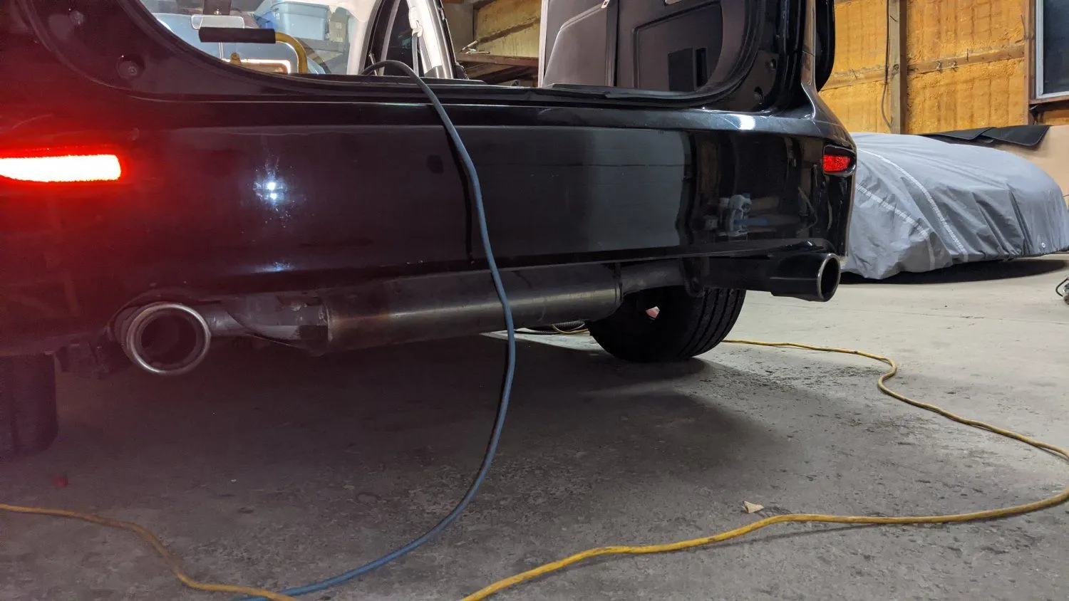

-custom 2.5 id exhaust from cat back
-custom fitted dual exhaust from a 2010 mazdaspeed 3

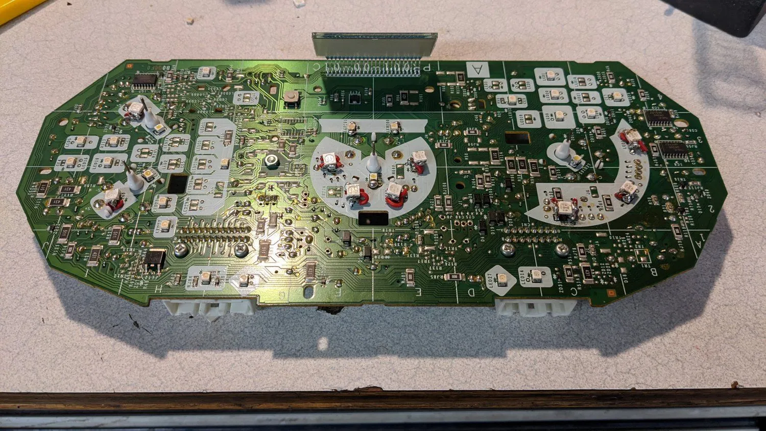

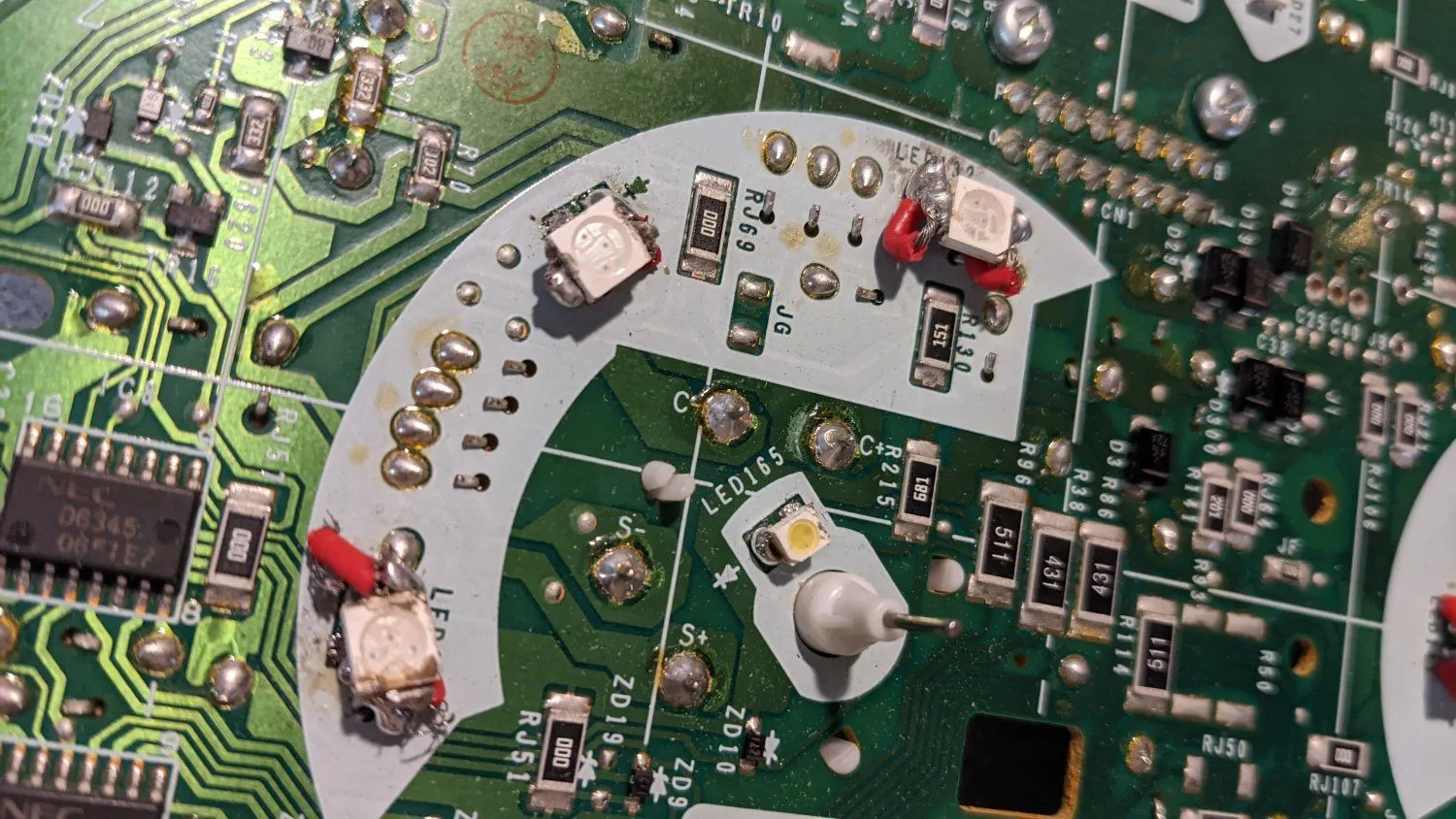

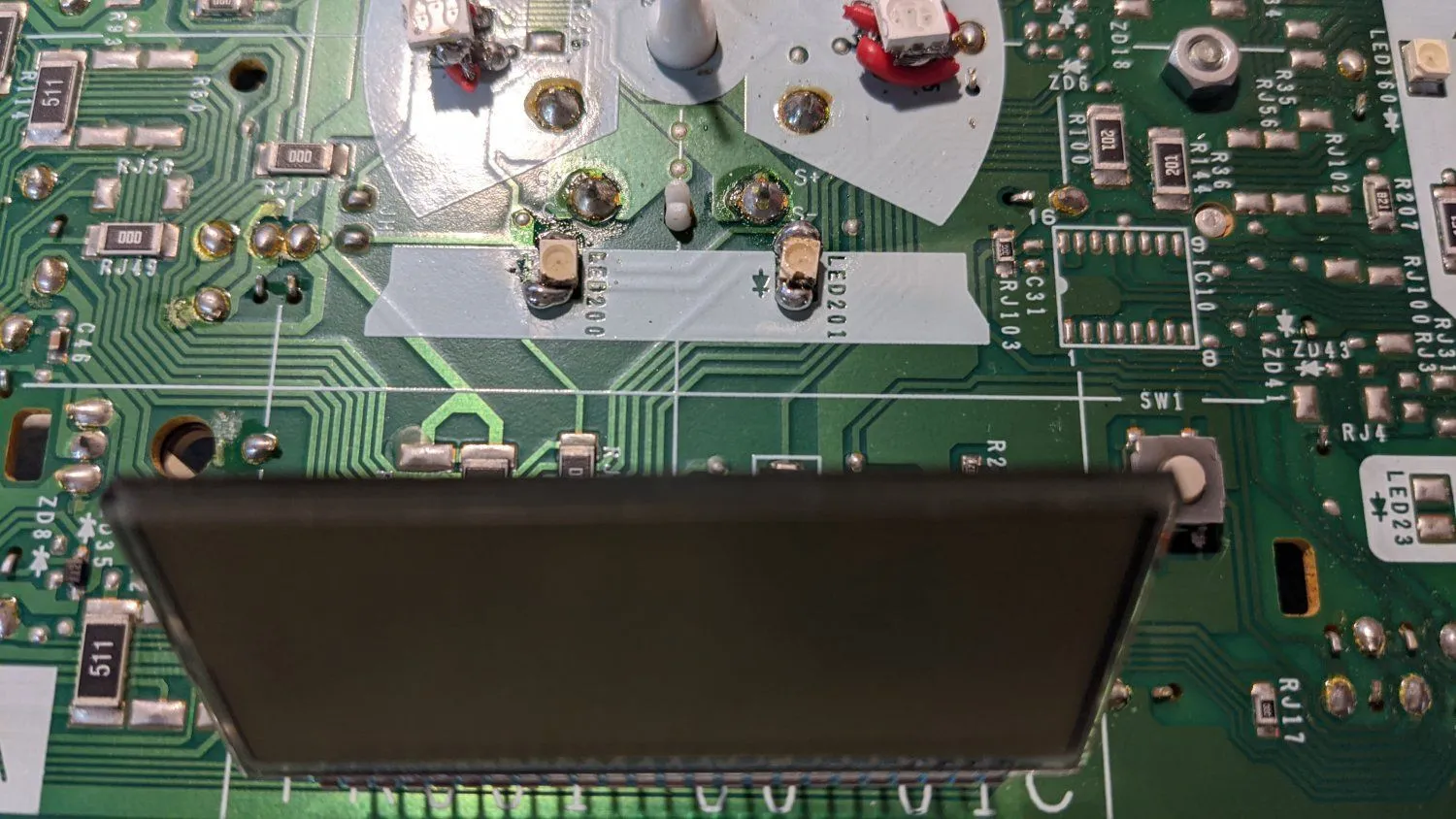

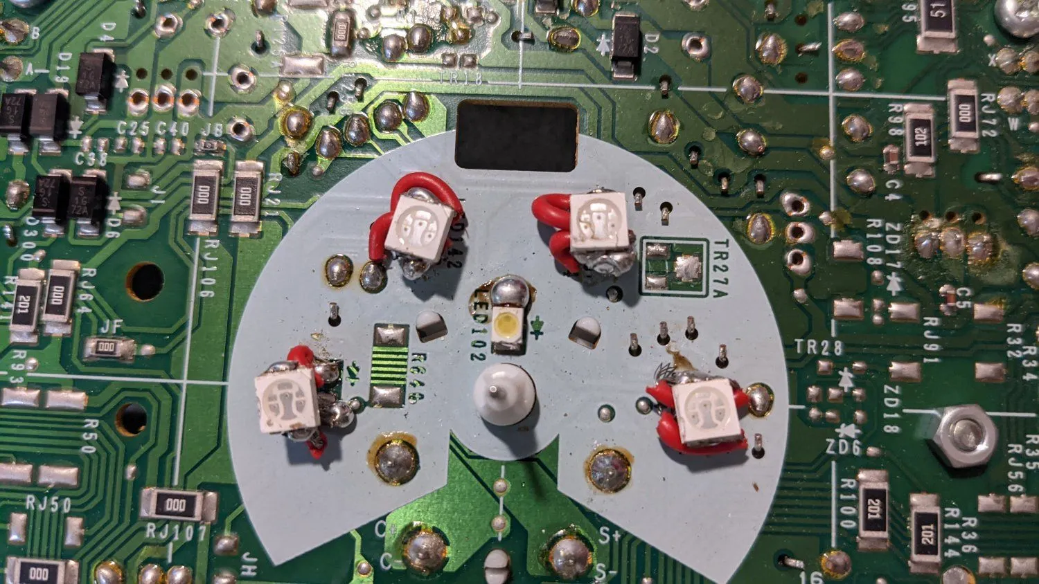

So far Iv mainly taken more apart, interior pretty much gutted and finished my instrumental cluster mod. I wasn't able to do the 08+ cluster without having it reprogrammed to my keys. So I got two 08 clusters from the junk yard and stole/unsoldered all the red and white LEDs of them. Also took apart an old 1157 red led bulb for some bigger brighter LEDs.
Used the blacked out cluster face overlay along with the tinted plastic shade from the 08 as well.
Sanded the orange off all the needles in order to make them lite up white.
After soldering all the LEDs in place the hard part really was making the cluster light up with key in order to see the cluster durning the day. So after alot of testing and going thru wiring diagrams I was manged to figure it all out.
Here are some pics of the assembly
I'll have pics of the finished product tomorrow and in the car all lit up.

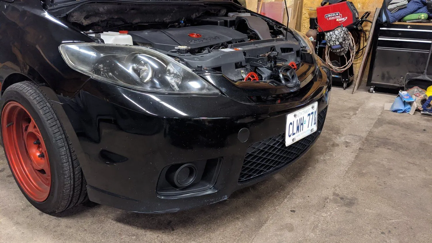

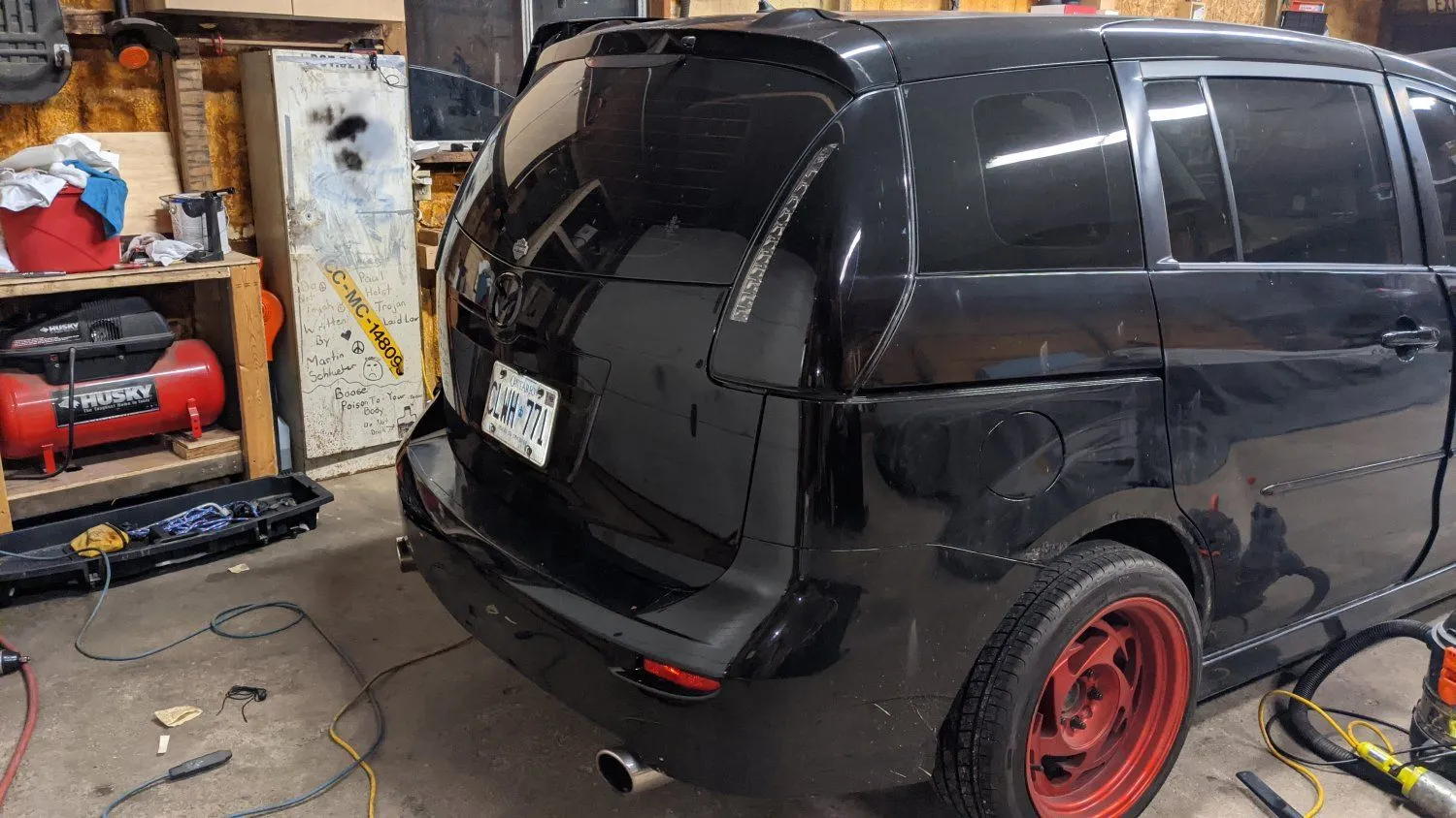

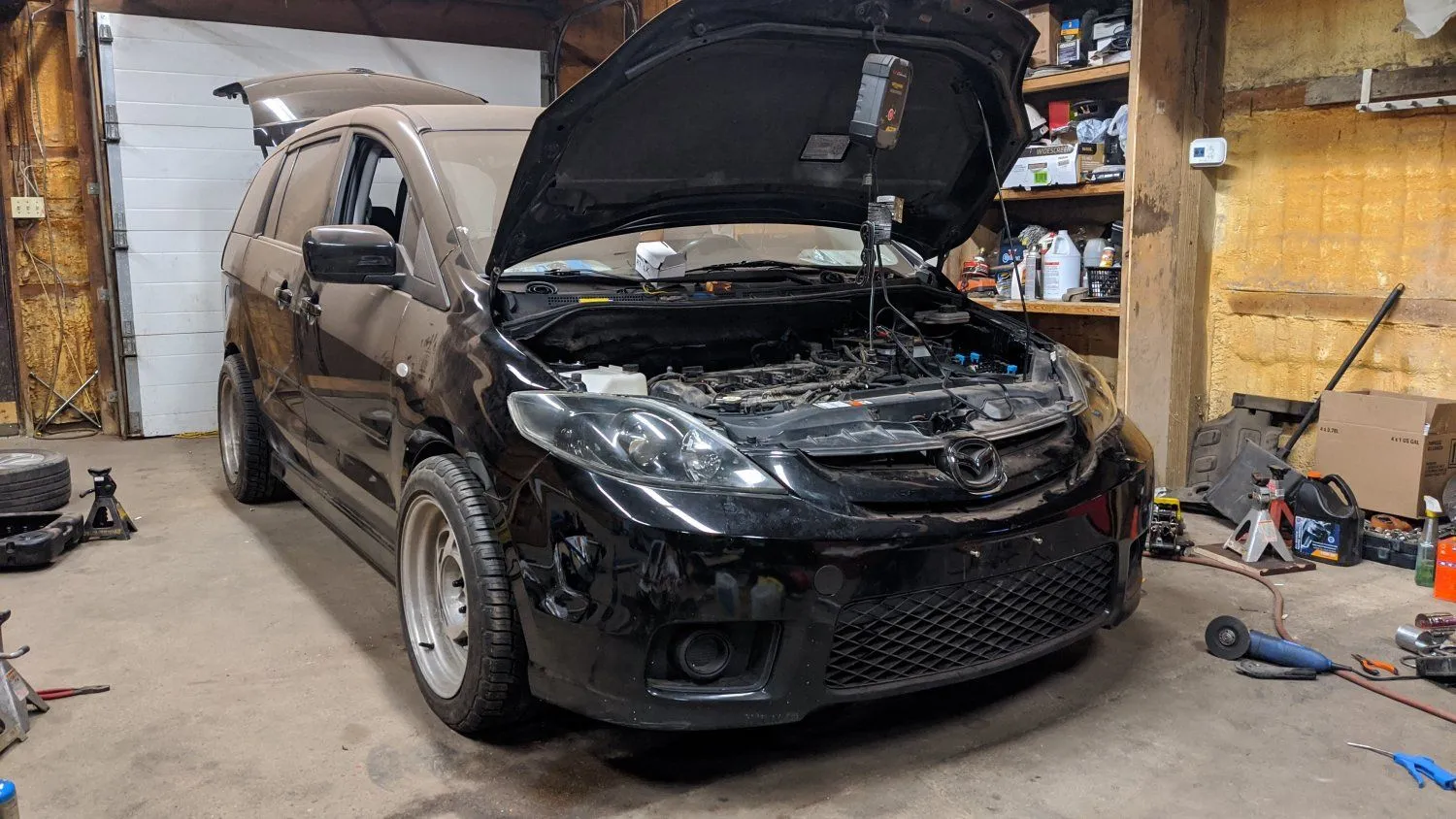

And here is what the 5 looks like now.

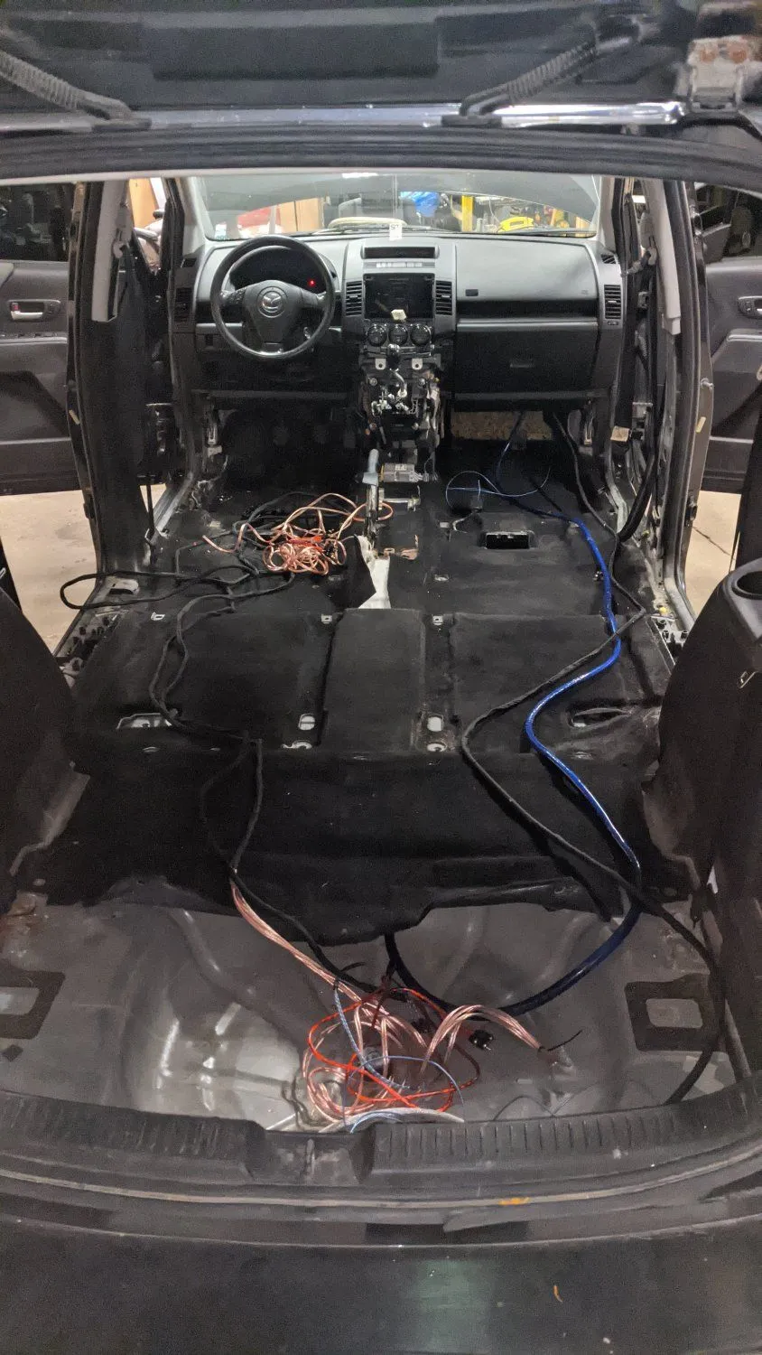

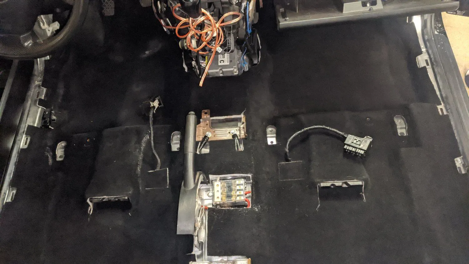

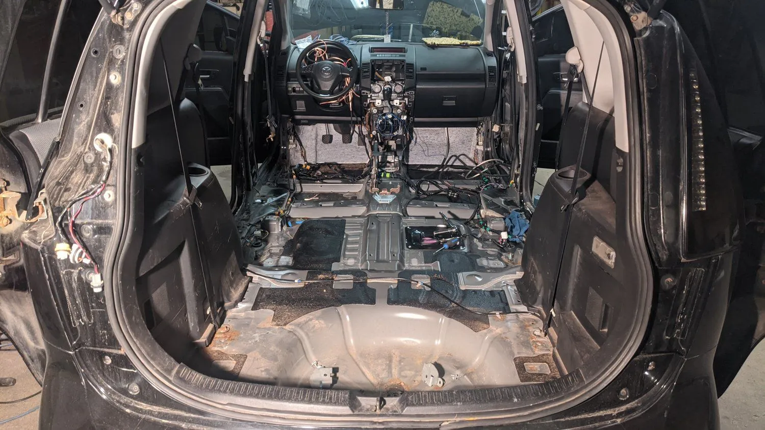

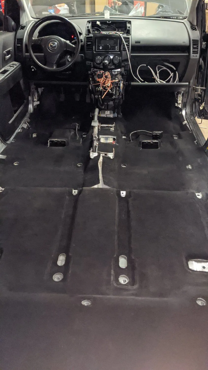

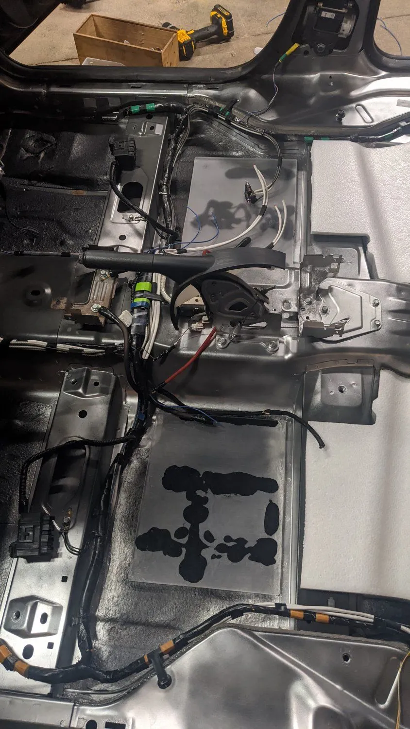

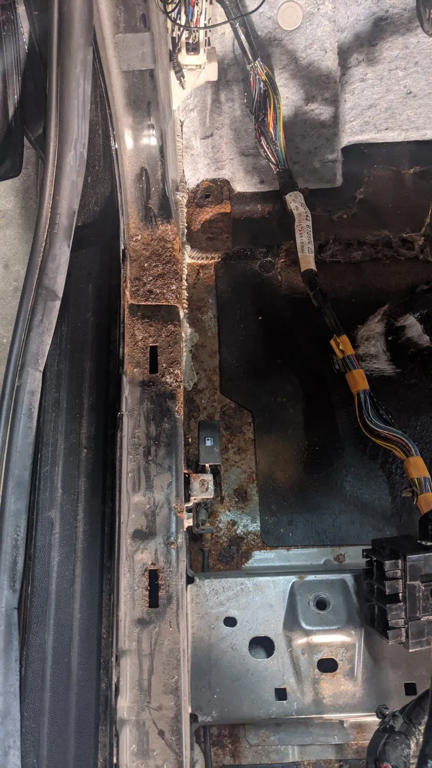

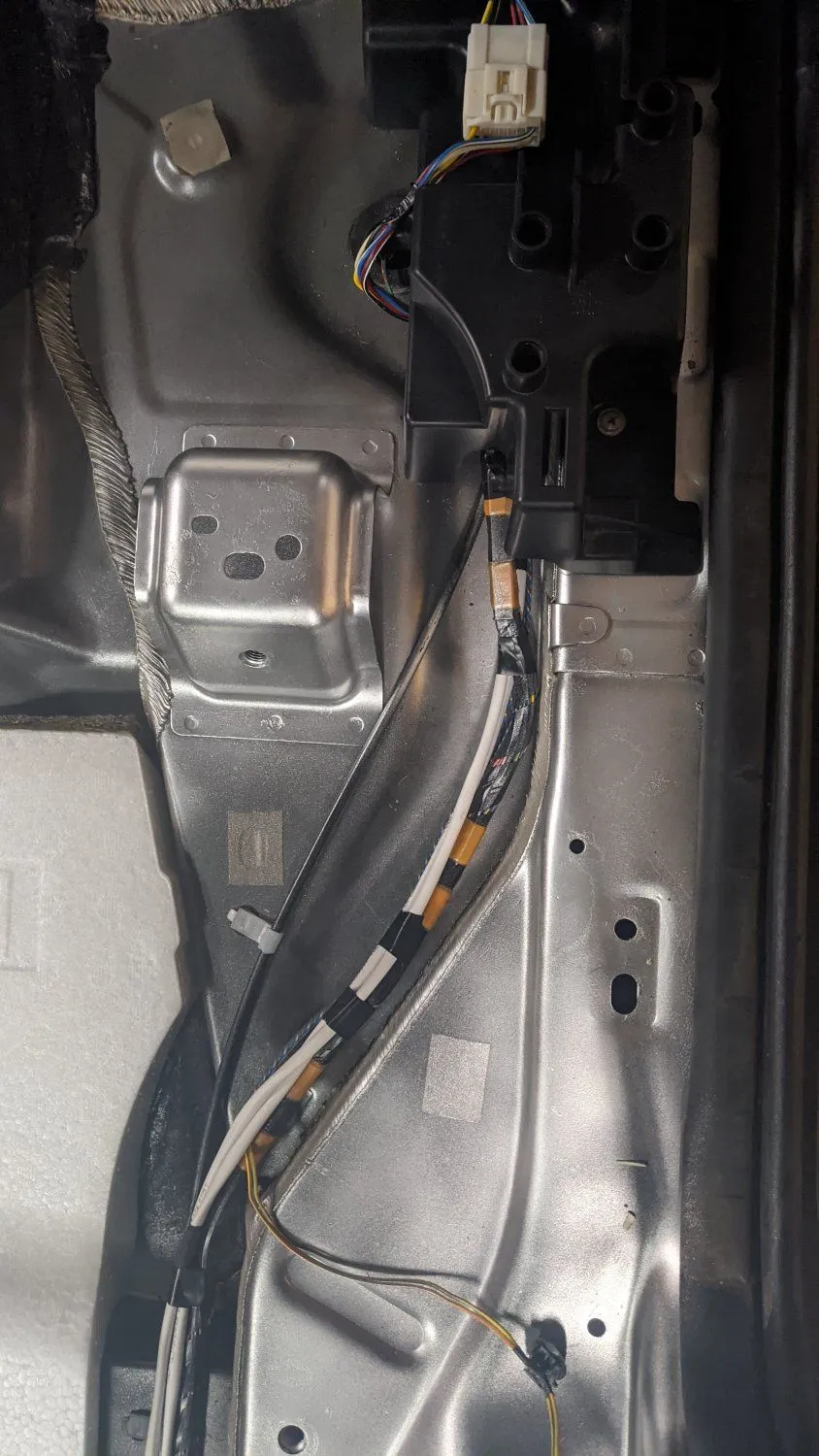

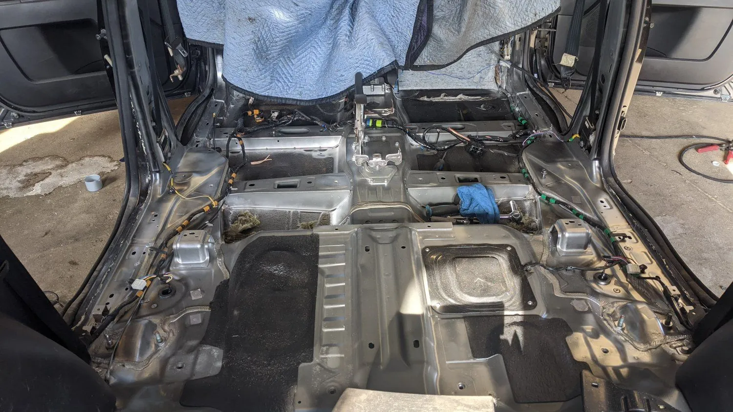

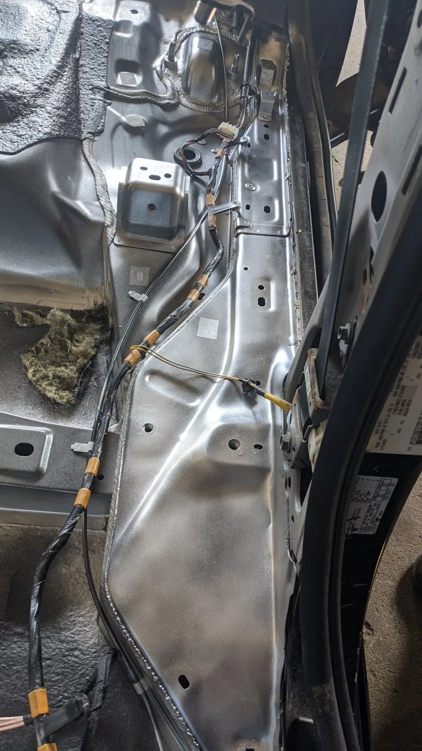

Ended up taking the carpet out in order to run all the stereo wiring along side the factory harness's as there is tons of it to hide.

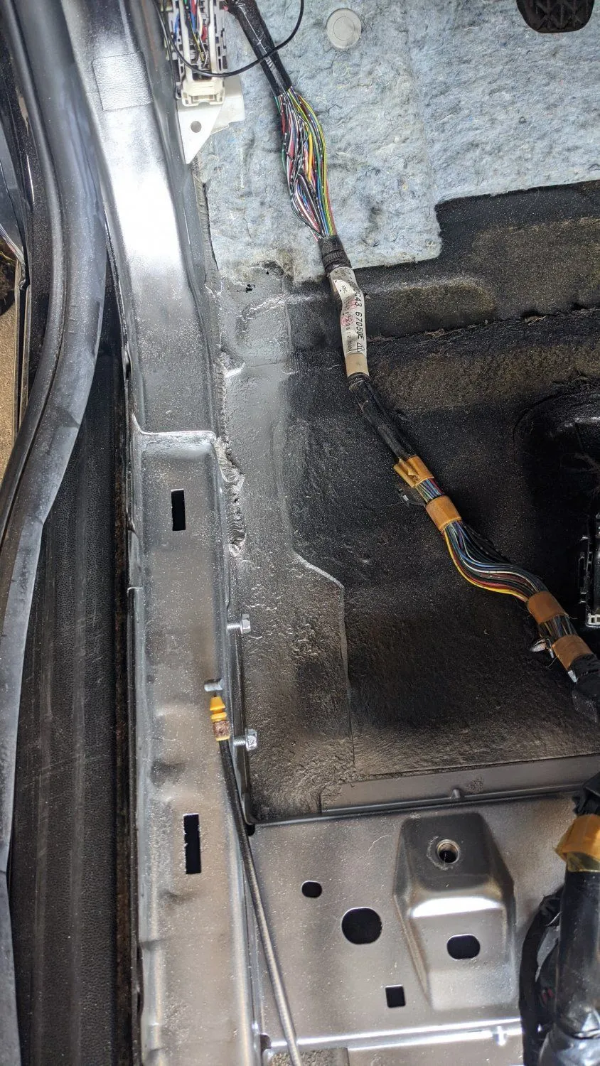

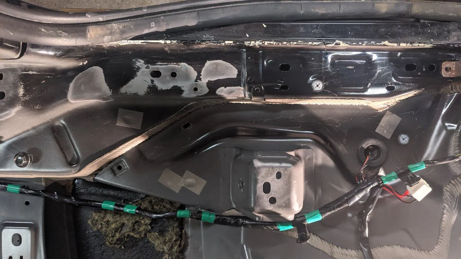

Once I had the carpet up I noticed a bunch of surface rust so while I got it up I'll address that as well. Started grinding some away already. Tomorrow I'll have it all done and rust free.

May I know which portion of the car had rust? I have a 2015 model and think of rustproofing it myself before it starts to be a problem. Was the before and after photos showing the front driver's doorjam?
Yup mostly the driver and passenger side kick panel area. Also where the seat bolts are for both front and middle seats. If you pull up your carpet there are tons of holes to get into areas with some rust proofing. Also where the clips were for the plastic along the bottom door frame were rusty too. Also good holes for rustproofing there

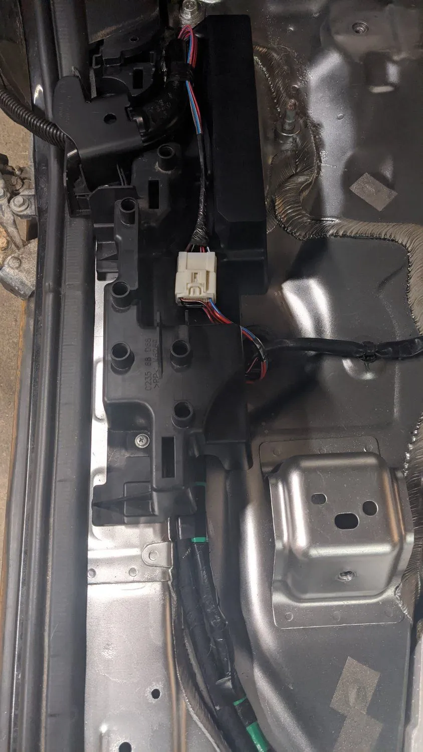

Got all my stereo wiring in finally. Now time to add my amps put all the interior back together and build the sub box.

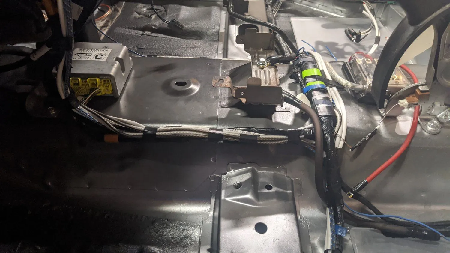

I decided after pulling the carpet up and finding a cavity under each front seat that was filled with styrofoam I'd mount both my highs amps there and the sub amp in the back cubby where the jack goes. I cut the styrofoam out just where it was filling the cavity under the front seats and left it filling the cavity that's in front of the middle seats as that where you would step in and set your feet when sitting in the middle row so that had to stay.

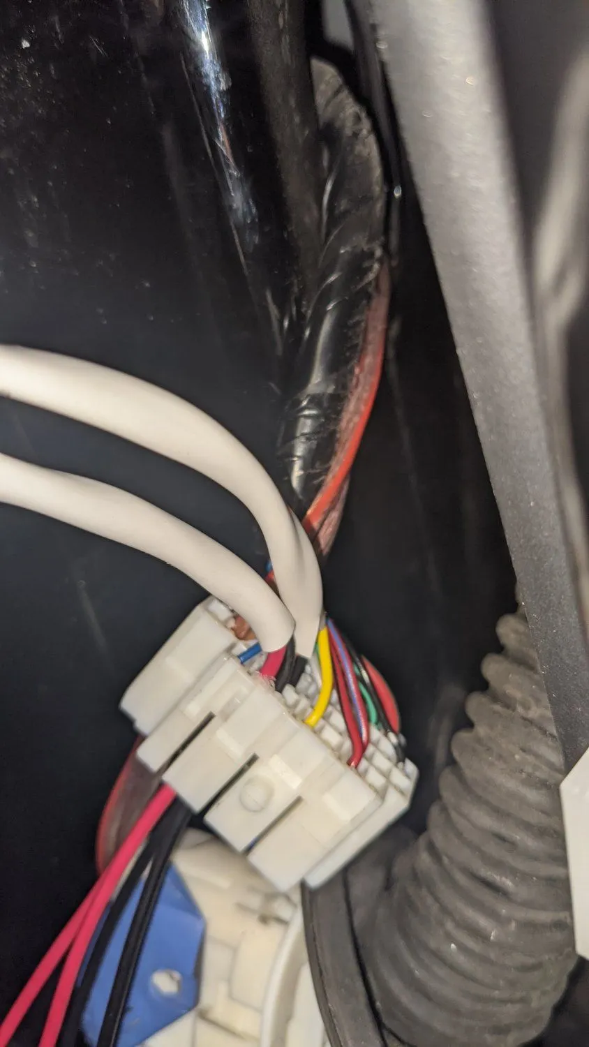

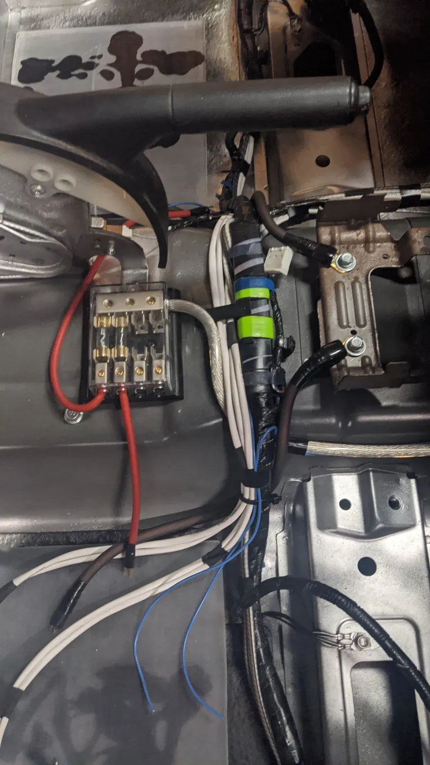

So I went with dual 4ga ofc power wires coming in. One for the highs amps on a fuse distribution block and the other straight to the back to power up the sub amp.
I decided I didn't want to drill/screw the amps to the floor so I made a lexan piece that I urethaned to the floor that way I can screw the amps to the lexan instead.
Here is the fuse box that will be under the center arm Consol. Also set it up so that if I need to replace a fuse I can just lift the cupholders up and out in order to do so

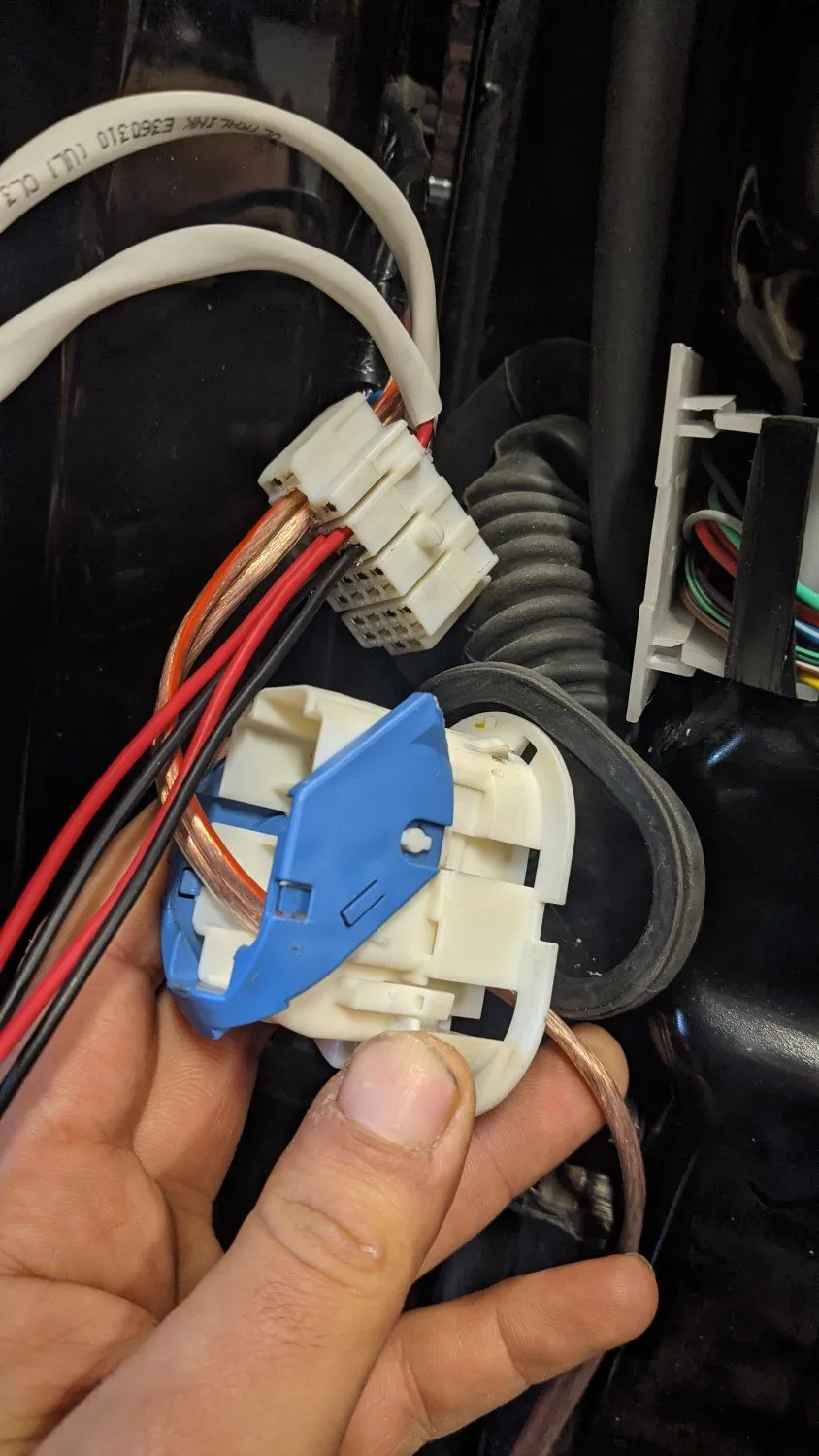

And here is some of the wiring. Note everything was ran along side of pre existing factory wiring so I keeps a pure stealth and OEM look

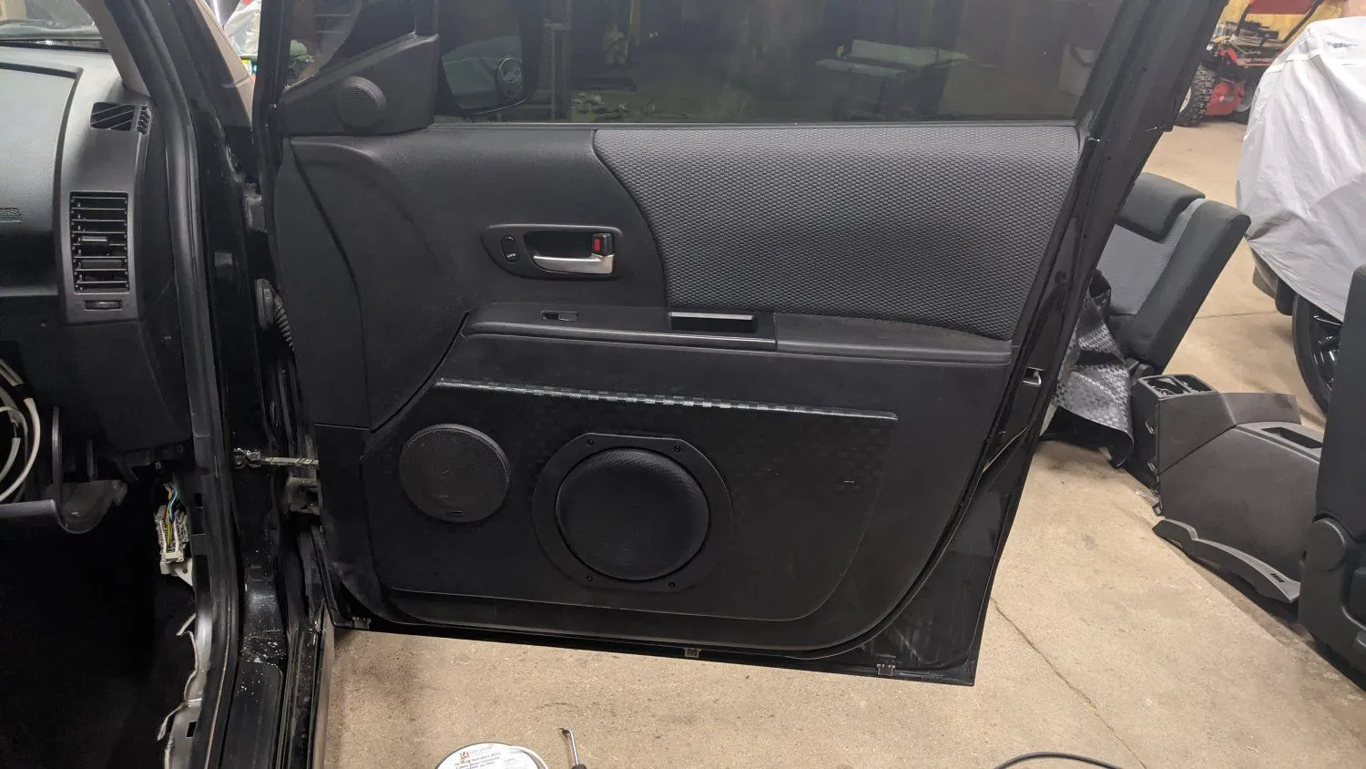

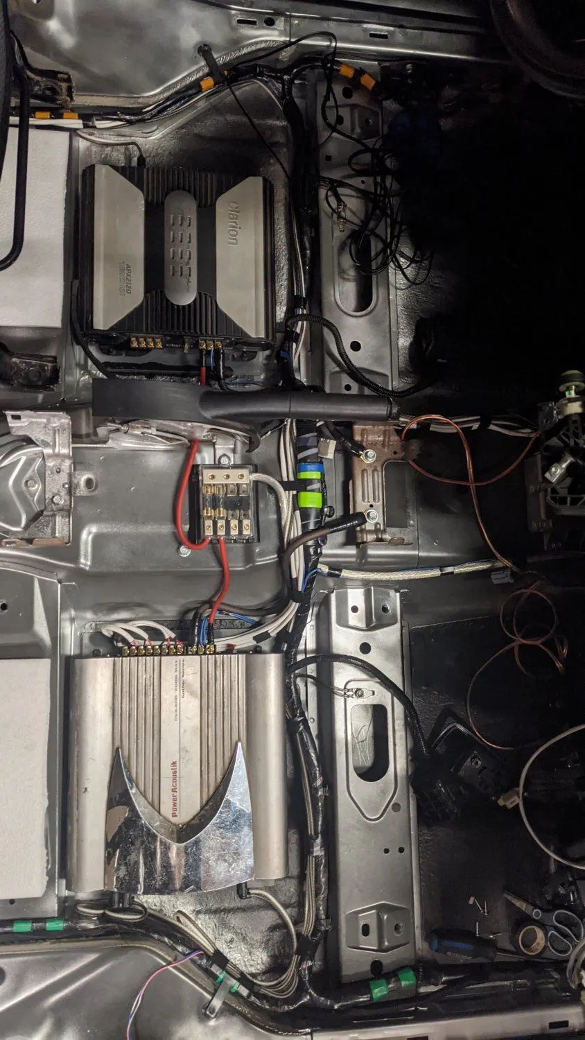

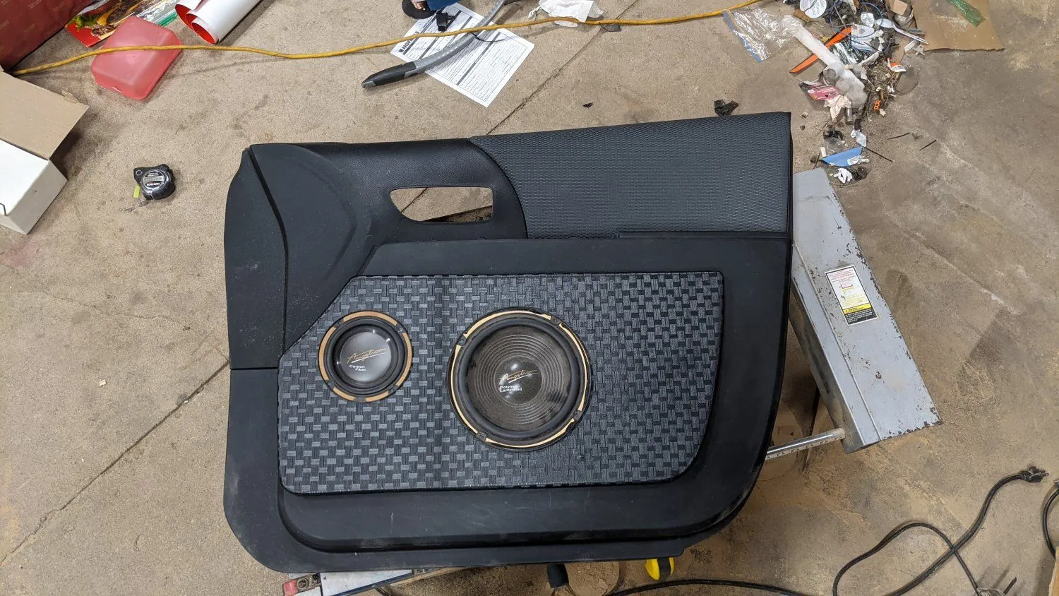

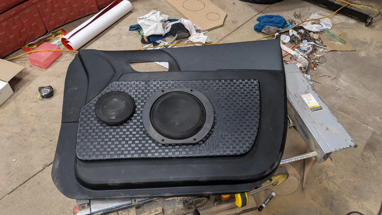

Amps are in and all wired up. Finished the passenger door panel to fit my 8" and 5" speakers.
Now I'm on the hunt for some tweeters that will keep up. Going to check some out tomorrow at a car audio store about an hour from me as I have a set or two in mind for the build .
Here is the amps all mounted to the lexan mounts I made under the driver and passenger seats. Will be totally hidden under carpet.
Running the wires thru the doors was a pain but I managed to drill.out some empty slots and feed wire thru.
Here is the passenger door setup. Need to just finish up the driver side now.

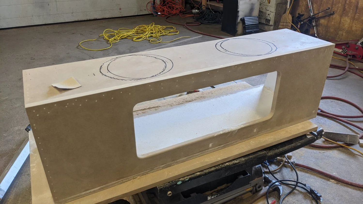

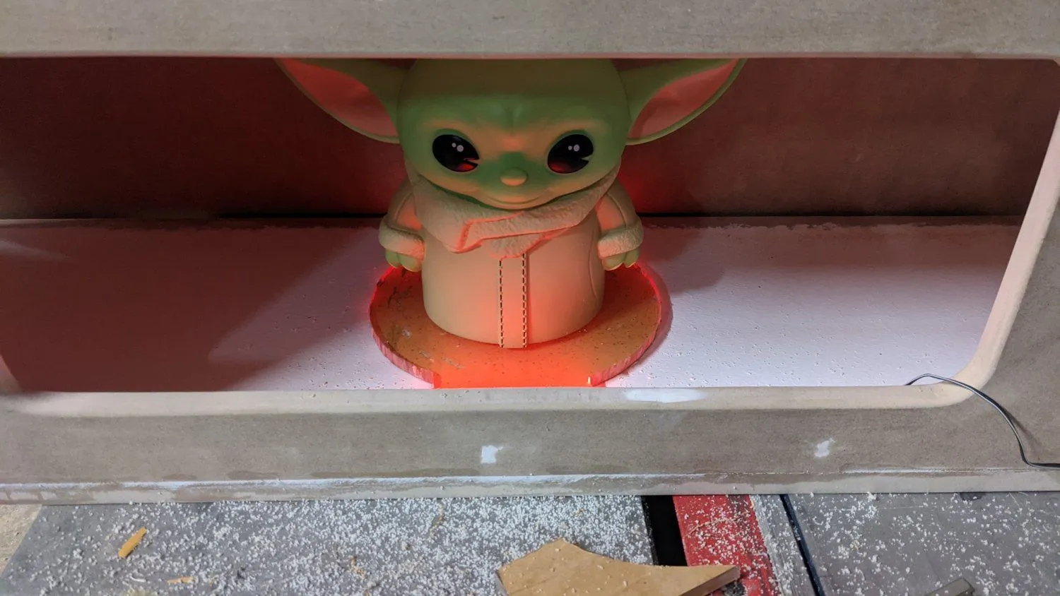

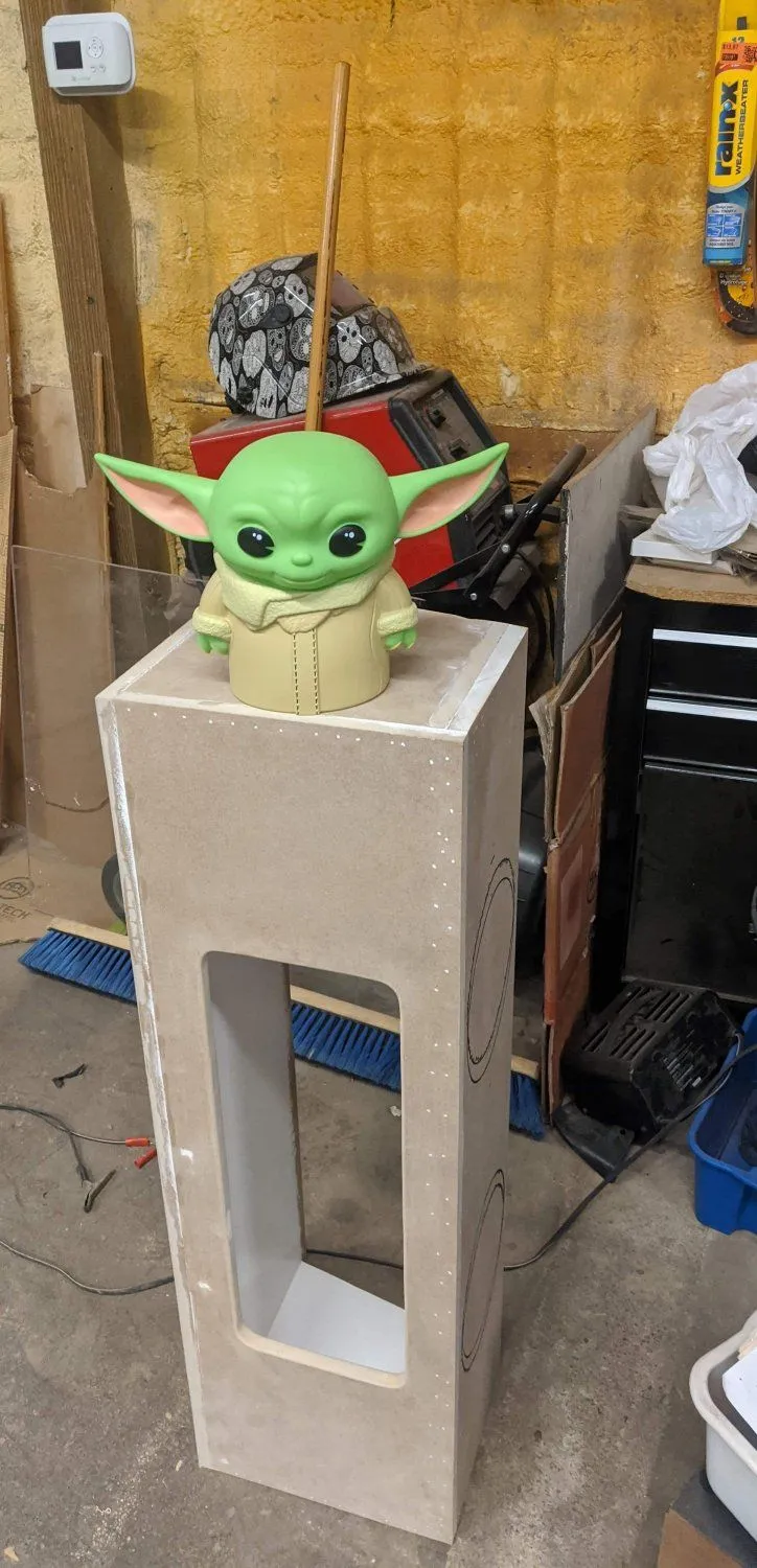

Started my box for my two 8" dbdrive subs. Got a bit of a theme going on with it. I have 6 kids so I figured they would enjoy it. Plus it's something different.
Also iv been trying to upload a video nuts it won't let me. Just keeps saying "oops something went wrong" not sure if it's me or site?
And the wife got me a custom bass knob made for my birthday to match.

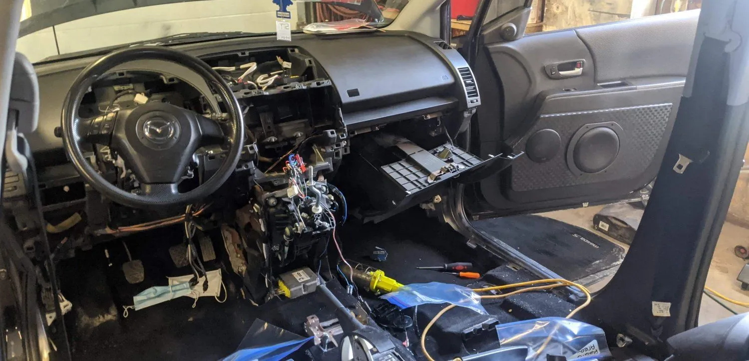

We have a new update to the Mazda, decided I needed to pull the dash because the speakers were just not enough. Now I'm putting another four in the top of the dash! Sucks that I got to pull the whole dash just to cut four holes. LOL
