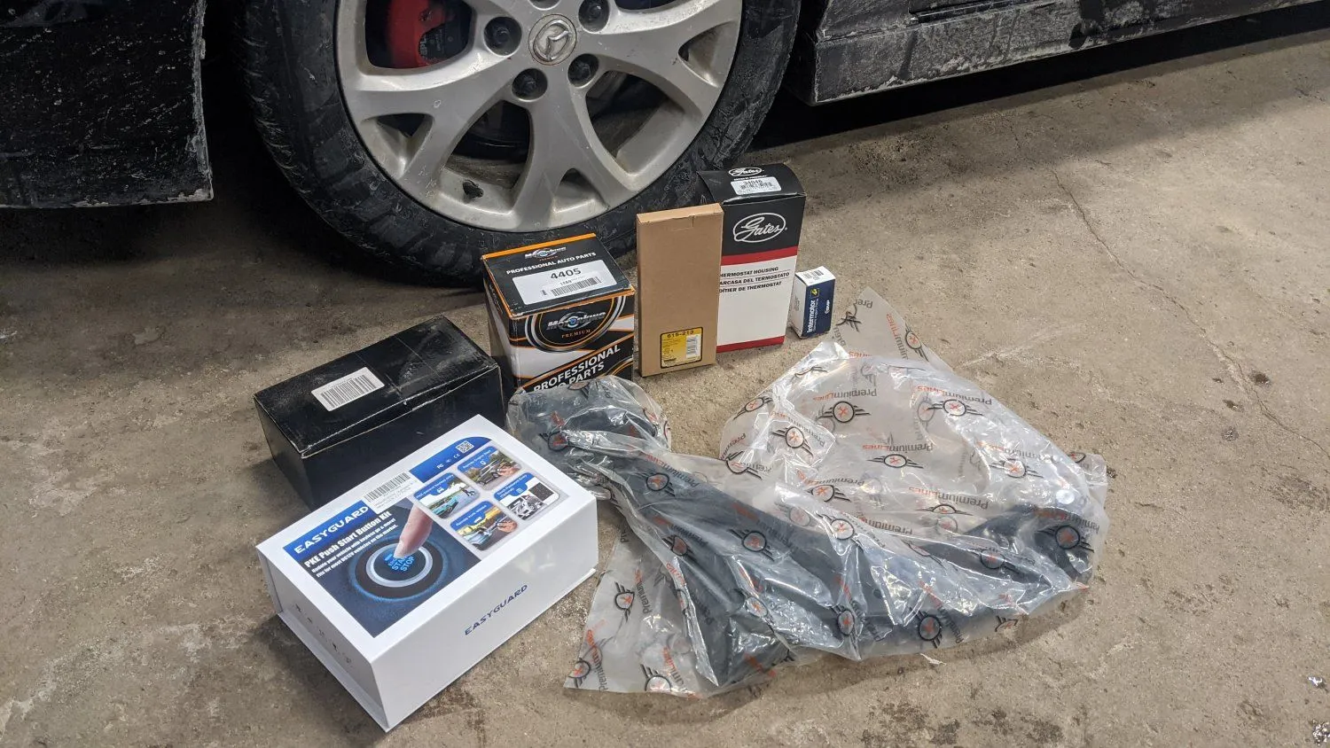

Got another update here on the Mazda bought some more parts for her. Picked up a driver side control arm, thermostat, intake gasket kit, bottom motor mount, PCV valve, oil catch can and I got an easyguard pke push start alarm system for her. No need to ever touch the key again the alarm system will be a nice touch with the push start and the passive arming and disarming.

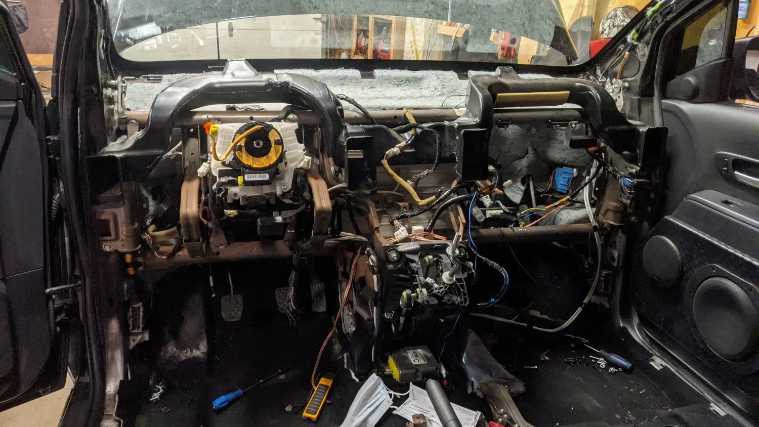

Also I should have some pictures shortly of the rear with the stereo upgrades got half the dash out already but then got some more power wire for the stereo yesterday so I started finishing up the back.

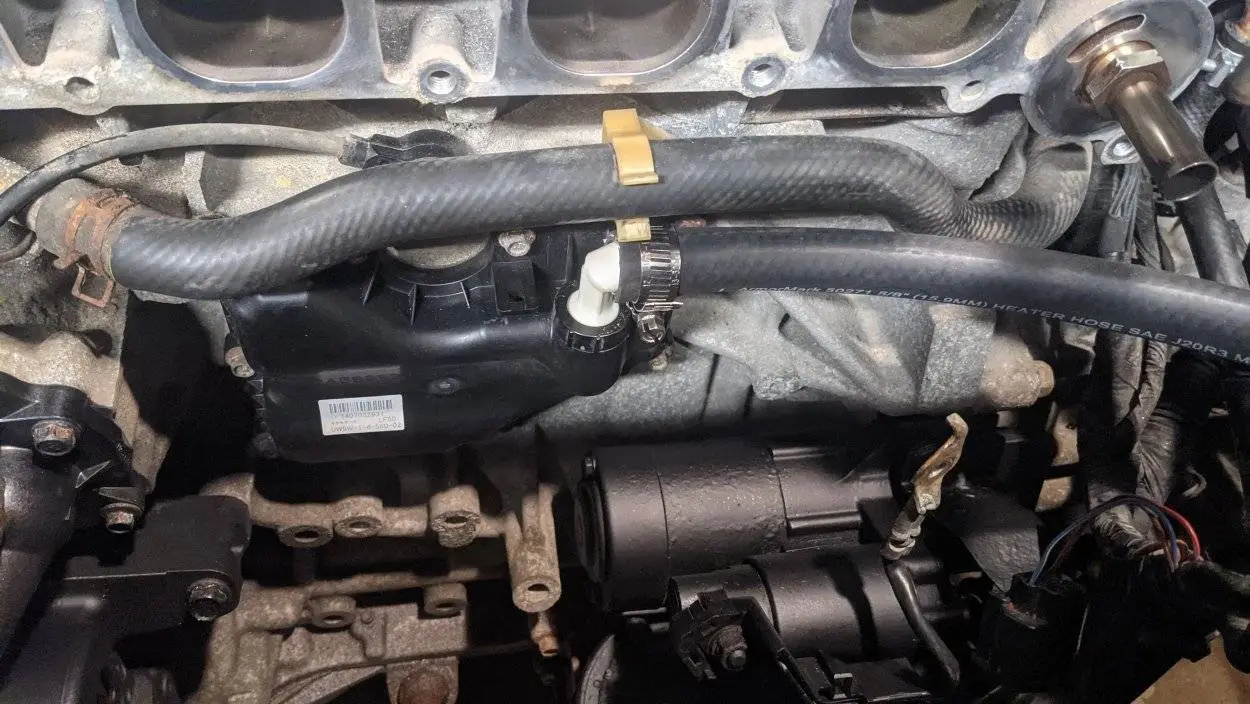

I can't seem to find an easy way to reach the pcv valve. To me it looks like the whole front end of the engine bay will need to be pull apart. I hope you have a better method for it.
Yup you need to remove the intake manifold in order to get to it as it's under it that's why I had to buy the intake gasket kit.

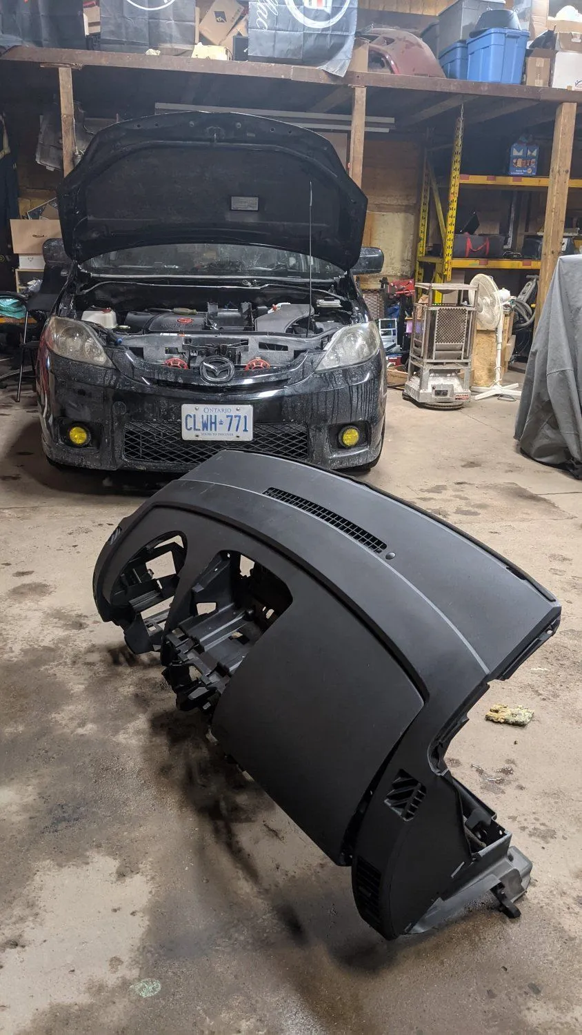

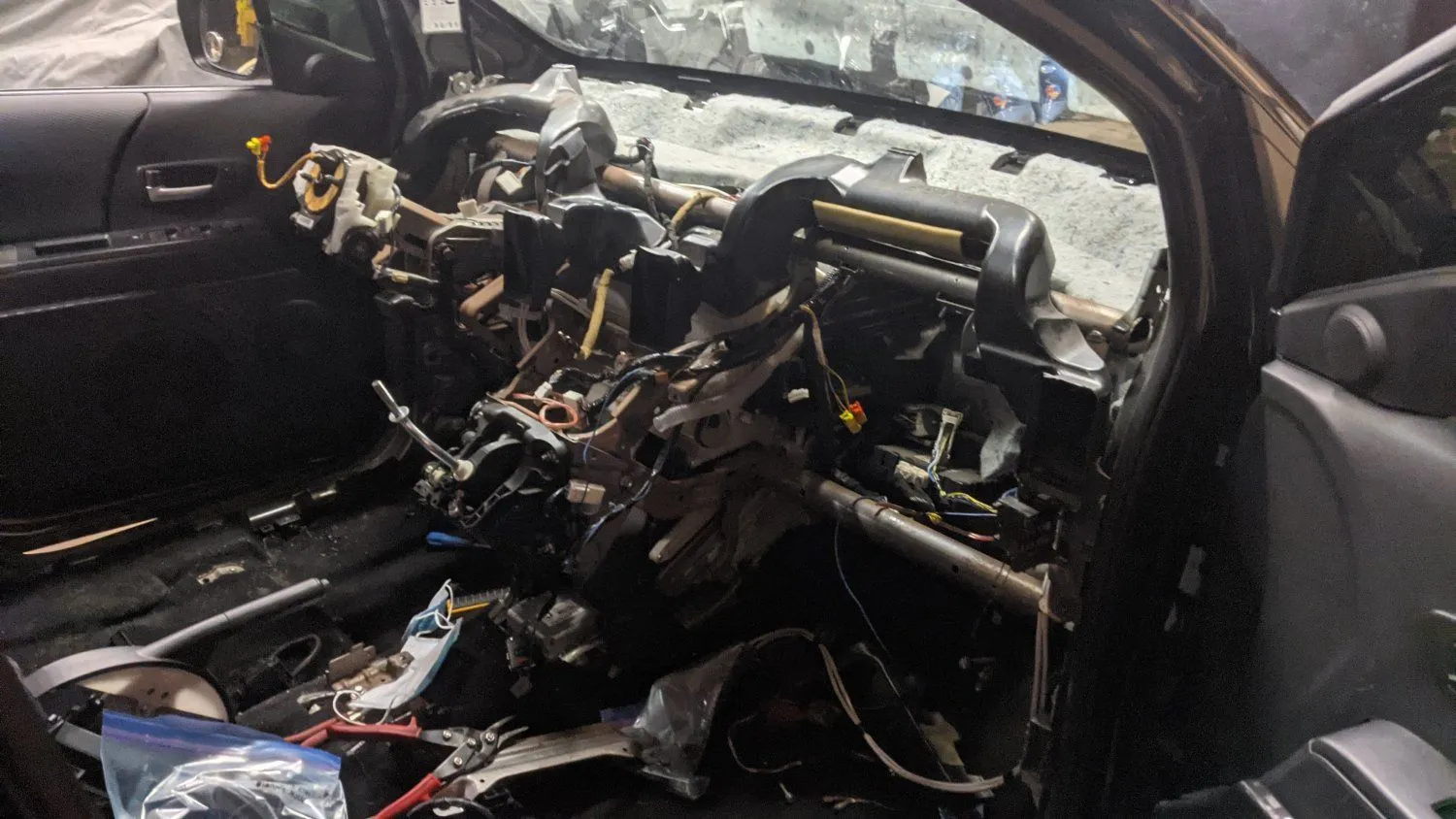

Got the dash out finally!!! Been cold here the last few days and my shop is on propane for heat so I haven't been out there much in order to save on the propane.
I must say tho, it was a really crappy job to do! Only worse car iv done aside from this was an early 2000s Jetta but will be all worth it in the end.
Also noticed there ant much room depth wise at the top of the dash where I want to put the speakers. Looks like I may have to fab up a bracket/spacer to make it work.

My pke alarm is fully installed just need to finish buttoning up the interior and some more of the audio system with the new amp I got.

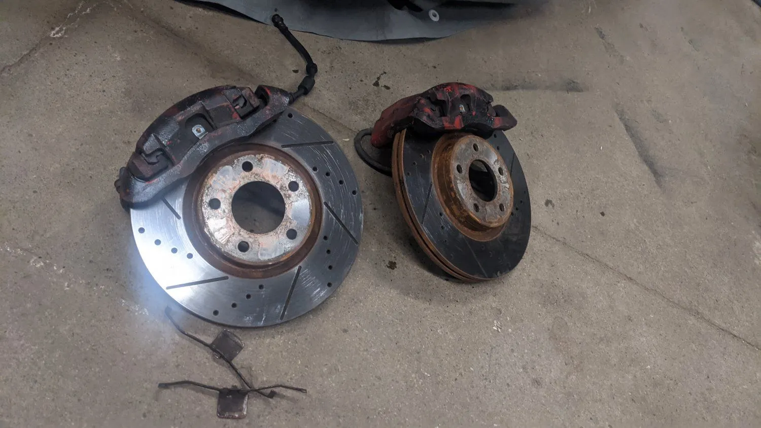

Happened to find a set of Mazdaspeed 3 complete front brakes with calipers rotors and pads. So I'll be doing that swap real soon. I also happen to find a throttle body spacer near me that was dirt cheap brand new in the box so also be putting that on.
I will be starting the intake manifold, PCV valve and catch can install soon so I'll make a thread right up on it.
Also happen to get heated seat kits one for every seat in the Mazda but I may just do the two fronts and middle cuz I have to take the whole seat apart in order to install them will probably be a bit of a job.
I always feel Mazda 5 lack decent braking power with factory setup. I wonder if it is because they use the same brake setup from the Mazda 3 of the same platform. The lightest Mazda 3 of that gen is 2,800 lb but Mazda 5 is 3,400 lb. That's like Mazda 3 with three adult passengers sitting in the car all the time!
That my friend is exactly why I wanted these! Since I've had it I've always felt like the brakes lack huge.
I also drive a newer BMW and the brakes on BMWs are insane and I have a bigger brake kit on my Eclipse as well, then our other car is a newer Cadillac which also has really good brakes. So I kind of just wanted that in the Mazda. Every time I get in the BMW after driving the Mazda the first time I break, I almost eat the steering wheel because I forget how good they are compared to the Mazda LOL

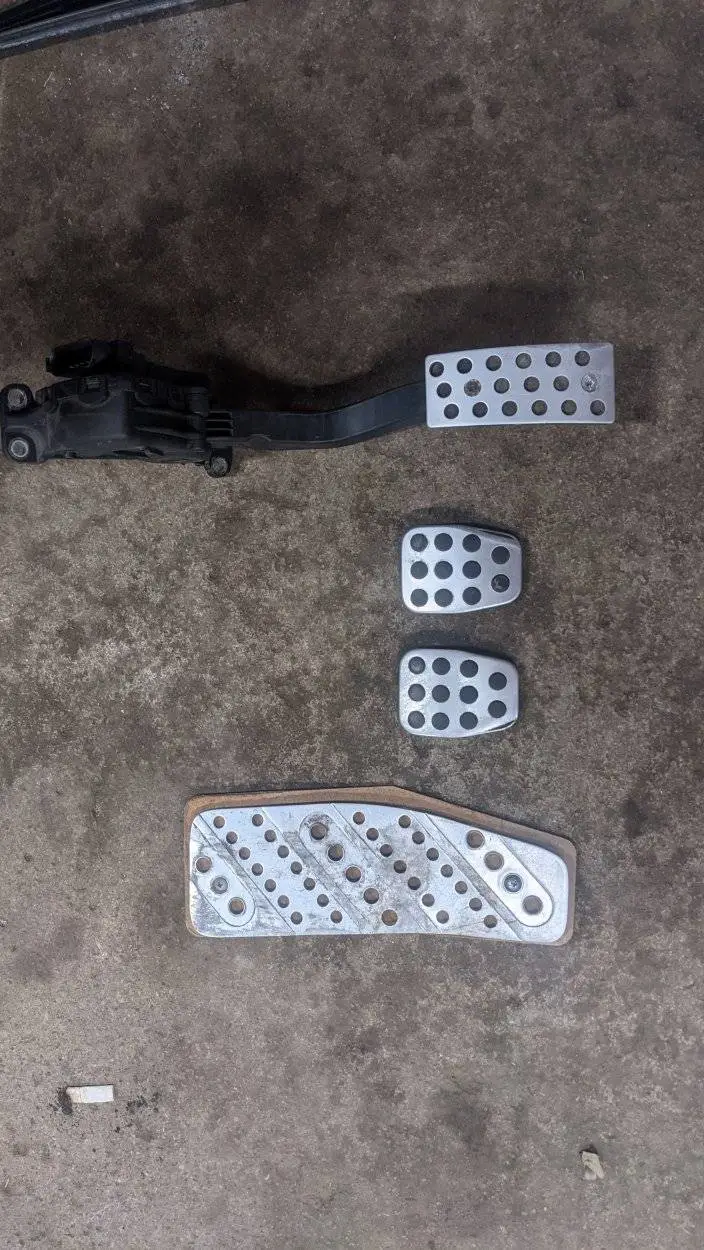

I picked up Mazdaspeed 3 gas pedal assembly today along with the pedal covers for the rest and the dead pedal. Also finally got a hold of a nice rear wiper motor with arm cuz mine has been missing since I bought it and the factory fog lights as well!

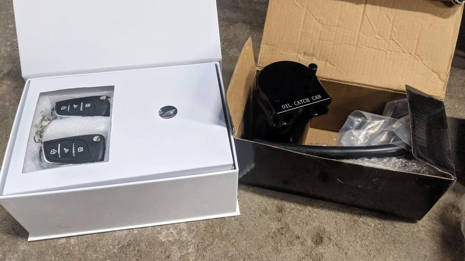

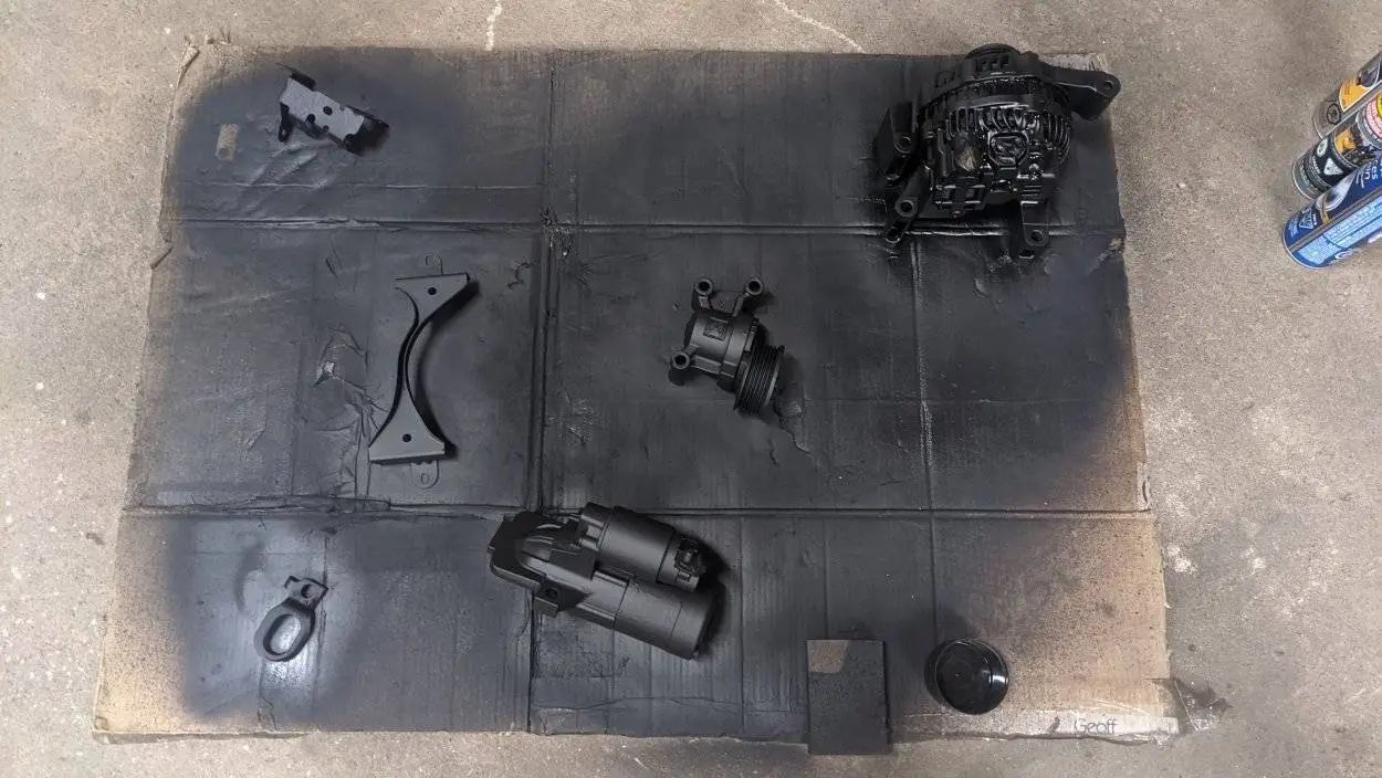

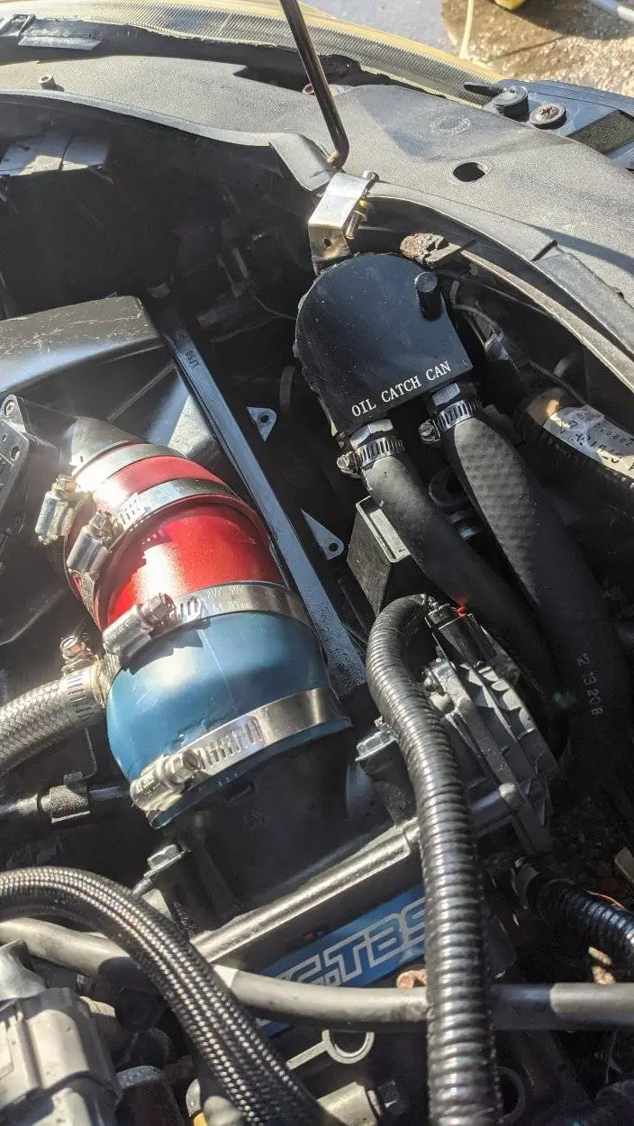

I also started my PCV valve and catch can and while I was at it I cleaned and painted everything flat black that I could to make the engine bay look nice and clean.
Here's some pics of all the engine stuff I've been doing.
The before.
Painted the passenger engine mount, alternator, starter, tensioner pulley and a few little brackets.
Got my new PCV valve in and my hoses ran for my catch can. look how beautiful that alternator and starter looking flat black ☺️
Then I cleaned up the intake manifold and some of the brackets and hosings and stuff to make everything look new again.

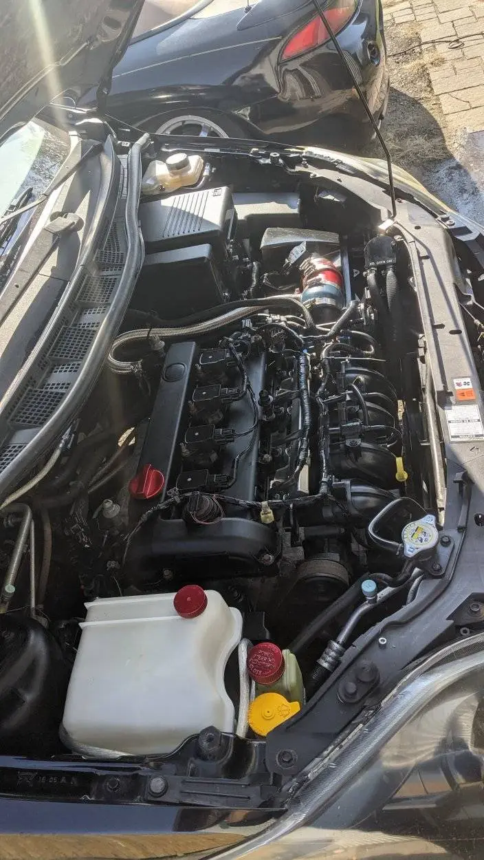

Here's a picture of where I'm at right now. She definitely looks 10 times better with everything flat black and clean.

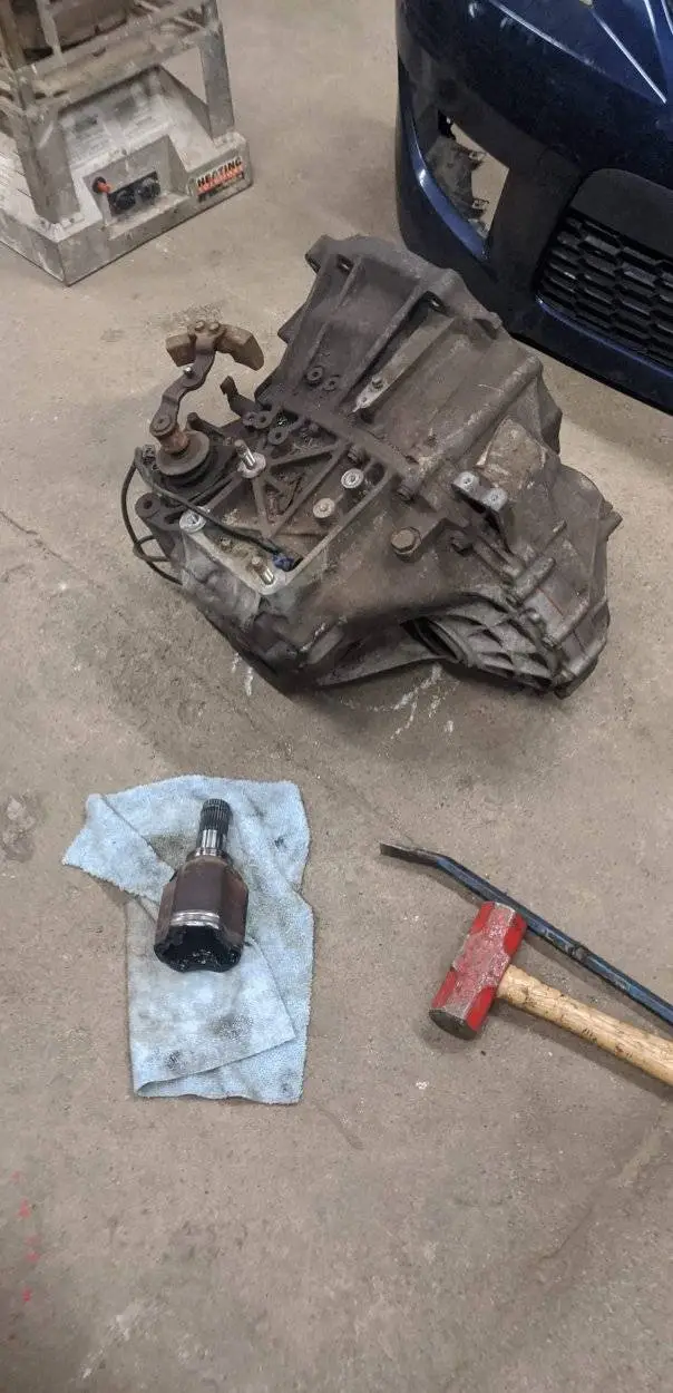

I also got a little gift today from a buddy and he gave me a 6-speed transmission from a Mazda speed 3.
So if anybody knows is any good write-ups of putting the mazdaspeed transmission on a regular 2.3 please point me in the right direction. I know it bolts up but I'm wondering if I can use my factory flywheel, pressure plate and disc or if I have to get the Mazdaspeed 3 stuff. Here's a pic of the tranny, he couldn't get the rest of the CV shaft off but it took me about 10 minutes and I got that sucker out LOL.
So hopefully soon I'll be getting that swap on the go.

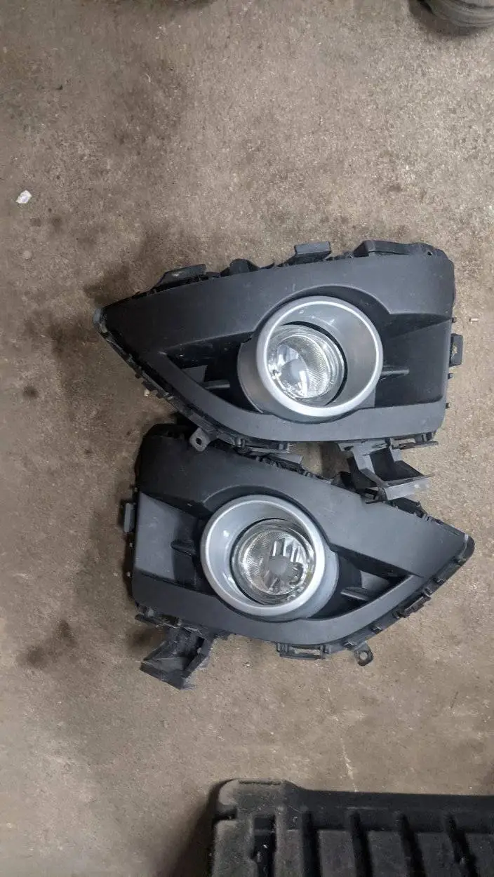

I also got a newer style from bumper from an 09 and the fog lights as well so I'm actually going to try to paint this whole thing myself I might go all flat black maybe some of you might have some ideas on what I should paint it it will be my first attempt that actually painting an entire car.

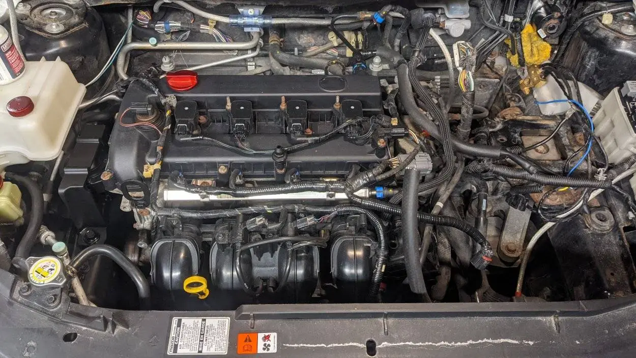

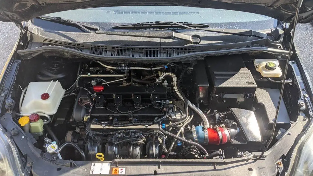

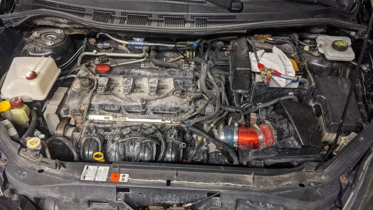

Well another update on the Mazda! Must say my engine bay clean up and painting was a success!! Very happy with how it came out it's a huge difference compared to what it was when I got it. Also got my throttle body spacer in in my oil catch can all done.
Ended up cleaning out the intake manifold as well got all the carbon out of it, replaced manifold gaskets along with throttle body gasket, installed my new thermostat as well, put a drop in k&n filter in the air box, I also already have a custom pipe to feed the air box from the front grill and cleaned up every single ground under the engine bay.
She starts up on a dime now that was a big improvement! Also replace my abs module as well and my brakes are all good now no more soft pedal yay!
Hear some before and after pics.
The before
The After.

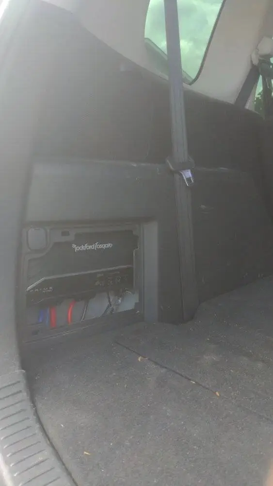

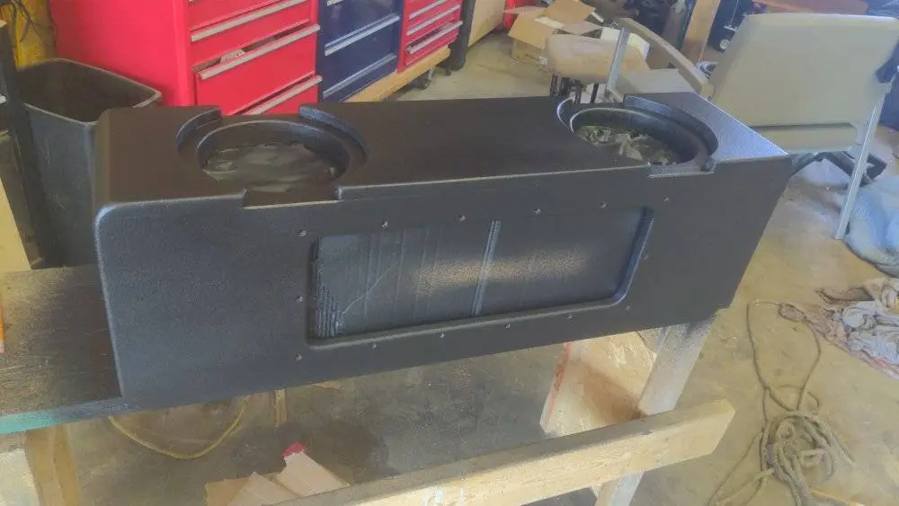

But quick update my subwoofer box is almost done. I just finished painting it, now to let that dry and then I can stick her all together.
I completed most of the interior off in the Mazda as well my gauges are all done custom red LED even the infotainment which I made my own clear red plastic piece to slit in between that makes it light up red.
I also got my custom bass knob installed as well and my sub amp plus my capacitor.

The sub box almost ready!

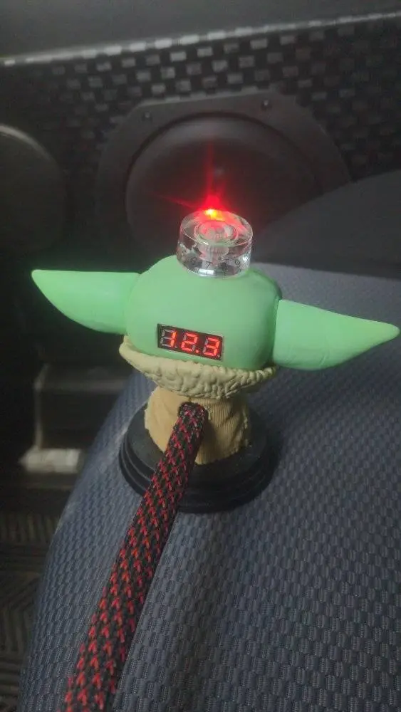

My custom baby Yoda bass knob.

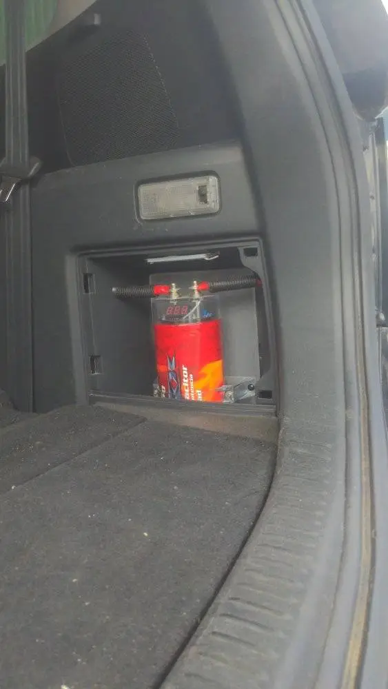

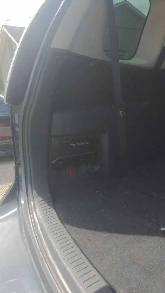

The sub amp and capacitor all hidden away I'll be making a little window with a plexiglass piece to show them off. They're also in their perfect so I can put the plastic panels back for now and you don't even notice that anything is back there at all.

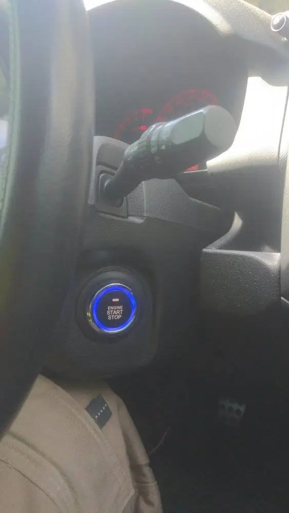

The push start button and alarm system I put in with pke passive arming and disarming.

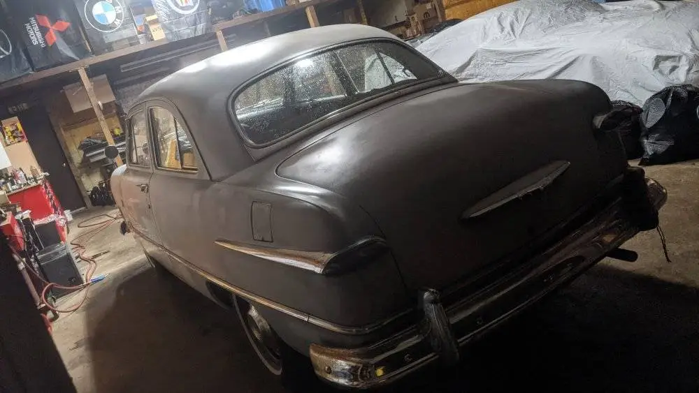

And last but not least our newest member of the family. I present to you my newest project a 1951 Ford Custom Tudor sedan with 3 on the tree shifting and a flathead V8 😁
