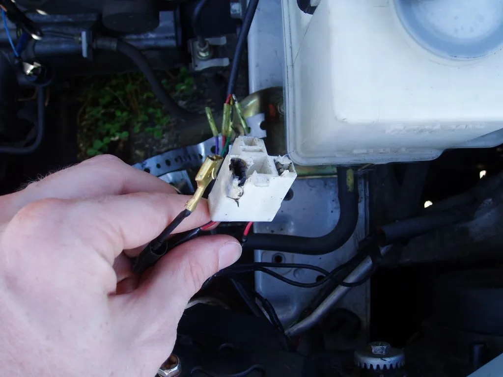

And finally, the car seems like an electrical nightmare as the alarm is disconnected but hanging to the radiator core bar via a wire, every peice of wiring i've seen seems to be wrapped in electrical tape. They didnt use a stock light mount when they repaired it it seems, so the ground (3rd plug?) slipped off, it arced and melted the plug off the light. So i need to find a wiring harness for the drivers side headlight and replace it all. And the wires under the dash are a messy nest of electrical tape, bad connections and switches that dont seem to do anything.

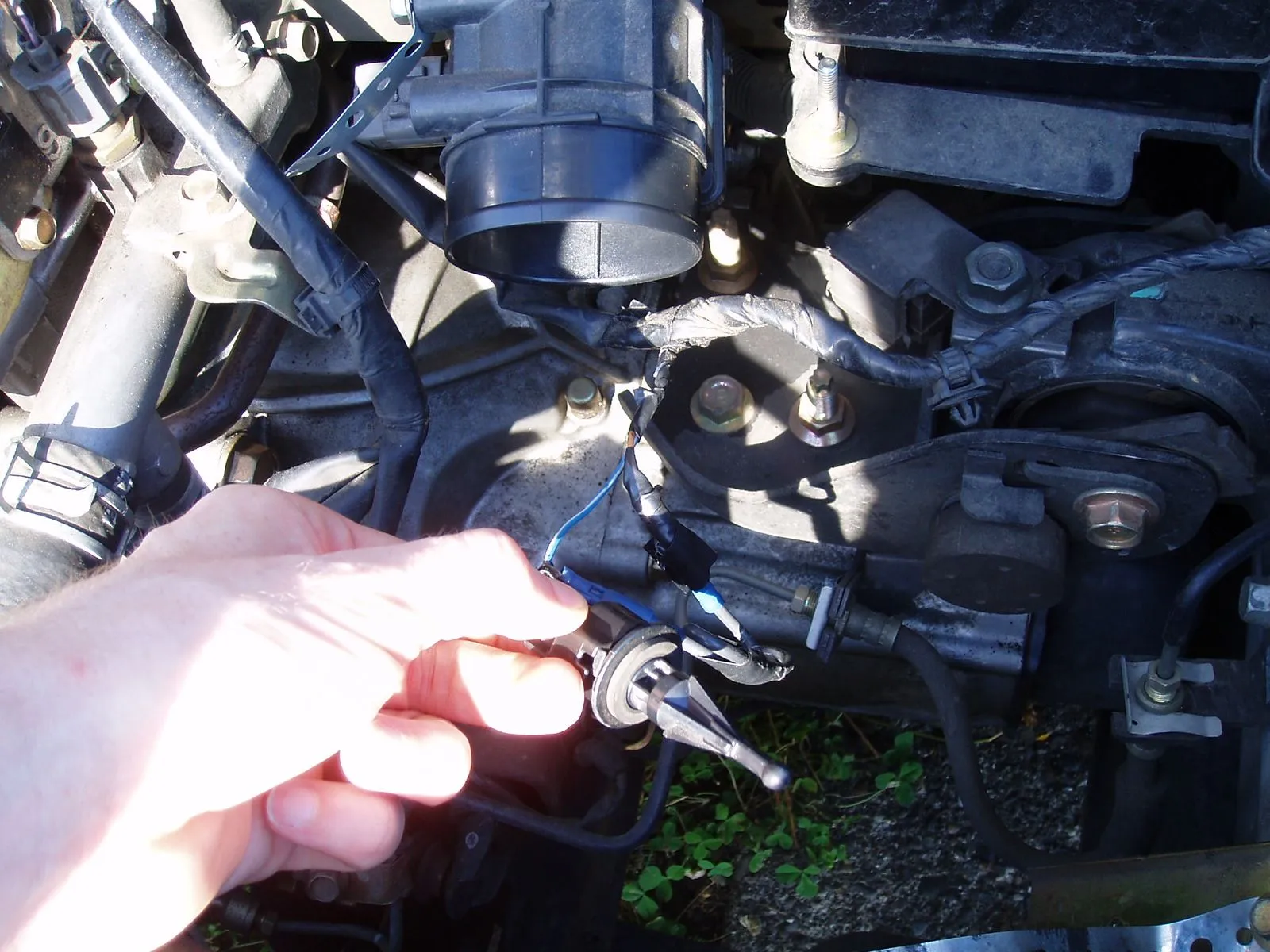

These 5 are of the 'under the hood' electronics. Upon further examination, it looks like the electrical plug doesnt actually fit the bulb at all. The 3rd contact isnt the right wire on either side. Which makes me think that they just went to a junkyard and got the peices from some other car that uses the H7 bulbs. Just a guess.

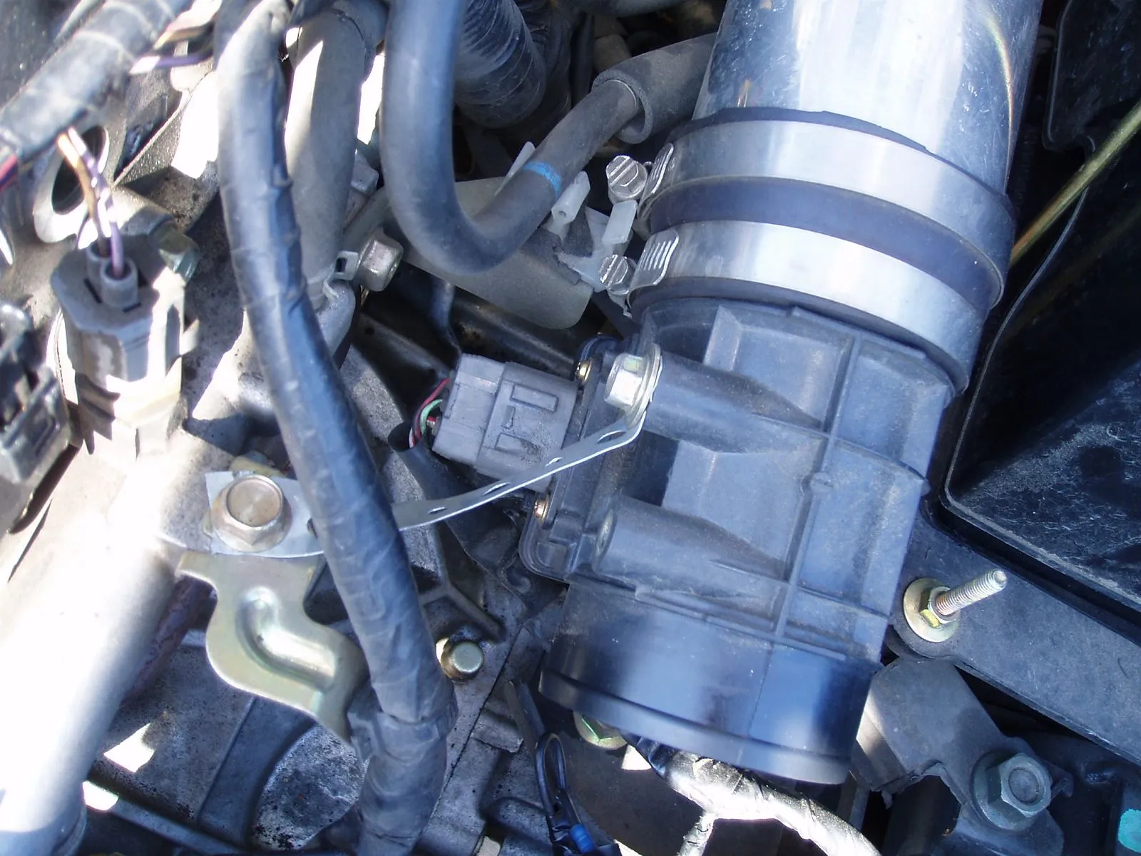

The first picture is the thing that was inside the air filter. I took it out so as to make a better seal for the air filter. In the 2nd to last picture you can see it sort of ziptied up next to the battery.

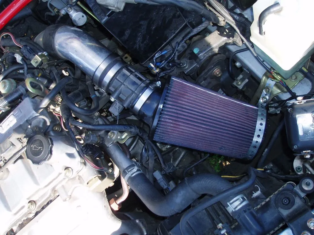

The 2nd pic is the intake uh... tube. sorry no technical lang. That seems to have the right hookups on it.

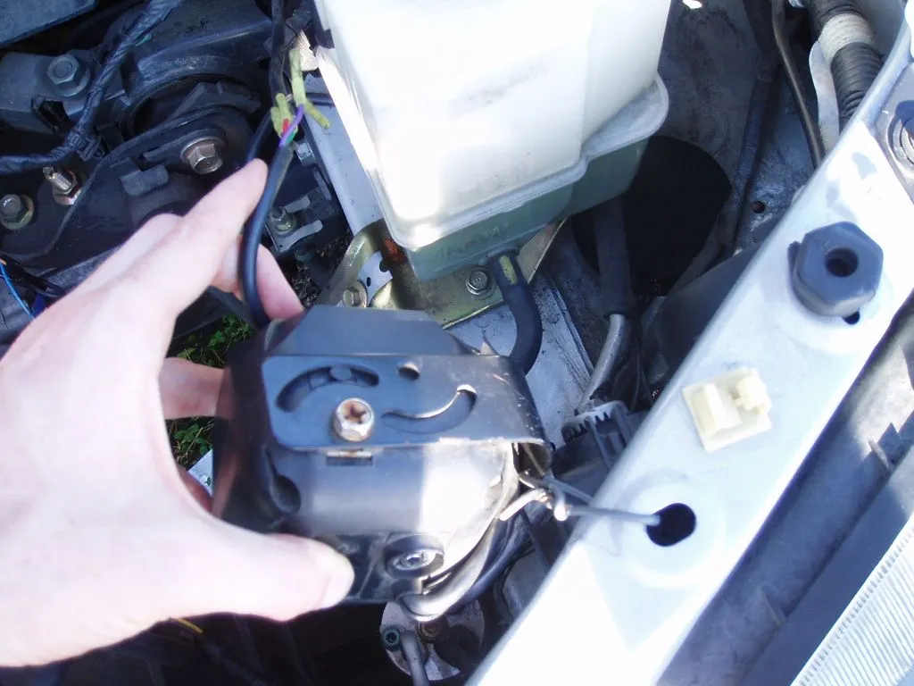

The 3rd is What i am assuming is the alarm. should I just cut the wires and remove it for now so that it isnt flopping around under the hood? I'm very tempted.
The 4th picture is the intake assembled and mounted. It seems like it should work, but the mounting system is 'questionable'. I cleaned it off today because it was basically black. This was actually the last pic I took.
The last picture is the head light 'plug'. as you can see its melted and the 3rd wire is completely disconnected. The passenger side is also melted partially, but it seems to have a slightly better contact. I figure i'll be riding with only fogs if im not careful (those work!). So I think I should probably get both headlight wiring harnesses.

It looks like there should be three wires on the low beam connectors, but there are only two. Aside from the visible heat damage, the wiring's intact.
I can't be sure, but that "alarm" looks like my backup alarm siren (has it's own power source in case the thieves disconnects the battery).
I hope you got the key to disable that.
If it's not connected then sure remove it.
Yeah. i've pretty much given up on the alarm in the picture. I think I will go ahead and cut it out, because I also didnt get the key for it.

I bought the mazda 3 wheels, with tires (13 miles on them) for 450. basically new. But I cant take off the current wheels because whoever had them put on is an utter jackhole. If I were to get a flat right now I wouldnt be able to switch the tires because the lug wrench with the car doesnt fit into the lug nut holes for the wheel. I tried a 13/16ths socket and broke 2 wrenches trying to break the lugs. So it looks like I have to take it to a wheel / tire place or somewhere to get that dealt with.
In other news, the guy that sold me the wheels was a mazda tech (i met him when I was asking about the light things) and he helped me out a little when I was there, so its possible the lighting system can be fixed relatively cheaply. The other thing is that it looks like they may have put hid's in... And that could be something to explain why the plugs melted.
The thing in the 1st picture is the mass airflow sensor evidently, and it doesnt seem too big of a deal that it is out, so i'm not going to worry about it unless somone advises me to drill a hole in the intake and put it in. Exhausted from today haha.

The first picture is the Air Temperature Sensor. It's placement is not critical. There is a rubber grommet that goes around it when it's inserted in the stock intake system. If you can get that grommet there is a hole in frame just under the coolant bottle that is the perfect size for the grommet and sensor. Just stick it in there. Get the car on an alignment machine soon. If you put on the new tires it can wear them out prematurely.

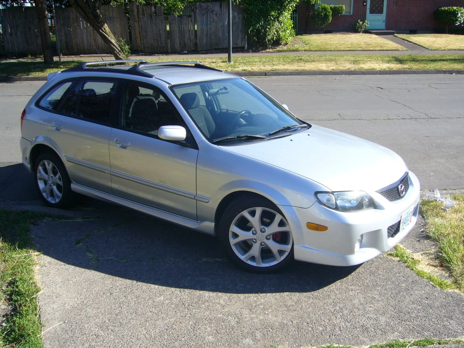

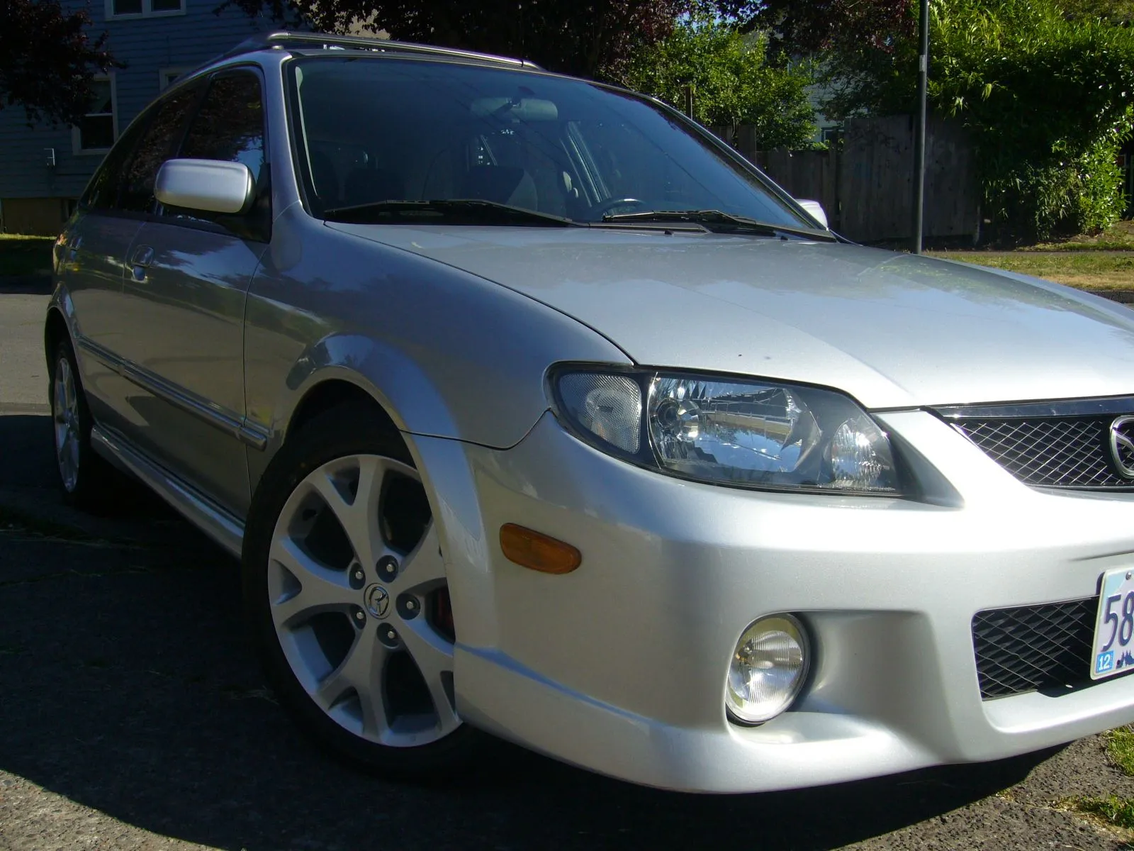

Well, i got the wheels changed this morning. And All i can say is what an incredibly drastic improvement it was. Driving to eugene (hour and a half) before left my hands numb and my arms tired (from pulling left). After the change I noticed it hardly pulls at all and just seems to follow the crown of the road. Which is really great, in addition to that the vibration is almost gone and it rides alot smoother and quieter.
So once i get it washed at least I'll post some pics. I'm extremely pleased.
Oh and the wheels look a little different. But I still think they look good. It still looks very factory, but much much much better than the crappy rounded 5 spoke no name 15 in alloys.
the ones that are on now are the 5 spokes with the prongs at the end... if that makes any sense. Anyhow the wheels and tires are bigger than what I had so it might throw off the speedo... dunno yet, the other ones I had might just have been smaller than stock (dunno what stock is, bought it with 205/50/15's to 205/45/17s)
Anyhow, very pleased at the moment.
Stock is 195/50-16, you made an excellent choice for the new tire size. :)
You got the 2007 Mazda3 rims--I haven't seen those on a P5 before. Looking forward to seeing the pics!

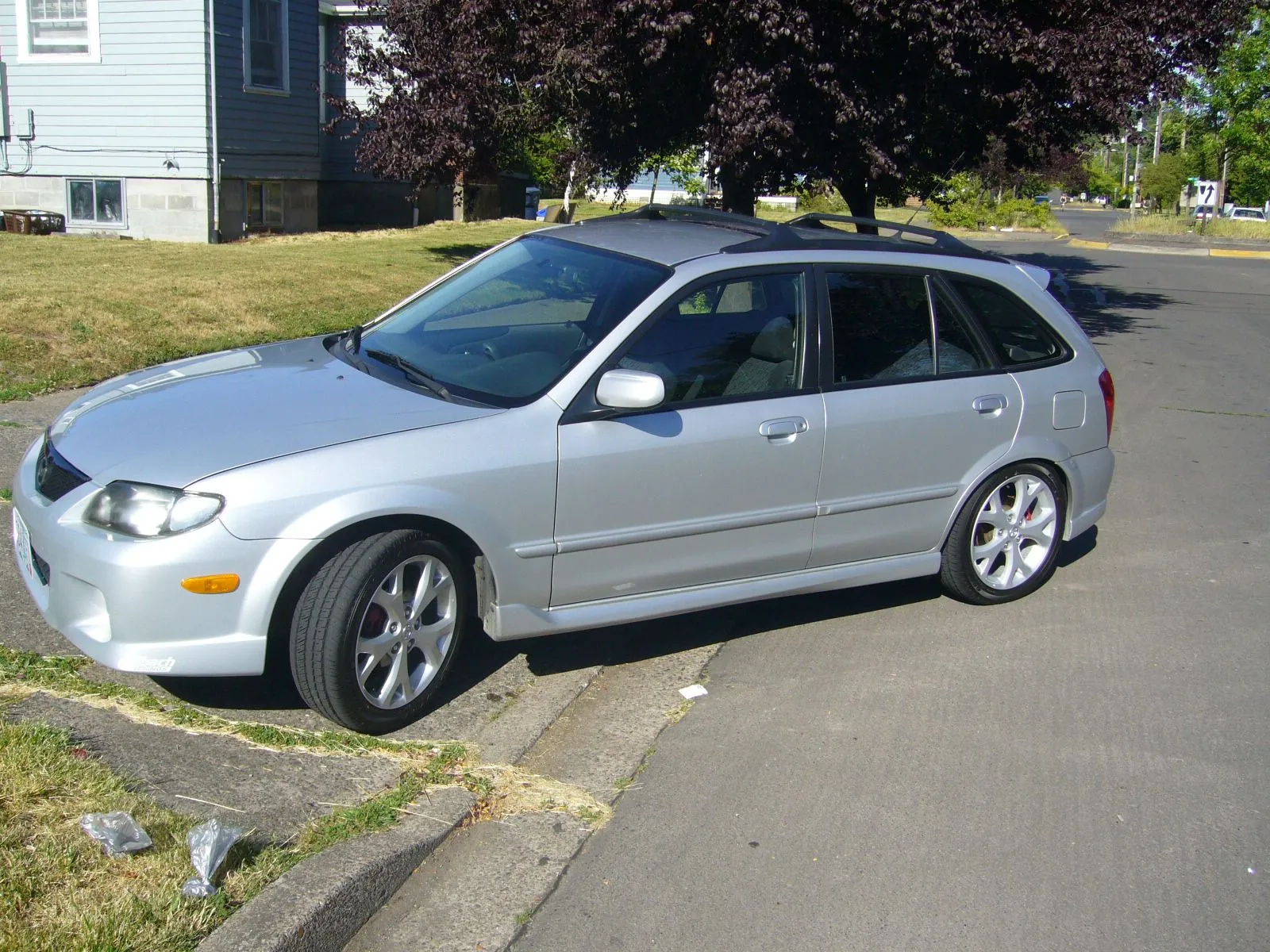

Havent been on in a while, but i finally have pics. And the tire size wasnt my choice. I got em for 450, Wheels + tires (with 13 miles on them). So it was pretty much a no brainer.
So here are pics.
