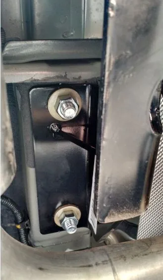

install completed, i feel the hitch is of great quality! was a 45 minute install with another person and the car backed up on ramps using a pail to hold up the exhaust once it was released from its rubber grips. Releasing the rubber grips was the worst, WD40 helped but they were still stuck on those metal rods.
http://postimg.org/image/fg9s0g9if/785269ac/
Showing the bolts that must be tightened to secure the hitch two on each side

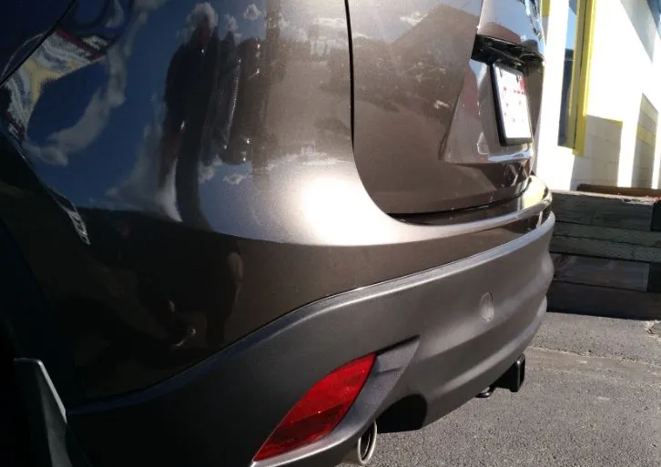

http://postimg.org/image/696q0fikb/4dd4c702/

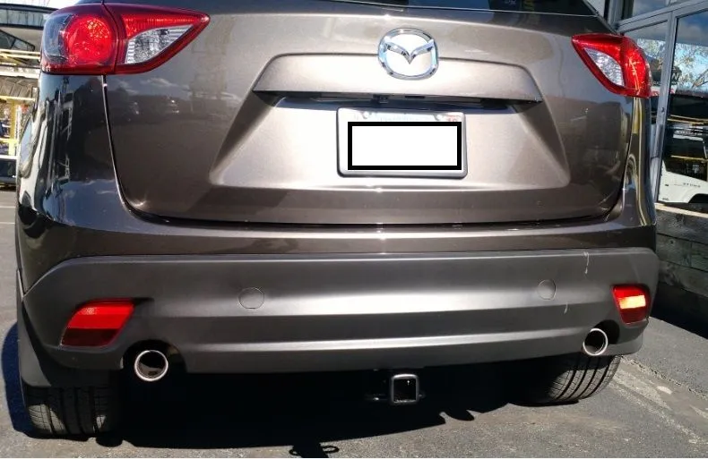

Finally a shot from the back showing how little is visible, no bar just the receiver
http://postimg.org/image/vrkllf803/52f7311e/
Looking at pic 2 it appears that the muffler pin sits very close to the hitch mounting bracket. Considering it is meant to move around hanging on the rubber holder, doesn't it bang in to the hitch (even if occasionally). I wonder if Curt uses different mounting design for that reason.
I have a Curt 1.5" on my car and had the very same issue. Under certain conditions (mainly pulling steep grade with wide open throttle) I would get a nasty metallic vibration at the rear. Took a couple of adjustments of the hitch to get the proper clearances, but I finally got it sorted.
Nope never any banging, only ever hauled twice though for moving uhaul uboxes.
That's good to hear, thanks Chris. On my old car the muffler was banning in the U-Haul installed 1 1/4 hitch all the time; when I saw the clearance on the second picture the long suppressed memories resurfaced:). Is it the angle the picture was taken from; maybe is just an optical illusion and there is plenty of space up there for all I know. I would really prefer the Hidden Hitch 2'' over the Curt one mostly because of the more discreet fit (although the lower price doesn't hurt either).
