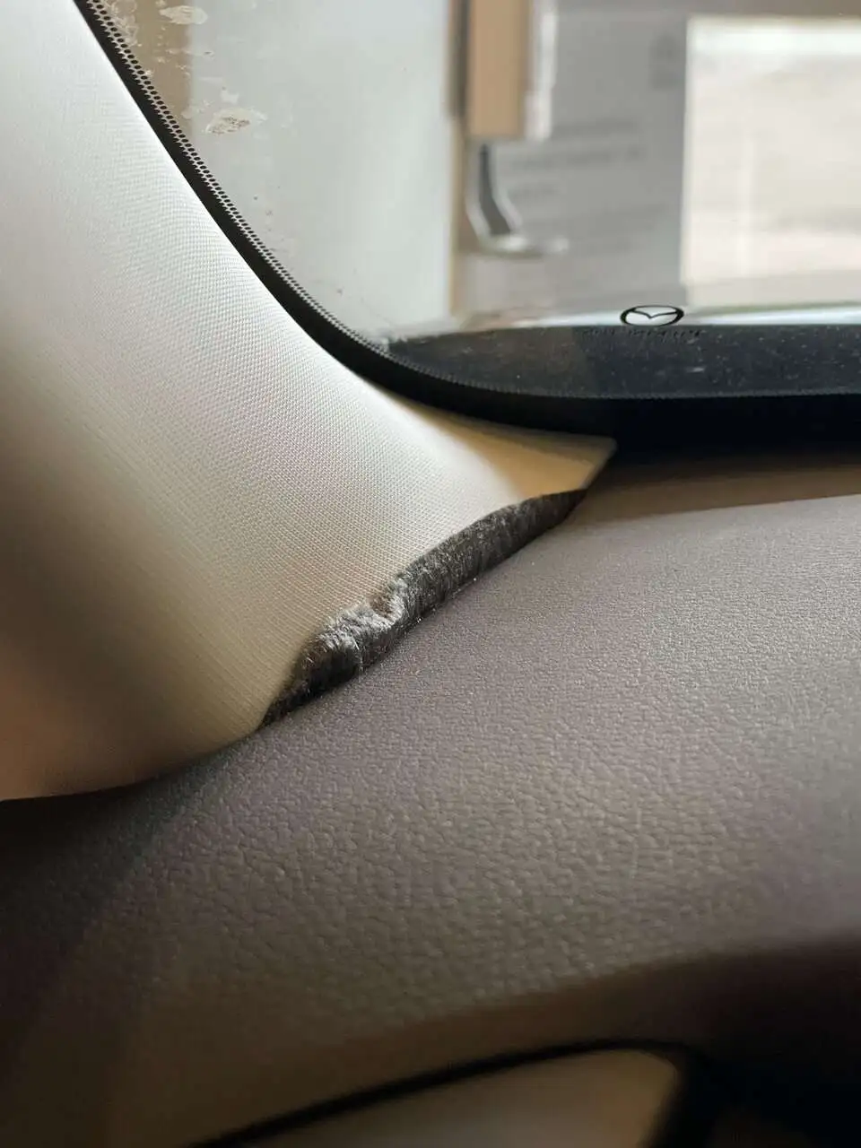

Hello! Picked up my first Mazda, a CX-50 preferred Plus a few weeks ago. Loving the car so far but I have a few issues and questions.

2. Major trim gap between the A-Pilar and the dash. Seems to be a known issue, just need to bring it back to the dealer to fix.

I did notice something amiss with the A pillar and the dash on both sides. The fabric or liner was coming out between the two. Like a brown color lining. Had to cut one off and the right side I am just leaving it out so far.

I've seen a couple of reports similar to this. Seems like it's the vibration padding strip coming out. Can you not just push it back down into the gap?
Have not tried to push it down, keep forgetting to bring down a tool to do so.
I noticed this possible issue on the model in the showroom awhile back. I was a bit surprised it was permitted to be in this condition on the floor.

That photo is nasty and should have never left the factory like that. As far as the transmission issue I've havent noticed that on my 50 turbo but I can slightly feel that istop turn those cylinders on and off. Best thing to do is try to find the same model and drive it to see if you actually have a problem or not. Dealer should let you do that.
I checked my car today and sure enough I have the same issue as in the photo. Jeez how many left the factory this way? Doing first oil change next month will have dealer address it. Thanks for the heads up . Probably would have not noticed if you did not mention it on this forum.

Trim gap was fixed, the original A pillar trim wasn’t installed properly. Tech reinstalled with no issues. Looks great now and no looseness or rattles so far.
