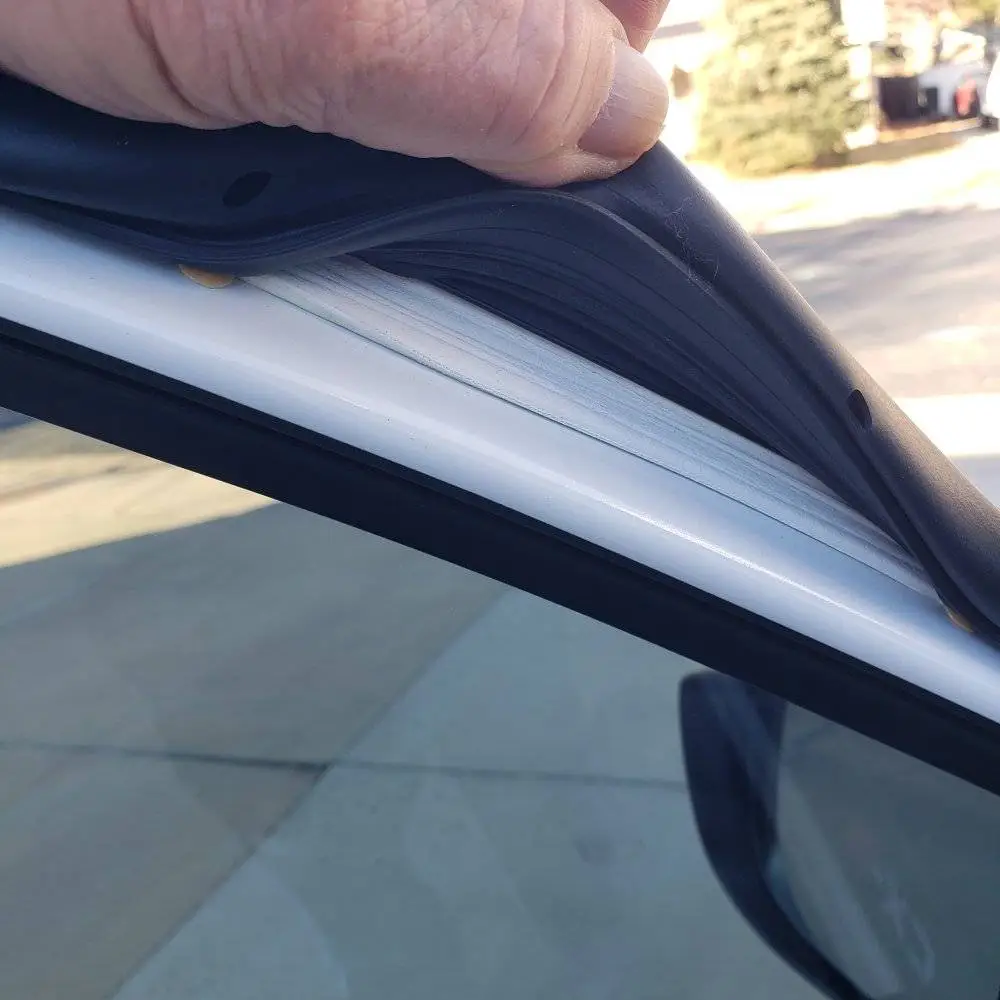

I had the exact same noise and it only happened a few times, high wind going around 70 mph, thought maybe a door wasn't fully shut, couldn't really repeat it but had to be coming around the door. Took a leaf blower and put it close to the door around the areas mentioned in the above post referring to https://static.nhtsa.gov/odi/tsbs/2021/MC-10201775-0001.pdf and noticed a distinct difference in the pitch of the sound (probably should of had someone else do it while I was inside). I grabbed some door window insulation roll at Home Depot which had the sticky tape on one side and stuck it under the door insulation in the areas stated in the above .pdf (just slightly going around the fasteners) that seemed to push the factory seal up for a tighter fit. So far I haven't heard it again but only had a couple times that I was in the high wind areas. I have a lot of the insulation roll left in case I need to adjust it more.
Edit: The noise that I had was like the one in this link it was loud.
