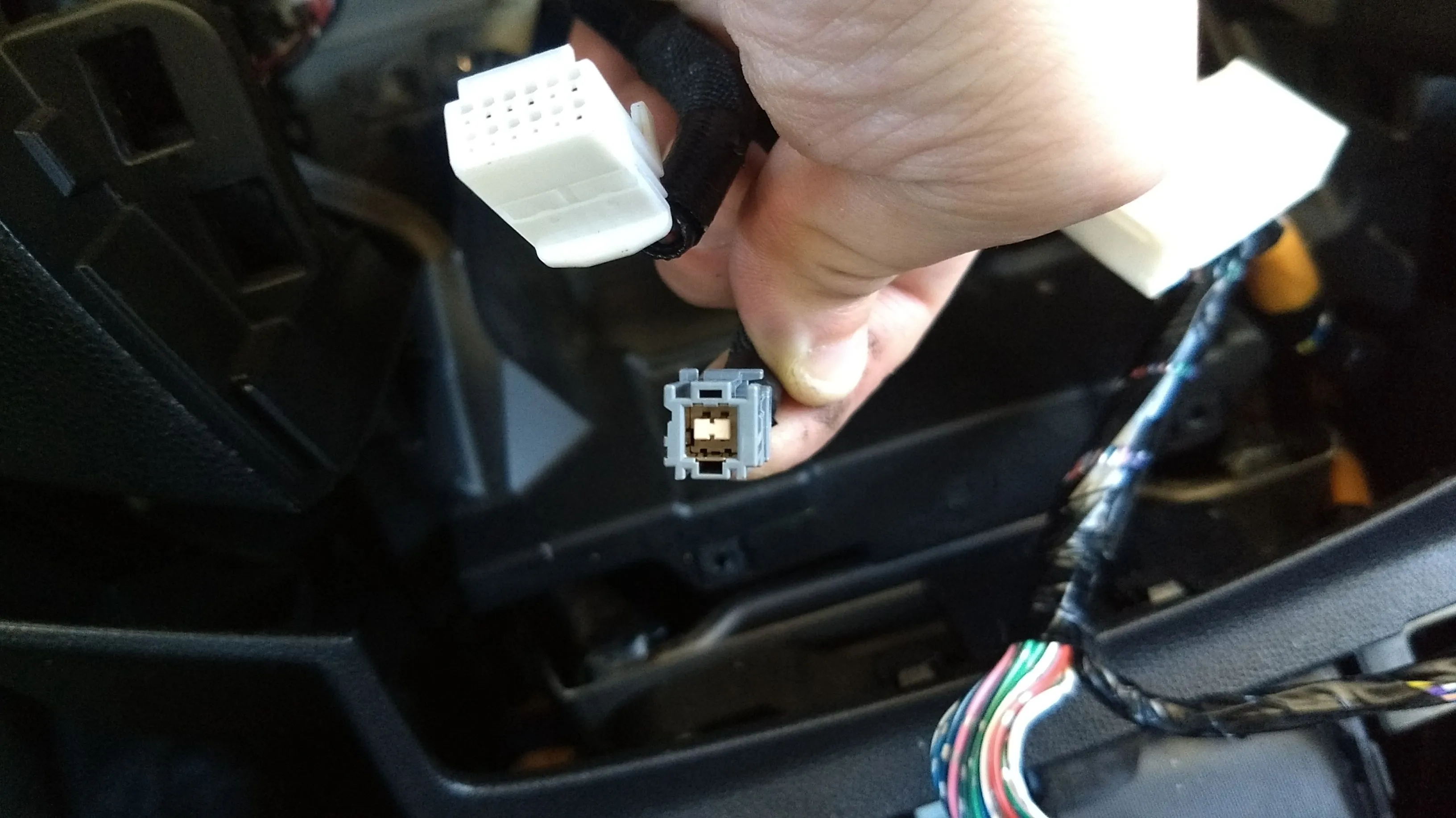

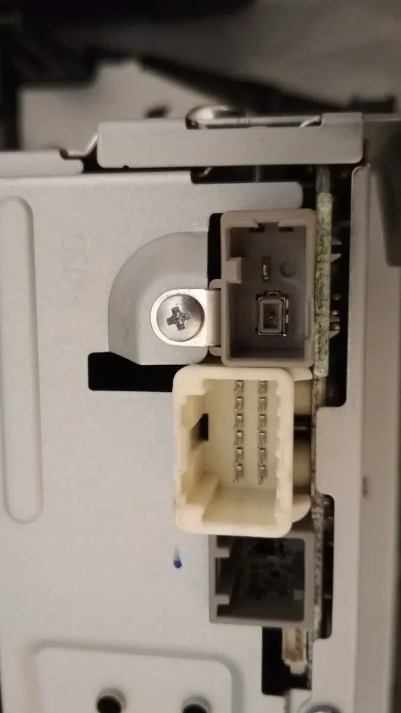

Can you please help me identify the connectors of my stock stereo? Mazda 5 2014 touring with XM Sirius, I'm a bit confused. I assume, the square 4 pin connector is the Sirius antenna? What is the name of this connector? And the 12-pin connector next to it - I assume it's the AUX+USB, is this correct?
The dark colored top socket in the first photo is for the powered antenna. The pin inside that small rectangle is for receiving the antenna pin, and the pin next to the square is for the blue wire (12v). Metra has an adapter for it (40-HD10). It's not proprietary adapter. Metra's adapter comes with a label saying it fits Honda 2005 and up. I don't think there is a name for this harness. It just says "Vehicle antenna adapter cable".
I believe you are correct about the aux+USB harness being the 12-pin harness which is likely proprietary. The android radio comes with its own USB cable and a separate aux-in cable (part of the AV input/output harness). it's going to be fun finding that adapter that can connect the stock aux+usb harness and the radio. My goal is not to damage the stock equipment but if it is the only way I will have to cut it off or just leave those ports defunct.

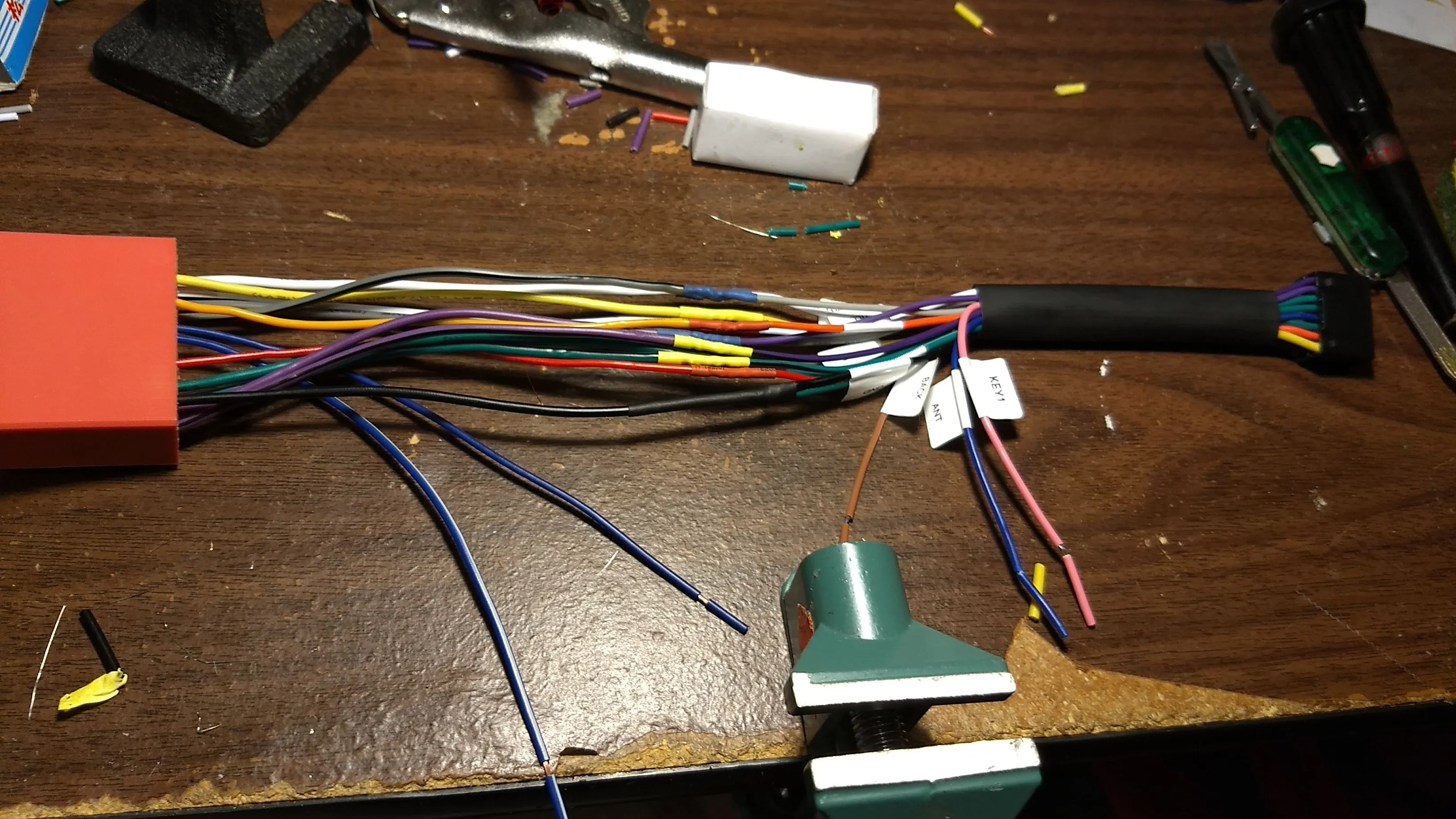

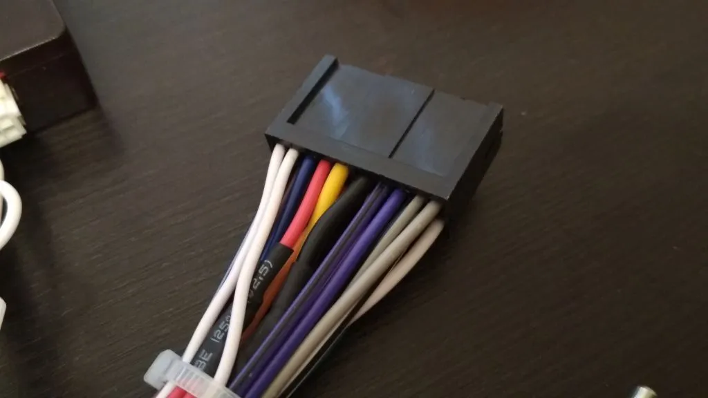

Today I received the head unit (android 7918) in the mail and start connecting the wires. Here is what I have so far:
The orange harness on the left will be connected to the console wiring. The black harness on the right will connect to the head unit.
One question: Should the blue wire from the orange harness connect to the blue wire of the black harness that goes into the radio? Do I also connect the blue wire from the antenna adapter (not shown in the photo) to it? I am a bit confused on which blue wire needs power and which provides power.
I will remove the stock unit and check the console wiring tomorrow. It would be strange that the console wiring has two blue wire (from the harness and from the stock antenna adapter). It makes more sense to me that the blue wire from the console wiring provides power, and the blue wire from the stock antenna adapter requires power to boost the antenna signal. But if that is the case, then I should connect the blue wire from the orange harness to the blue wire of the antenna adapter and totally bypass the radio (leave the blue wire from the black harness hanging).
The blue wire from the stereo connects to the antenna adapter's blue wire - that's for sure.
The stereo, when on, will provide 12v on that wire.

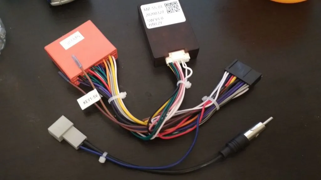

I'm attaching a picture of my harness, note the canbus adapter. Since canbus adapter is used, there's no need to hook up key1 or key2 to anywhere to make the steering wheel buttons work - they will be activated via canbus. Same will apply for the rearview camera - it will be activated by canbus signal, not by 12v on "back" wire.

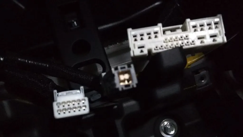

What do you think about the third connector from the top on the first photo?
Is it Sirius antenna or USB connector? Now that I've found this: https://www.amazon.com (commissions earned) I'm in doubt.
Still no idea but I did the install today and took this photo showing that connector:
This USB adapter looks to be the same:

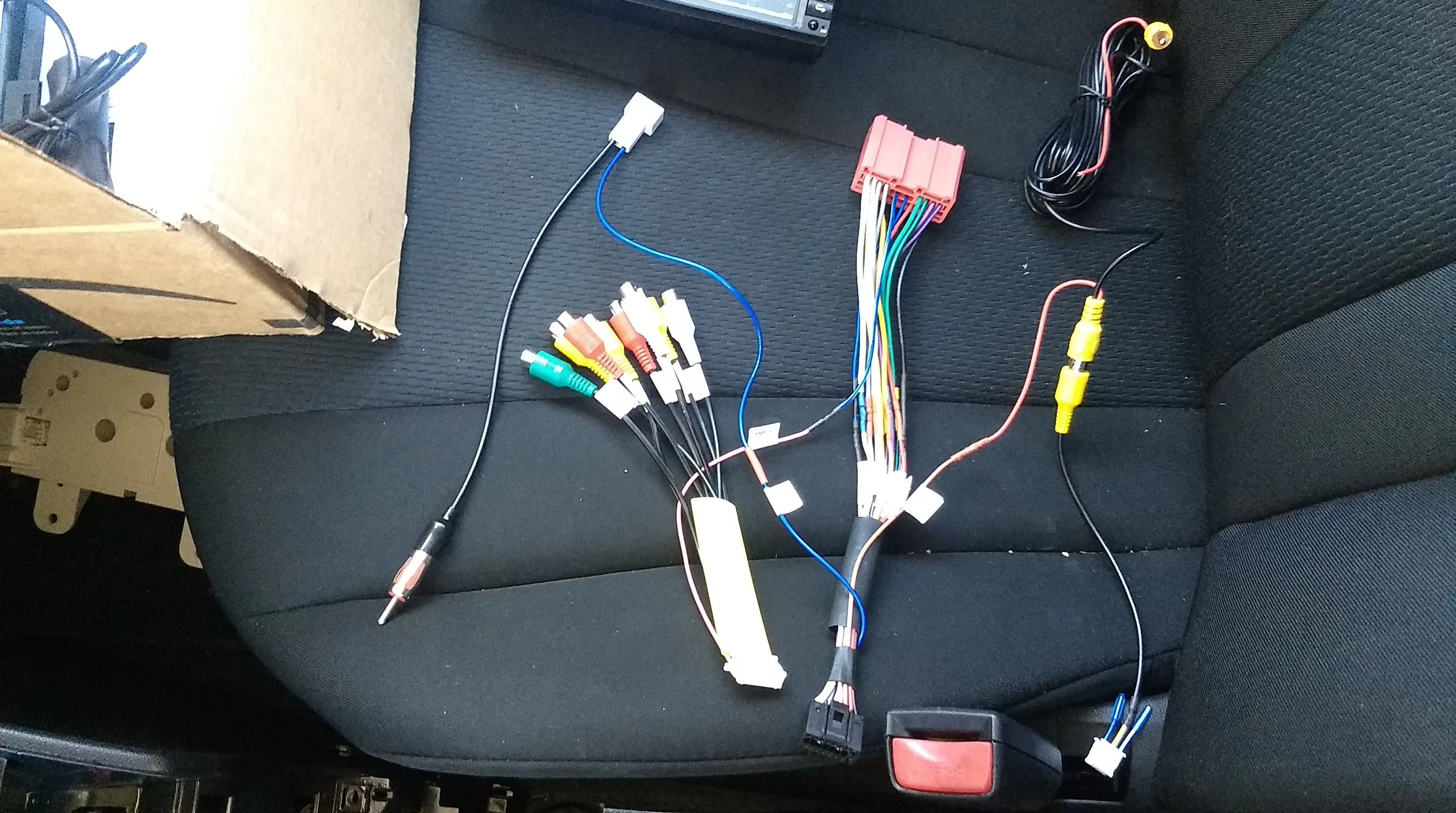

Here is my wiring (top from left to right: antenna adapter, stock wiring harness, rear view camera; bottom left to right: antenna on the radio, AV input/output on the radio, ISO connector on the radio, and rear view camera on the radio).

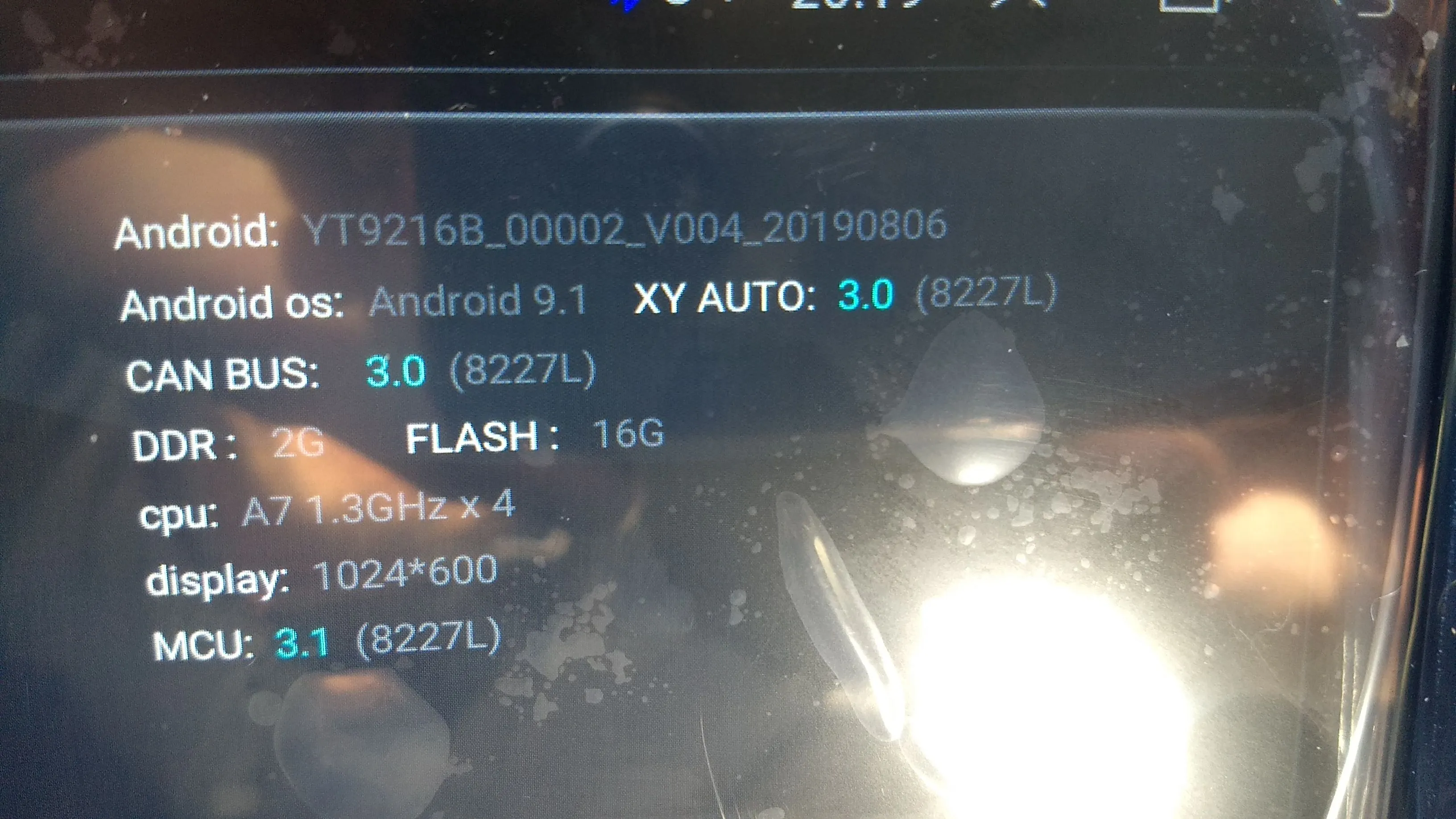

The radio works better than I expected: Radio, GPS, Bluetooth (phone and music streaming), local file player, wifi, google play store all worked. The only thing that is not working is my steering wheel control - I was hoping connecting the KEY2 wire (from radio) to ground and KEY1 from radio to SW1 on stocking wiring will do the trick like in other discussion thread indicated but the steering wheel setting did not take it. Have to wait my second Metra harness arrive to move the pin/wire over and try again.
Here is the system info of my unit:

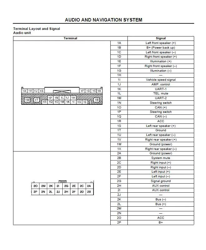

In other words, don't connect KEY2 to GND. Try KEY1 to 1N (steering switch). KEY2 is usually not used or used for a separate set of buttons, i.e., cluster buttons on some cars. Maybe, in this case, KEY2 should be connected to 1P (steering switch).
What about the CAN bus adapter? As I understand, it's required to provide information output to the clock dashboard. Did you try connect CAN_L and CAN_H to 1K (UART-1) and 1M (UART-2)? And more importantly, did it work?

Update: steering wheel control works beautifully now. Here is the mistake I made and how it was corrected:
Mazda 24pin pinout diagram ( I can't find the mazda 5 one for 2nd gen. so had to assume all Mazda 24pin harness share the same pinouts)
There are wires from the console 1N and 1P for steering wheel control. My wiring started to work after I connect 1P to the ground wire and 1N to KEY1 of the android stereo. KEY2 wire from the radio is left unconnected.
What did not work before (I lack of logical thinking lol) was I connected the KEY2 wire from the radio to the ground thinking the radio will need it in order to detect the resistance from KEY1 and left the 1P (from console) unconnected, which is wrong.
