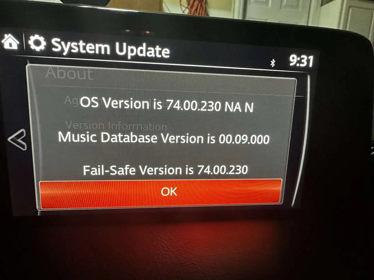

Older thread, but just had this happen on my 2019 touring. Started car in garage, froze on icon screen, drive a few miles, turn off car and restart. Screen still frozen. Phone is connected via cable and Apple Music through my phone is playing on the car speakers, but no Siri. Try to reboot by pressing back, nav and mute buttons, still frozen. A few mins later screen goes black, Mazda logo comes on with spinning wheel and then everything comes back. Only thing I can think of is it started to do an update and froze, then once done it restarted. System screen only gives a version, not a date so can’t tell if it’s a new update.

if you have never updated it, go do it. There was an update that dealed with that issue if I recall. That year CX5 doesnt auto update on its own, no over the air updates.
Latest version is v74..xyz, anything v70..xyz.. and v54..xyz... is too old.
You can ask the dealer under the cpo or try on your own.

I’m running v74.
is it 74.00..311? Thats latest if I recall. If not - update.
if it is 74..311 then could be one of the following:
sd card if you have one
infotainment was getting low on space
bad circuit on the motherboard or mmc. The old gen6 use old school mmc cards.
new bug

This is what I have. Do dealers update for free or do I have to pay some diagnostic fee when I tell them screen froze?
