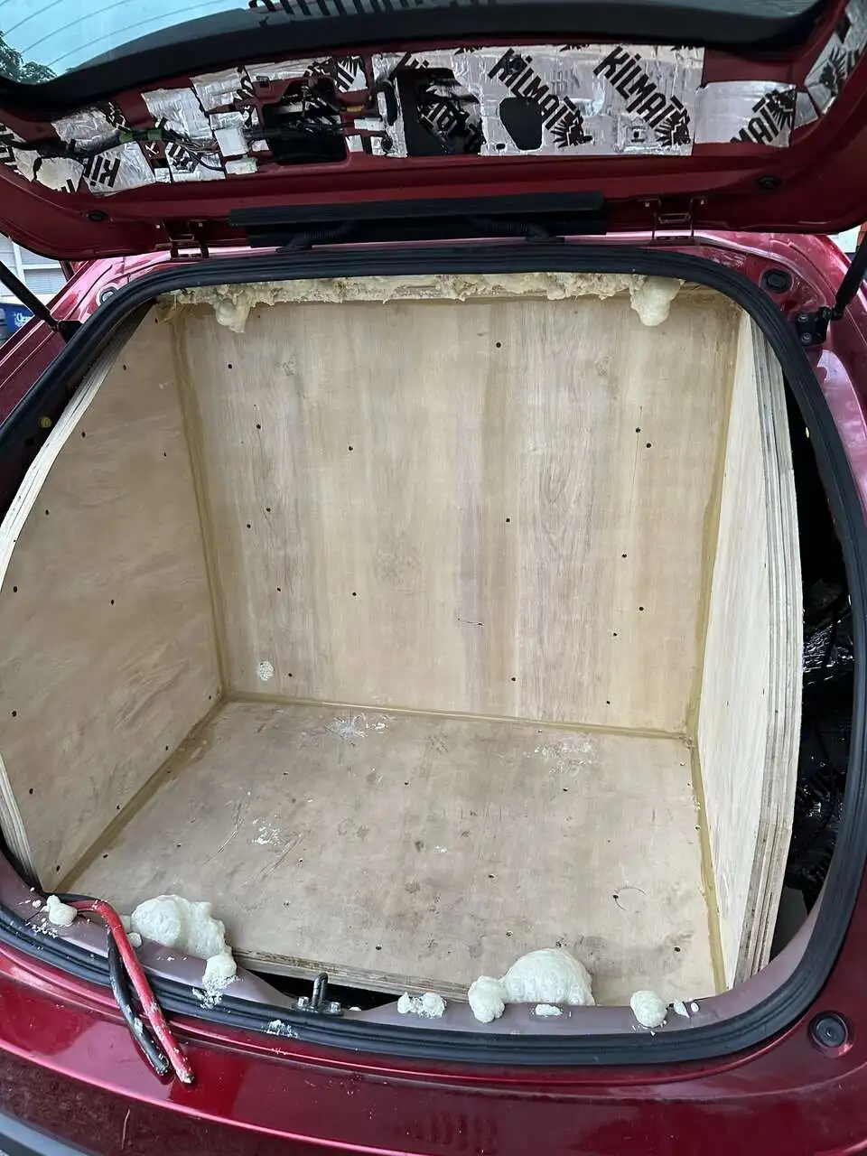

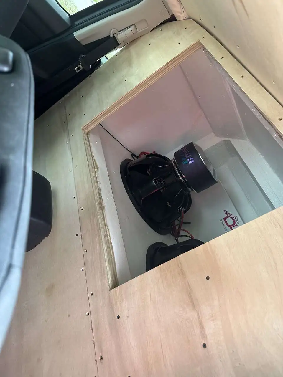

I know this isn’t everyone’s cup of tea, but a few of you followed me in early stages of adding bass so I figured I’d share some photos of my build. I still have more work to do (proper door panels, and adding the other 20 tweeters and 6 more mids, probably moving up to a JP83 and a jp10.4 to replace the jp13.2ab as I feel like I’d benefit from a bit more power, waiting on new alternator to come in still, ). Car is doing 155db+ from 23-29hz, and 157db+ in the mid to high 30s. Total rated wattage across everything is around 13k watts, but if you know these amps they can easily do double that.
2018 CX5 Sport
Dayton 408 DSP, stock stereo bypassed with iPad.
2 18” Sundown Zv6 in a B Pillar 6th order, tuned 25hz rear and 50hz front. Built to smash 20s and get windy.
12 Deaf Bonce Arnold Neo 6.5s
18 Sundown GT-R1 tweeters
4 Sundown BT-R1 tweeters
2 Sundown ET-R1 tweeters
4 Rogue RN-1 horns
4 JP34ab amps for the highs
1 JP13.2ab for the mids
1 JP63 @ .5 ohm for the subs
320ah of headway 38120 lithium cells (stock battery not being used)
About 200lbs of sound deadener
Brand X 250a alternator en route
