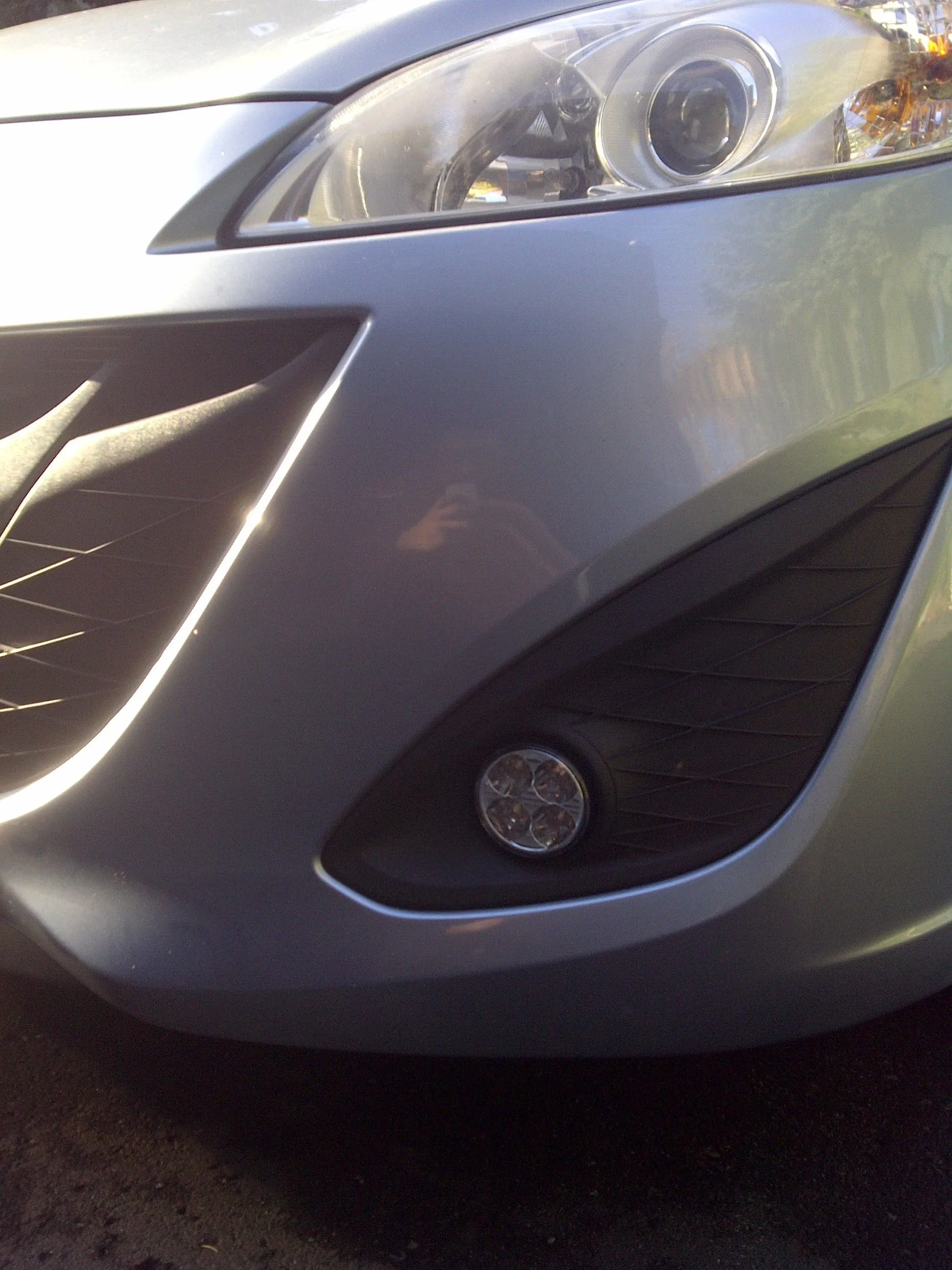

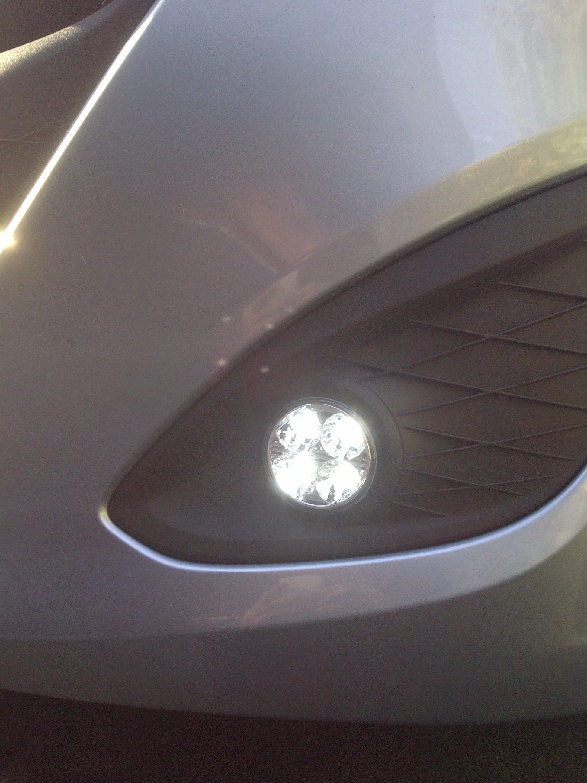

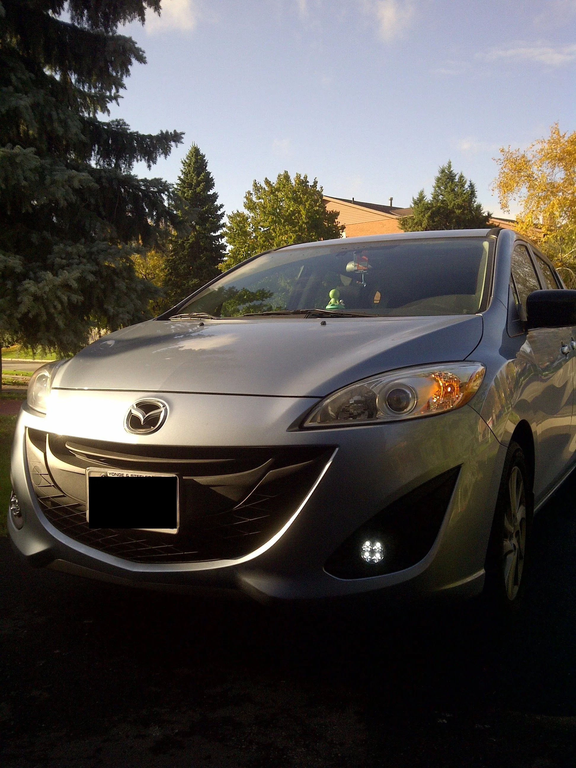

When I got my GS, I knew I had to do something about the (lack of) foglights. I didn't really want foglights, but the plastic covers where the foglights should be were really bugging me. You know, it just reminds you that there should be something there but instead you have plastic.
Anyway, so I didn't want to spend hundreds on this, and I ended up getting a pair of $10 LED foglights from eBay. Just installed them, and I have to say, I couldn't be more pleased! I mounted them using the original plastic covers, cutting holes in them just big enough to slip in the LED lights. It's a perfect fit, almost factory look.
Obviously these are completely useless to actually help you see, but does really well for esthetics.

No problem! They seem to range in price from $10-20 on eBay. The other model that is the right size (~70mm diameter is what you need) is the one with 9 LED's.

Here's the ones I got: http://www.ebay.ca/itm/2x-4-LED-Round-DRL-Daytime-Running-Driving-Auto-Car-Fog-Light-Lamps-Bulb-12V-4W?item=130742189222&cmd=ViewItem&_trksid=p5197.m7&_trkparms=algo%3DLVI%26itu%3DUCI%26otn%3D3%26po%3DLVI%26ps%3D63%26clkid%3D3393771629051569628
For instructions, in your owner's manual, it shows you how to change the OEM fog light bulbs. Just follow to get access to the area, the plastic cover for the fog light is held onto the bumper with three screws. Once you get the plastic cover off, you can modify it to mount the fog light. For wiring, I just hooked into one of the sidemarkers so that it comes on with them.
