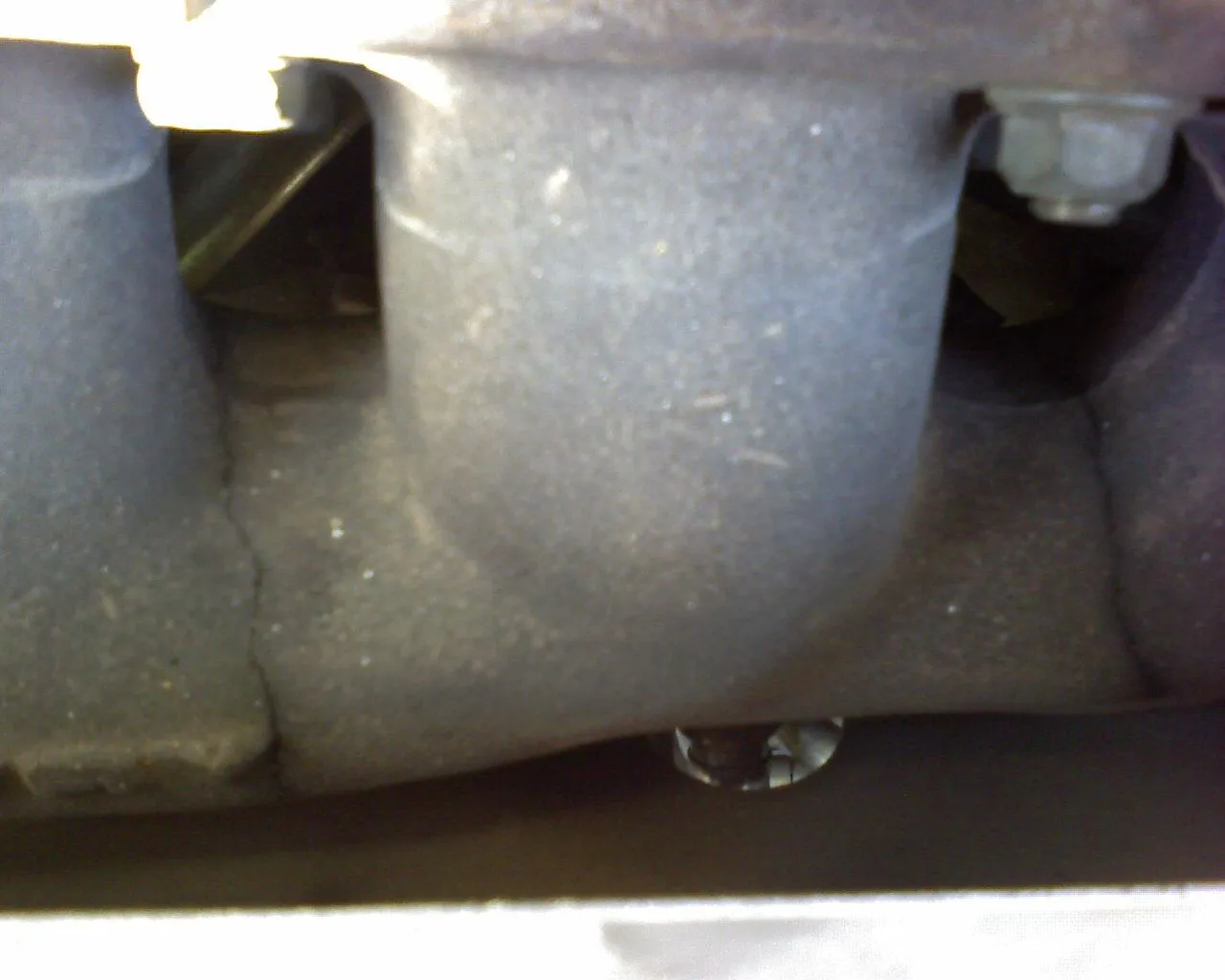

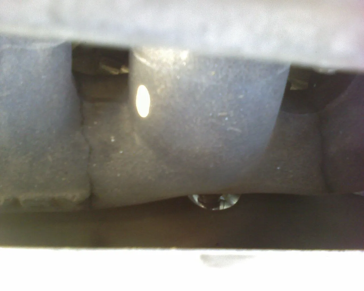

noticed the exhaust mani was cracked in two spots, could this be a huge cause in my noise?
My manifold is cracked all over the place. I am yet to see any indication that exhaust gases are leaking through. I have cracks like those but I don't think they are leaking exhaust gases due to the lack of carbon deposits on outer surface/ no discoloration of heatshield. I think all msp manifolds are going to crack. Hell....the liberty bell cracked too and it still works
