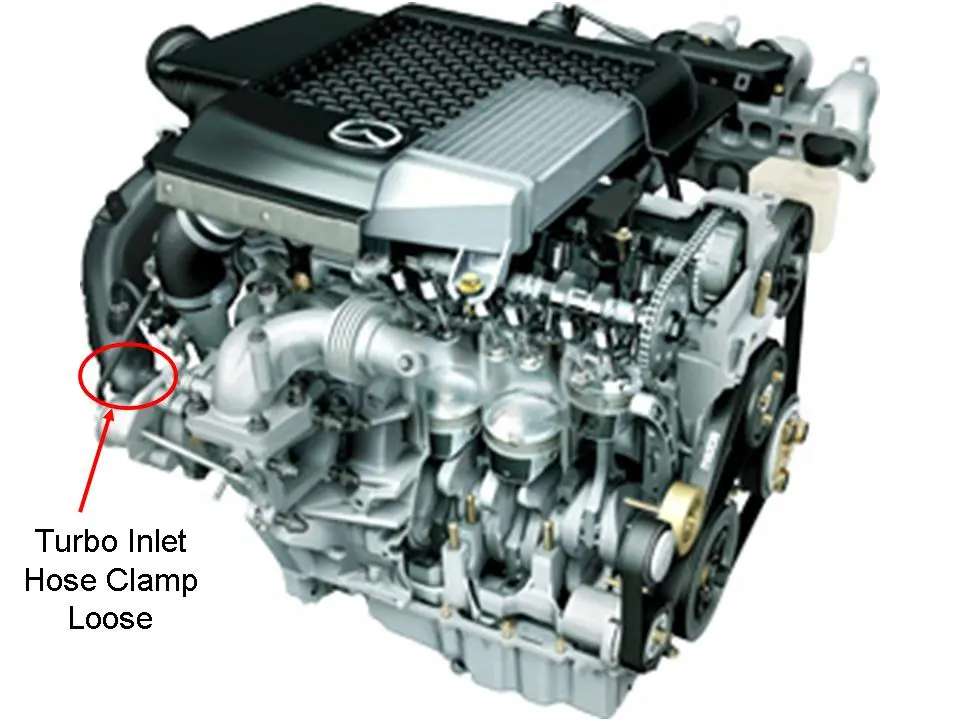

2. The last hose clamp in the intake system, on the tubo inlet (attached directly to the turbo) was loose. I could move the hose on and off the turbo inlet by simply moving my CAI from the polished tube (the one with the Blue MAZDASPEED lettering). This could allow debris into the engine over time causing premature wear. After many attempts to tighten the hose, I realized that there is no way to tighten it enough without damaging the hose under the clamp. The dramatic engine movement under acceleration and mechanical advantage of the long intake is just to great to keep this connection from breaching. ( will include pictures on a later post) I included a generic engine picture with this point circled.
During a routine check of my engine, I found 2 issues.

Good find! I'm gonna check mine and carry this discussion to the other forums if I find the same thing happening. The illustration is very helpful to seeing where to check, thanks.
